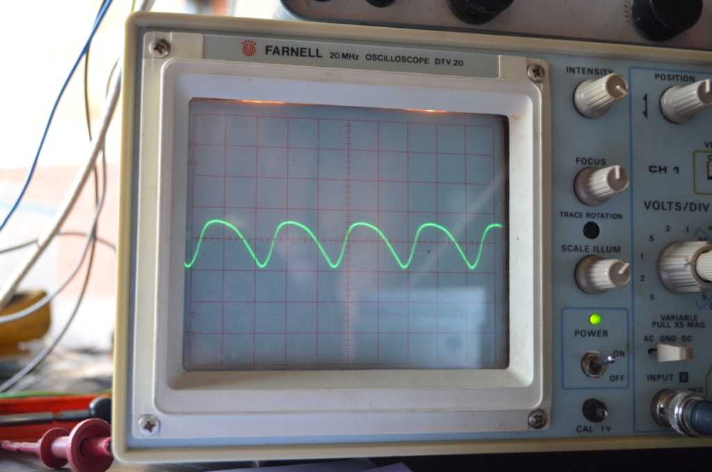

Well, now I've had time to look over the schematics this should be fairly easy.
The +6.8V is only used by the op-amp so it can only be either:-
1. Wrong value R41
2. Defective IC1
3. Defective D12
4. Poor joint or track shorted somewhere.
Shouldn't take too long to find.
OK, home from work.
The recommended upgrade for the Quad is the pricey OPA627AP, which I bought.
With the OPA627 in the board the +6.8V is down to a mere 2.6V, I can't see any oscillations and the +/- inputs are as close to 0V as I can measure but the output is over 1V, probably limited by the low V+.
Now, I've swapped in the cheaper OPA604AP and everything is as it should be, I haven't tried a signal through it yet, that will be the next step.
The other channel is working fine with the OPA627 ???
I don't know if it helps, but this is the output oscillation.
Scope is set to 1uS/div and 1V/div.
This is with no input and a crappy 8 Ohm speaker on the output.

The unmarked cap (if it is a cap) would tend to reduce any tendency toward oscillation. Probably try something like 10pf as a start.
The opamp only provides DC bias for the input stage and isn't in the audio route, I would just use a TL071 or OPA134, nothing more exotic.
