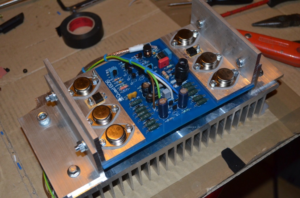

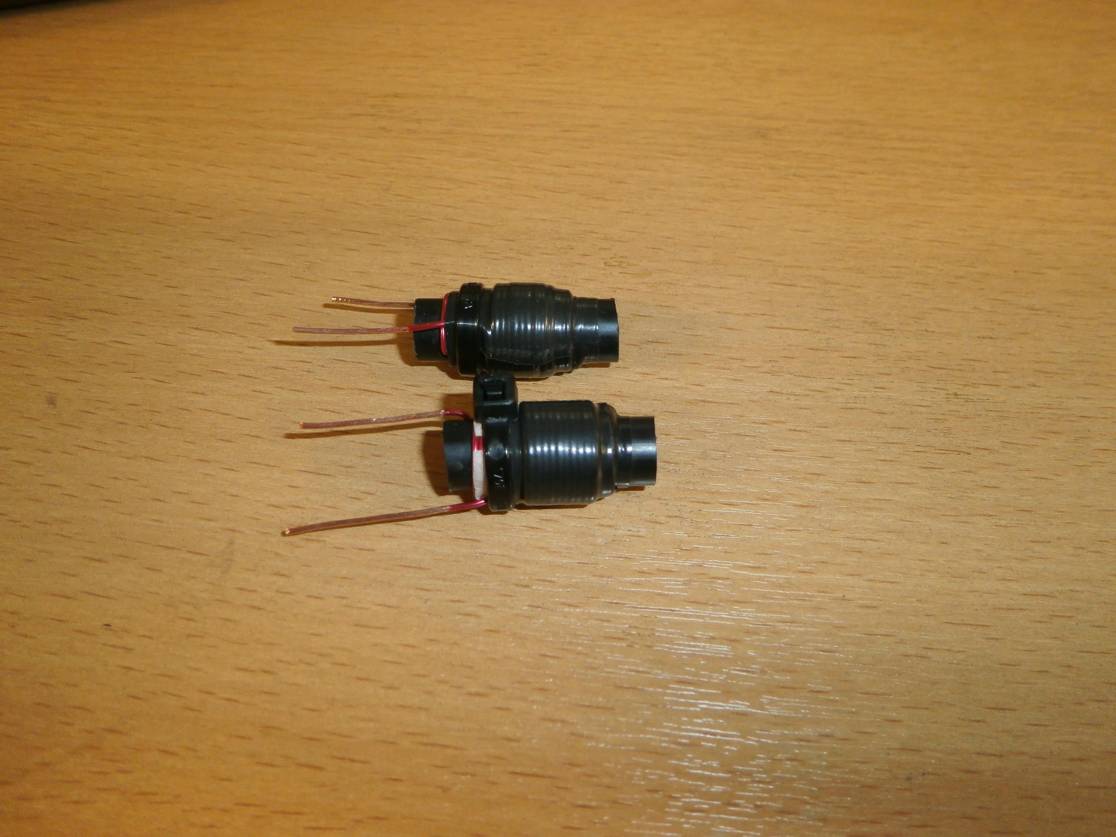

Let's see if these can be made to fit, they have been constructed with 1.0mm wire.
They do fit, if a bit clumsy.
As the title says, the air cored dual layer 4.0uH L2/L3 combo does fit.
It's not as cosmetically pretty as the original.
Why does the Rolls Royce upgrade not replace the original ferrite cored inductors with an air cored one?
The issue for cloners and their "upgrade" suppliers, is fitting 2 air-wound coils in the space for the original ferrite cored parts and you already know they just won't fit the same way. The fact that you can do it as a single coil this way or lying flat isn't original but, when the lid is on, no one but you gives a toss other than those who want to see pics and comment, if that's your pleasure.
In an earlier post by Viva Vee, it was mentioned that a carbonyl bonded iron ferrite would have been used in the Quad inductors. It came in several medium frequency grades but rare now in round rod form. Most use is in broad band power transformers and chokes :De conclusie die u trekt o Availability will affect the coil size and I guess it is difficult to match the old rod cores with modern stock shapes. Goodness knows what material is really used now.😕

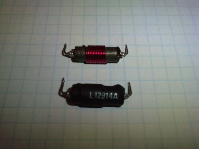

hi.
the L1/L2 coil´s on the picture is from my original 606, i have measured them with a agilent 4263b lcr meter.
100hz 1volt= L= 2,48 uh R= 4,85mohm Q= -0,3
1khz 1volt= L=2,24 uh R= 30,2mohm Q= -2,1
10khz 1volt= L=2,07 uh R= 1,28 ohm Q= -9,9
100khz 1volt= L=2,1 uh R= 159 ohm Q= +114,2
wire is 0,54 mm
core is 15,5 mm long and Ø 5,3 mm
and there are 11 vindings.
the other picture is my clone of the 606/909 and i use ferrite cores from pc supplys, they measure 21mm long and are Ø 6mm with 1mm wire and 7 vindings works perfect.
sorry for little glumsy pictures but my camera ain`t better.

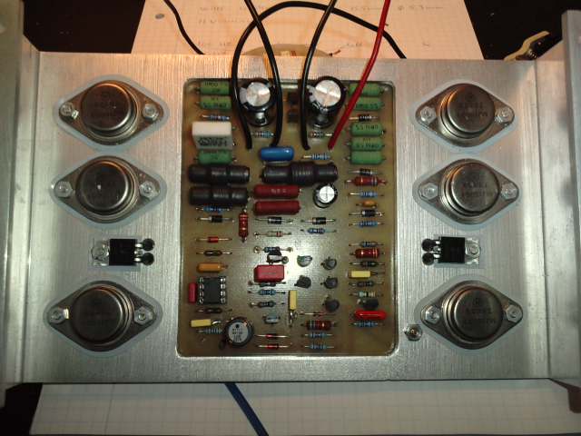

Well the second channel is now under test, with its improvements.
1. It's got the 1.0mm 4.0uH inductor on it.
2. It's got those thinner brown insulators on the BD244s.
It did crackle a bit when I first powered it up but that is probably down to the multitude of temporary connections to it under test.
It seems OK now but it's only running at a fraction of a watt.

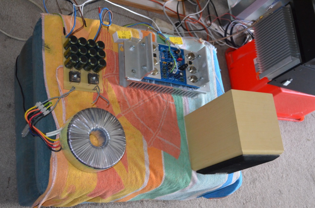

Choices - choices - choices.
Now I've got to shoehorn this baby into a chassis.
I've got 2 x 800VA 40-0-40V and 2 x 250VA 35-0-35V transformers.
Obviously the 2 x 800VA are better sonically but the 2 x 250VA fit far better.
In order to fit the 2 x 800VA I'm going have to pancake them together, whereas the 2 x 250VA fit nicely mounted vertically.
