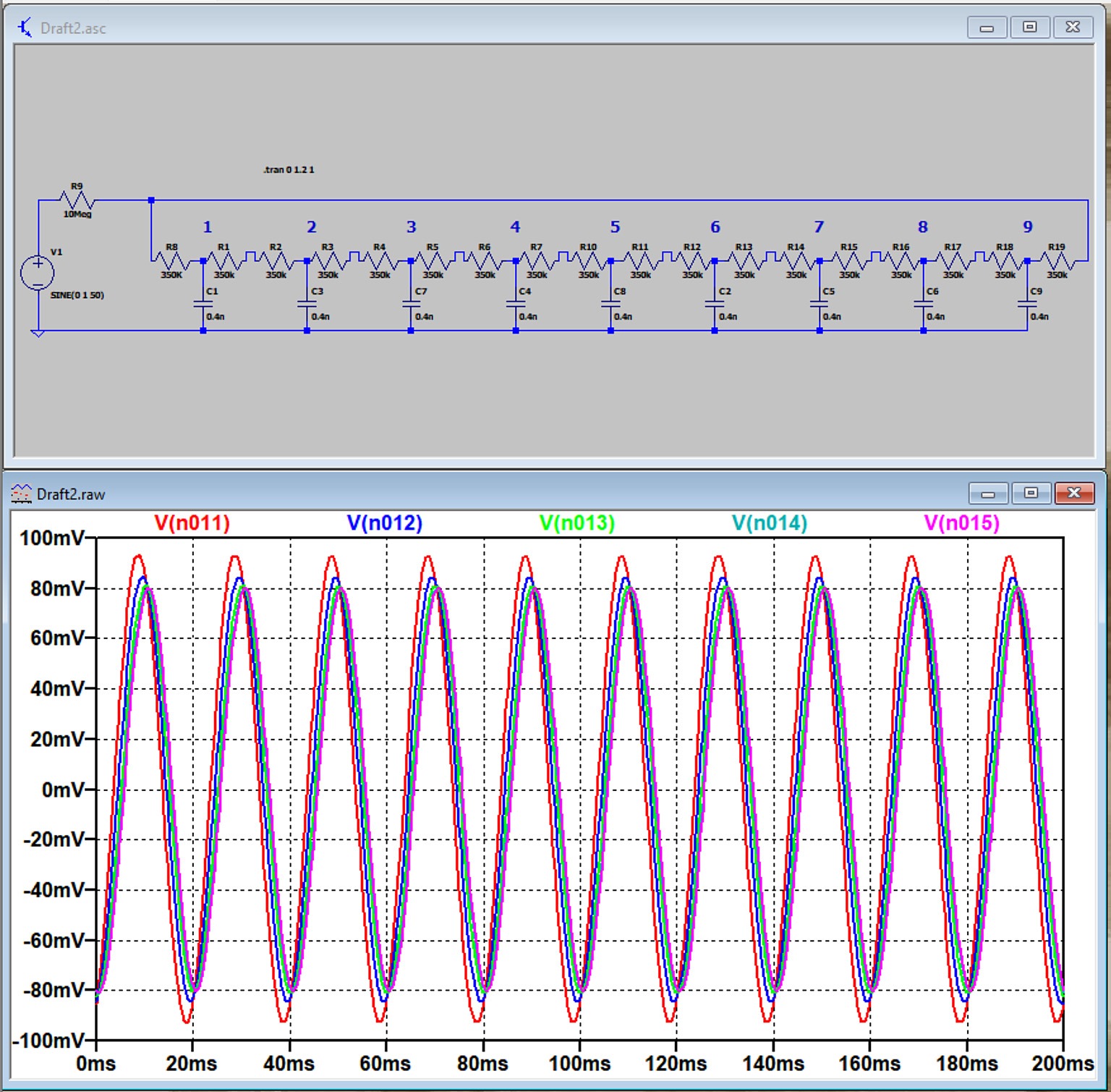

Looking at the measurements that Wout32 made from both sides of one panel, with results between 17 and 32Meg, let's assume 25Meg as an average.
Now dividing a panel in 9 strips of equal width, parallel to the long sides, we will have 9 strips having 2.8Meg per strip.
Because the ESL63 has 4 panels, when paralleling those panels on top of each other, we can substitute the four panels by one panel with 0.7Meg per strip.
Each strip sees only one nineth of the total capacity of ca 3.6nF, so 0.4nF per strip.
Now we can put this in a model and see what voltages are there on the various strips with a 50Hz @ 2Volt peak to peak, which is the case for the Bias generator having 10nF caps.
I have taken two 350K resistors (together the 700K that we just calculated) with a 0.4nF cap in the middle to simulate one strip
This is a coarse model that can easily be refined to more strips, but IMO it gives a very nice idea what voltage lands on the Diaphragm at the various spots.
So from the 50Hz @ 2Volt peak to peak or 0.7Vrms, the simulation shows between 57mVrms in the middle to 66mVrms at the edge, a remarkably low spread.
That is very close to the 100mVrms where you calculated a 77dB SPL and that seems IMO way off.
Looking forward to be commented on this approach.

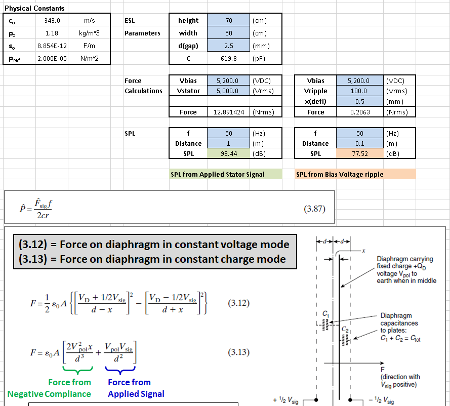

But what I find very hard to understand is that at max drive of 50Hz @ 5000Vrms on the stators, the ESL will produce only 20dB SPL more as with 100mVrms on the diaphragm, at least that's what I understand from your sheet.
So it's a pity that the used formulas are not left in the various cells that only show their outcome.
A couple things to note when looking at the results:
1) The SPL for the 5000Vrms on the stators is at 1m.
2) The ripple on the HV supply is 100Vrms not 100mVrms.
I chose this level since I have seen it on some humming Acoustat speakers I have worked on.
3) The SPL for the 100Vrms on the HV supply is at 10cm, not 1m.
I don't have the spreadsheet with me, but can send it to later in the weekend if you would like. All of the formulas used are provided in the posted image.
Remember when calculating the Force from the negative compliance, you don't use the ripple voltage directly.
Rather you use the difference between the calculated forces for (Vbias + Vripple/2) and (Vbias - Vripple/2)

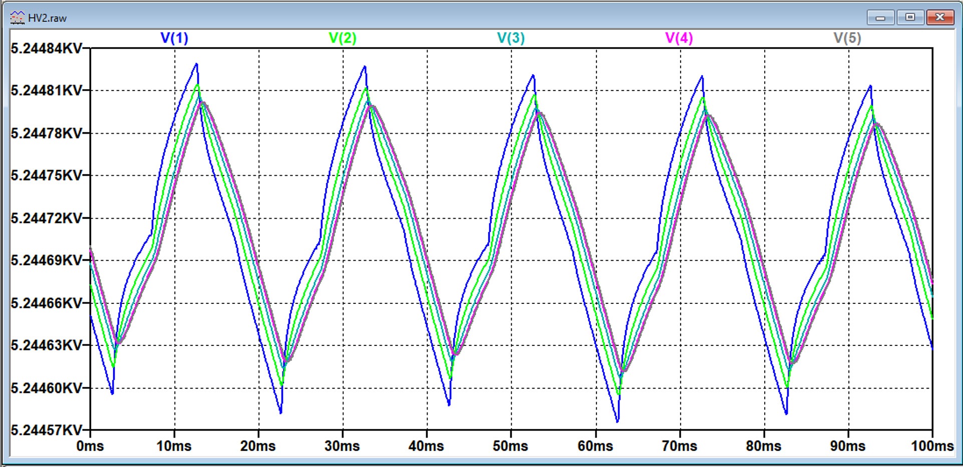

Instead of using a 50Hz sinus wave as in #502, I have connected the original Bias generator circuit to the ESL63's replacement circuit, four panels in parallel divided in 9 strips.
In the first attachment the Bias Generator's signal is visible in red, plus the resulting first 5 signals of the nine nodes in the ESL panel.
The last 4 nodes produce the same signals as the first 4 and are omitted.
The second attachment shows the same 5 nodes, but now magnified and without the Bias generator signal.
The get a steady image, the Neon bulb has been shortened.
The total 3.6nF capacity in the #502 was too high and has been reduced to 2.7nF, while the overall resistance for four panels has been kept at 6.5Meg.
Hans

It is not unimaginable if panels develop minor leakage paths which is common in ESLs that don’t use dust covers.Well thx Steve, one thing is solved, I misread the unimaginable 100Vrms for 100mVrms 😊
It is also not uncommon for leakage paths to be present on the HV PC board after some years of operation.
The formula for calculating acoustic pressure from Force is the Walker equation shown in the image that is derived in the Baxandall chapter based on reciprocity principals, and yes the on-axis output is a function of frequency for constant applied voltage to a panel area. The ESL63 uses the delay line driven segments to spread out the sound which flattens the on-axis response. If you removed the delay lines and drove all the segments uniformly, on-axis SPL would increase at +6dB/oct with increasing frequency. This is the natural behavior of ESLs.I still have a problem to see how this could be calculated into SPL, also taking Fres of the diaphragm into account, but when assuming that the SPL with 100mVrms becomes 60dB lower, would it then go to 17.52dB ?
Once you have pressure, SPL is simply: 20*LOG10 (Pressure / Reference Pressure).
Yes, for a given Bias voltage the output scales linearly with ripple magnitude. So, 17.52dB @ 10cm for Vripple = 100mVrms.
Remember, these calculations assume low resistance diaphragm and no resistance between bias supply and diaphragm.That would likely still be above the threshold of our hearing limit, but with my ear against the ESL, and the ca. 60mV on the diaphragm that came from the simulation, I hear absolutely nothing at all?
It was just to provide you starting point to understand/quantify the effect. If resistance was accounted for, it would likely drop -20dB or more.
Added Thought

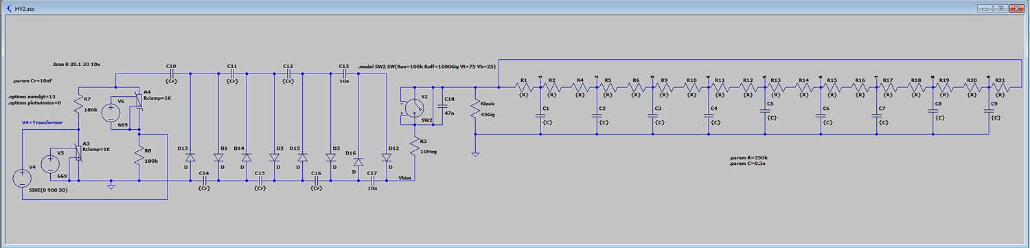

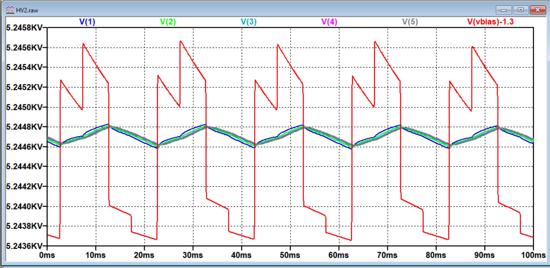

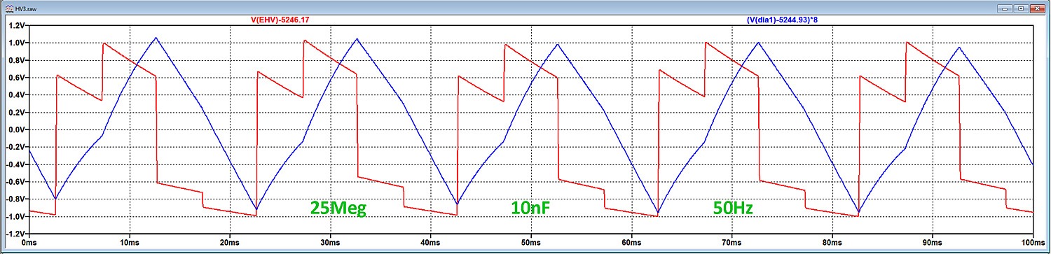

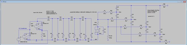

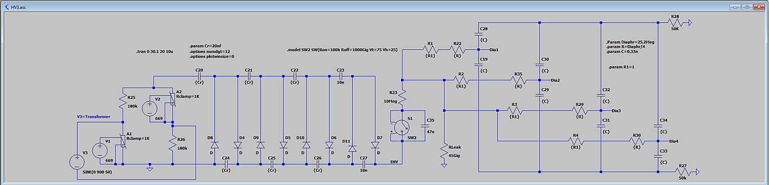

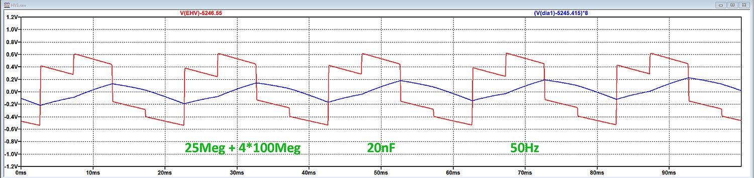

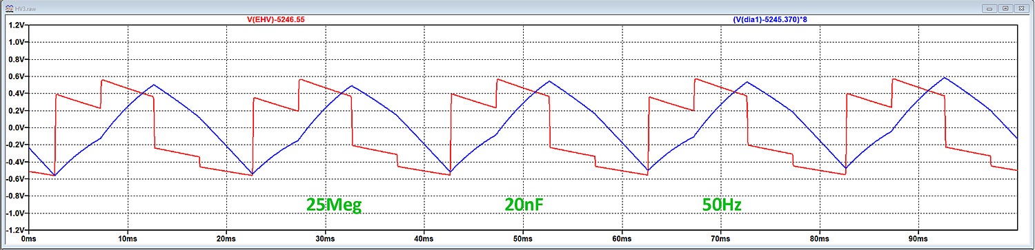

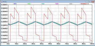

Since no further comments were given after Marcel, I have finalized the EHV model.
In #705 with the help of LTSpice, it could be shown what kind of ripple is transferred from the Bias Generator to the Diaphragm.
Remarkably the ripple was quite evenly distributed over the diaphragm.
That's why I could simplify the model with one resistor and one cap per panel, and put all four ESL63 panels in the sim.
When one panel measures 25Meg from side to side on the two diaphragm contacts, in the simplified model the can be seen as two 12.5Meg in parallel or 6.25Meg. Simulating the more complex model driven from both sides and comparing it to the simple model with just one 6.25Meg resistor gave the same ripple voltage as a confirmation.
The Audio transformer that is part of the circuit, measured a 50K Impedance per side from the stator side of the panel over a broad frequency range.
These two values are added to the model, but have practically no impact on the ripple magnitude on the Diaphragm.
Simulations are shown for resp 10nF and 20nF caps in the bias generator, almost halving the ripple.
As a last step 100Meg resistors were inserted in each of the 4 panels, something that Demian described to have done in one of his postings.
This leads to another ripple voltage drop on the Diaphragm.
All three sims below have the same scale for a direct comparison, but the diaphragm's ripple voltage has been magnified by a factor 8 for a better view.
I have also added the .asc model for experimenting with other Diaphragm sheet resistance values.
Conclusion so far is that with the values as used here, AM products seem to be rather harmless at -100dB below signal amplitude when having 10nF caps in the bias generator.
Going to 20nF and putting 100Meg in series with each panel, another ca. 13dB improvement can even be achieved.
Hans

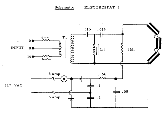

As has been mentioned before Quad made no real changes to the electronics with the introduction of the 6 panel speakers, what would be more appropriate values for the resistors at the end of the line, R5-8 in the ESL63, 360K
Stuart
Stuart

With this ripple, contribution from AM modulation is below -97dB.
A 100Vrms ripple would cause AM modulation products at least 60dB higher, causing intolerable sound reproduction.
Hans
Please look at the sim in #710 and you can see what the ripple is.
Hans

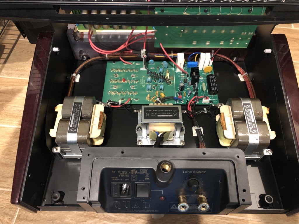

Slightly OT: I understand that the newer QUAD ESL 2805 and 2905 have different step-up transformers than the ESL 63 family derivatives.
Does anyone have info about this, in what way the newer steps-ups are different?
Jan
Jan
I will have a repair coming in this spring... no time schedule due to working over time. I am also curious so I will def take the opportunity.
Jan
They are mechanically held in the base of the speakers slightly differently, but the speakers measure virtually identically, so I wouldn't expect the transformers to be significantly different.

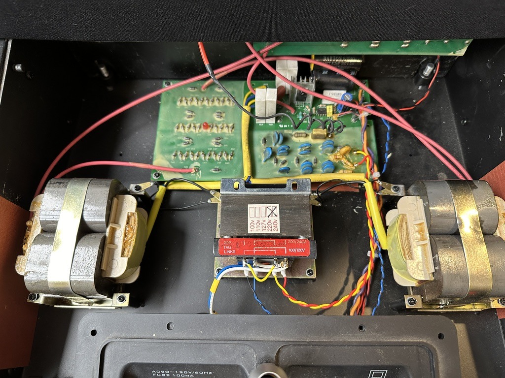

Here's a 2805:

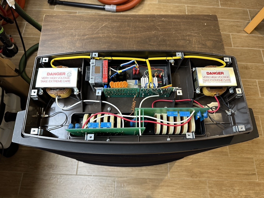

Here's a 63:
without the retaining cover on the 63 transformers they look very much like the 2805's:

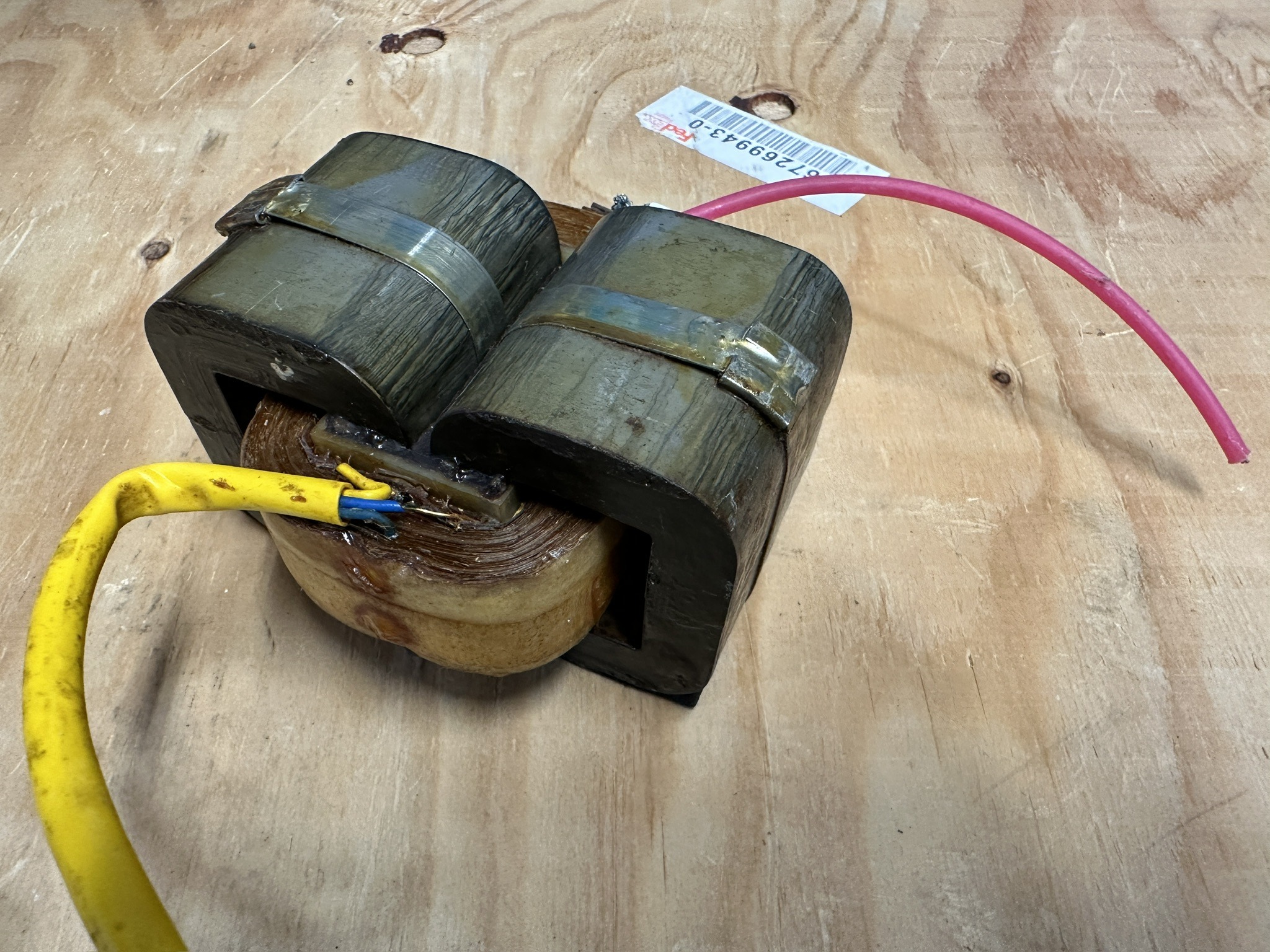

The 2805 has a winding former and the 63 does not.
Based on a cursory exam and the fact that the speakers measure the same, I'd say the input transformers are more similar and different.
Sheldon
Thanks Sheldon, indeed they look pretty much the same aside from the coil former.
Everything else looks the same too, so it wouldn't make sense to change the transformer parameters.
Thanks for the pics.
Jan
Jan
Yes, everything else has remained the same as far as I can tell from the latest 63's to today. That's why I tell people the best value is a set of rebuilt 63's.
I'd be shocked if they ever make changes to this design again, given that the name and design is owned by a giant audio clearing house, who doesn't have much appetite to dump resources into such a fringe product for a dying consumer base.
Sheldon
Sheldon
