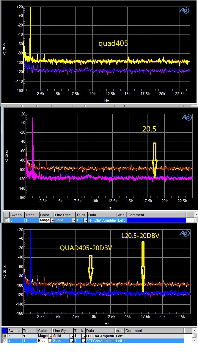

These three amplifiers. It is not the smallest circuit of thd. The smallest thd circuit I designed is l20.5 (THD 0.0015% 50W) and l12-2 (THD 0.0006%). But this is not my favorite. I prefer l20se L25.
Because thd is in practical application. It doesn't mean good or bad. Maybe a thd 0.2 amplifier is better than a thd 0.001%.

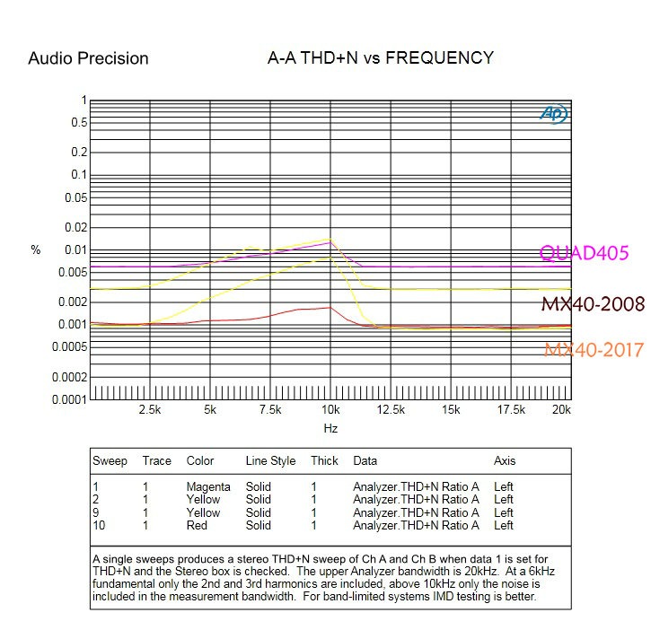

its thd is not low.
0.01%

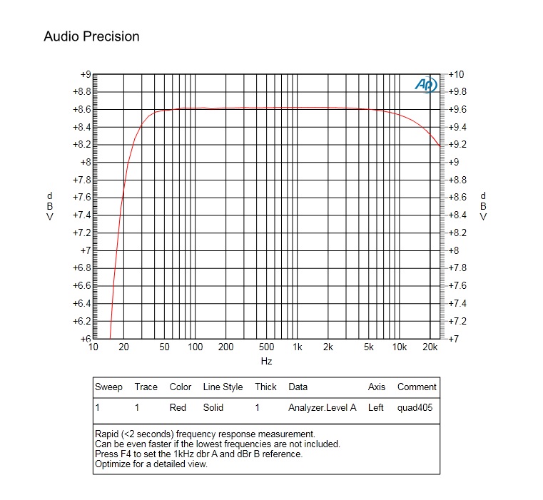

15-55Khz. The high-pass is two-pole.The frequency response should not be very good.
All amplifiers have limited bandwidth. How limited is a decision every designer has to make.But I found that the designer of quad405 deliberately removed some low frequencies. And high frequency signal.
It was intentional.
It had nothing to do with the LS35/A whatsoever. It was to stabilize the amplifier, as stated in the WW article by PJW. If you have evidence to the contrary please produce it.This is to meet the requirements of matching ls3/5a at that time. A way to make the audience feel comfortable.
Please don't post opinion as fact.

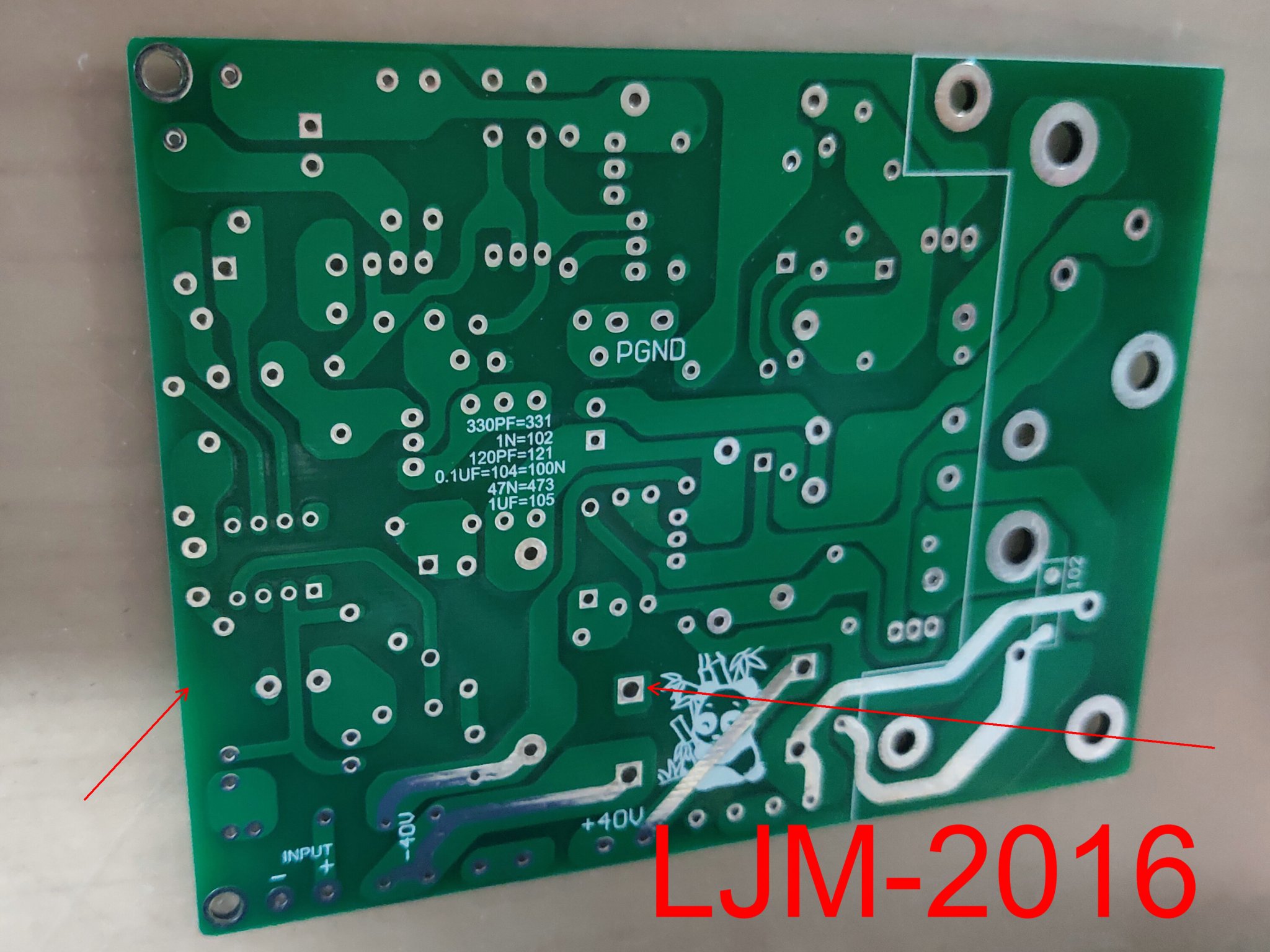

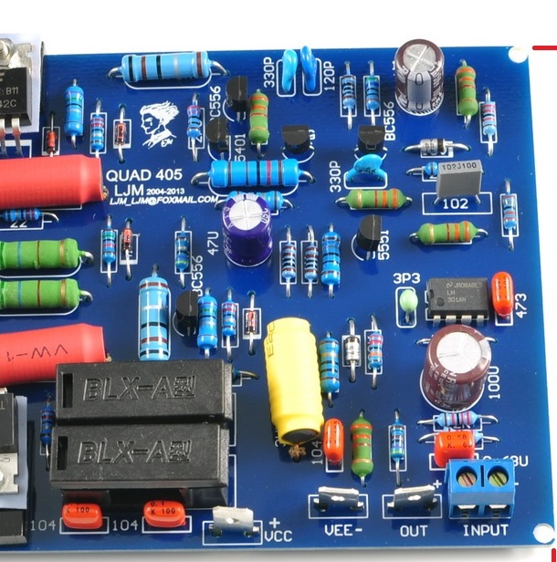

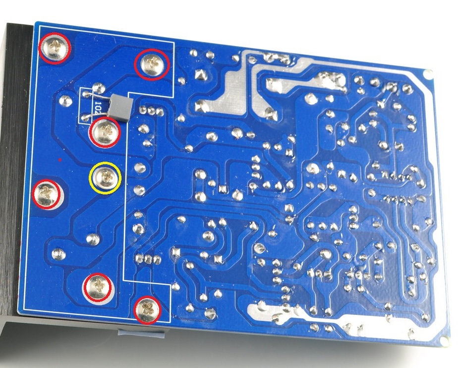

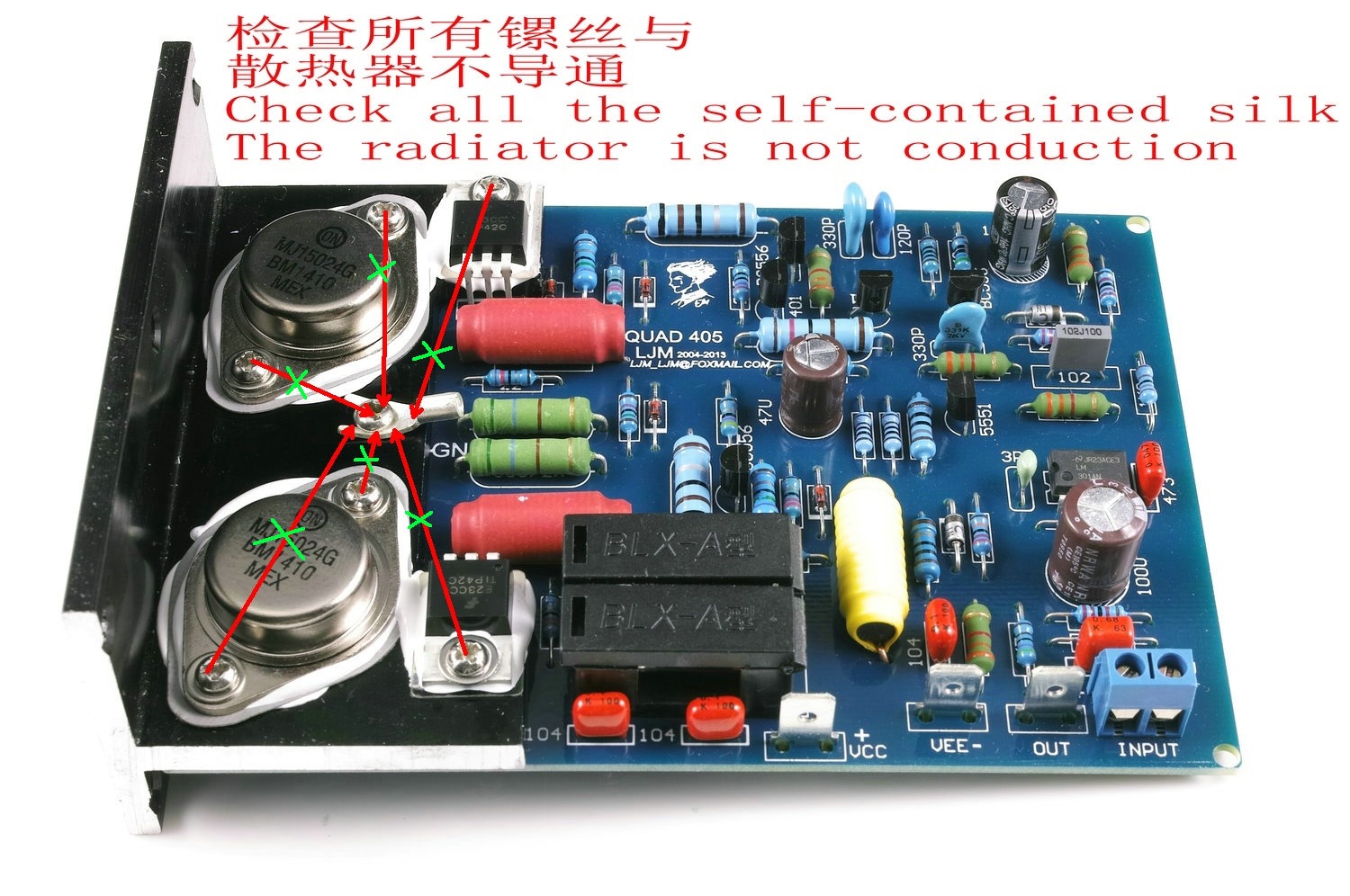

I made this PCB in 2012.Hello ljm-ljm
greetings found this quad 405 pcb i have all parts
printed on the pcb i it k to build it.
warm regards
Andrew
Then many people in China copied it. Although I am not an inventor.
Please note that his vcc+ is wrong. It should be from top to bottom.
Instead of walking around. Because I designed it. So I know its mistake. I revised it in 2016.

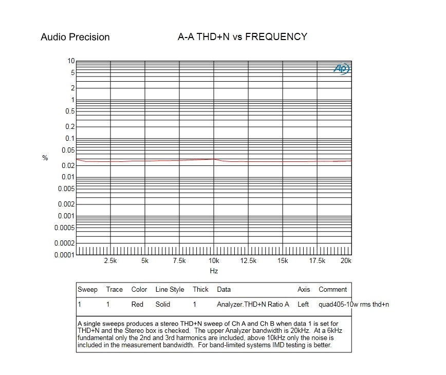

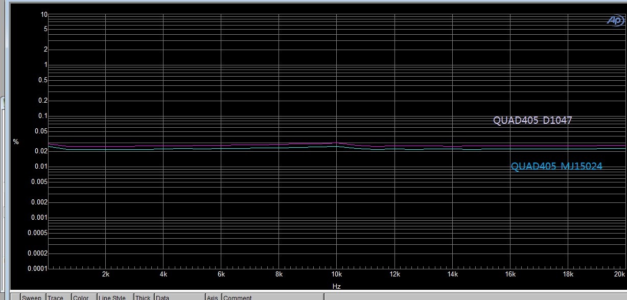

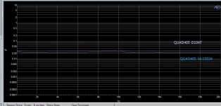

It's all made by me. Of course I measure it.
In fact, the performance of quad405 is completely different from what you said.
Its distortion is not 0.01 but 0.02-0.1%
The attenuation of low frequency and high frequency is very serious. This has nothing to do with amplifier stability.
This is common sense. This is only determined by the setting parameters of the filter. Mainly change the habit of listening.
Not stability. Any amplifier can work stably at a lower frequency.
Quad405 is not an excellent amplifier.
Never seen that, in hundreds of examples, unles faulty. I have consistently seen under 0.01% in 405-2 onwards.
'Extremely serious' is opinion. 15-55KHz with a two-pole HP is fact. Amplifiers with this bandwidth are legion, and they don't get singled out as having 'very serious' bandwidth problems.The attenuation of low frequency and high frequency is very serious.
Any amplifier with global NFB has to integrate above some high frequency limit to avoid instability. This is fact from control theory. Not opinion.This has nothing to do with amplifier stability.

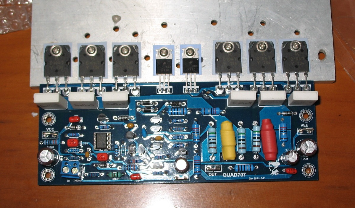

I have been making quad405 for more than 16 years. Including quad606 707.
In fact, the effect of quad707 is worse than that of quad405. Not better.
