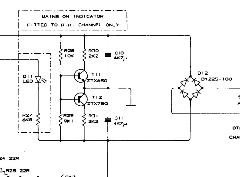

I think I've found something that might allude to what's going on. Just listening to the faulty left channel, if I start playing something and then turn on the amp, it starts of only a little distorted but then quickly gets more distorted until it reaches a certain level and just stays there. As soon as I turn the amp off, the music continues playing for about 5 seconds, except it sounds almost completely fine.
So, the sound is only distorted when the power is going through it. Could this be a problem with the virtual earth or something? That's a complete guess, but I've seen mention elsewhere of problems with the virtual earth, and it was the first thing that popped into my head when I only heard it when the power was on. R32 and C12 are to do with the virtual earth, so I'll check those.

R32 and C12 are simply to tie the chassis to the circuitry.
The virtual earth is this section and all it does is 'balance' the voltages across the two large reservoir caps. You can measure the rail voltages from speaker ground and they should be approximately equal and opposite in polarity. Or just measure across each of the reservoir caps. Both should be the same.
You need a proper scope to look at what is happening 😉 but see what those voltages are first.

Having a load shouldn't alter the voltages providing that the amp output has no DC offset.
This is where it gets a bit different with the 306 and its virtual ground because if there is an offset and if you add a load then all that should happen is that the voltage on the two reservoir caps will shift proportionately. So if the voltage on one went up the other would have to go down to maintain the total supply voltage figure.
I would say with NO load attached you should be able to measure zero volts DC between the speaker terminals. If that is OK then adding a dummy load will not change the rail value and ratios.
It doesn't look like there's any dc offset at outputs, and the voltages on the caps mirror each other on each channel.
