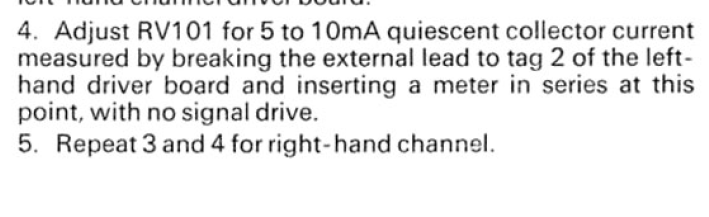

I will do the final setup tomorrow before giving it juice. Aiming at 9mV between 4-6.

I bias 303s at exactly 5mV across 4/6. More and it starts to run away. Viewing THD residuals at the same time, this is clearly enough.

First I let it warm up and started the setup. All went good. Since there was same debate on the bias I opted for the lower value, in this case 5mV.

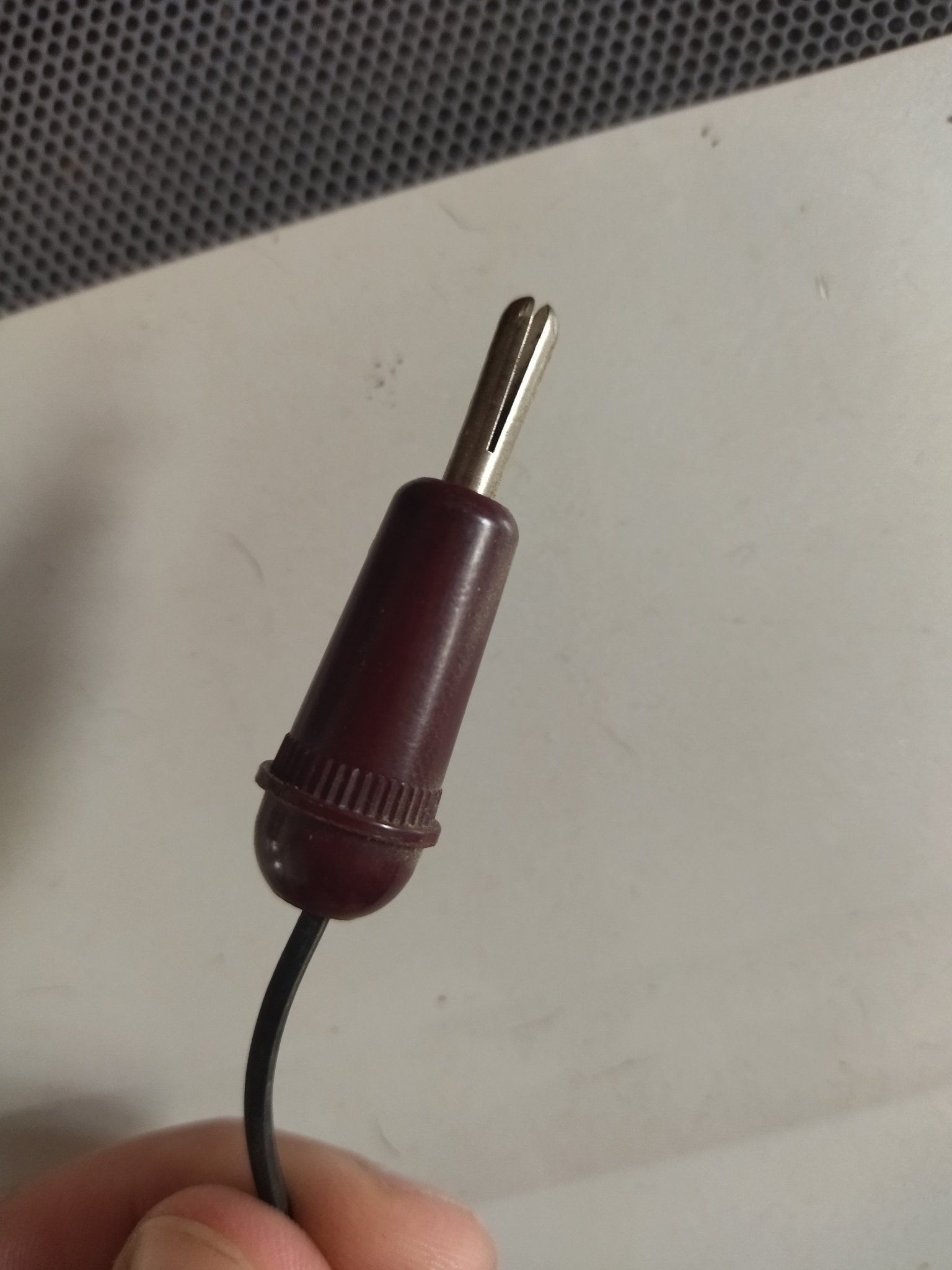

The only thing that is missing is two of these connectors, only have two.

Those just look like ordinary banana plugs so should be easily available.The only thing that is missing is two of these connectors, only have two.

True but irrelevant. Quad have specified a range for the total bias current between pins 4-6, which by definition already includes that from the drivers and pre-drivers. No need to sweat this issue.The current in the 0.3 ohm resistors is actually the sum of the currents in the output transistor plus the driver/s.
I was going off this which as a method is correct and this does not include driver currents.
I have a couple of other Quad documents that describe the circuit and they simply say 'see setting up' for how to adjust the bias but these documents appear not to have anything with that title in them. I looked a few times because the breaking the circuit method is open to accidently shorts etc and not one I would automatically recommend. That is why I came up with the method I posted.

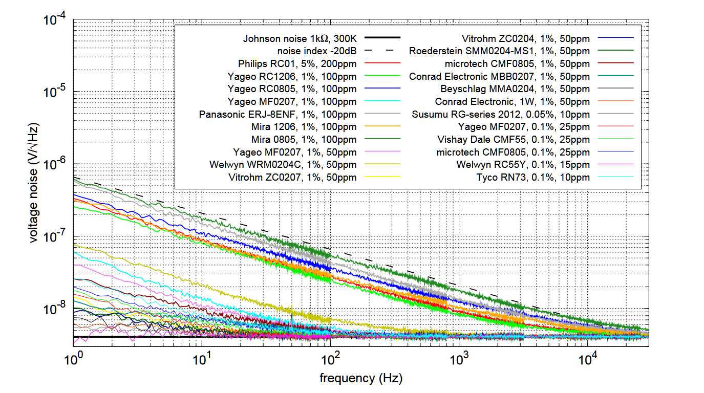

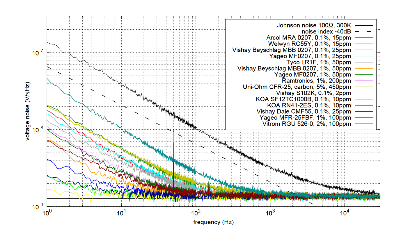

I was suggesting the low noise resistors for the Pre, it's not as important in the Power amp, though it will make a difference in the input stages.
There is a 'top five' of low noise resistors, but you'll get better results with low noise semiconductors in sensitive areas.

"RS components often get the "RS-branded" metalfilm resistors, which I found out are cheaper and better spec'ed than the KOA types like MRS25."

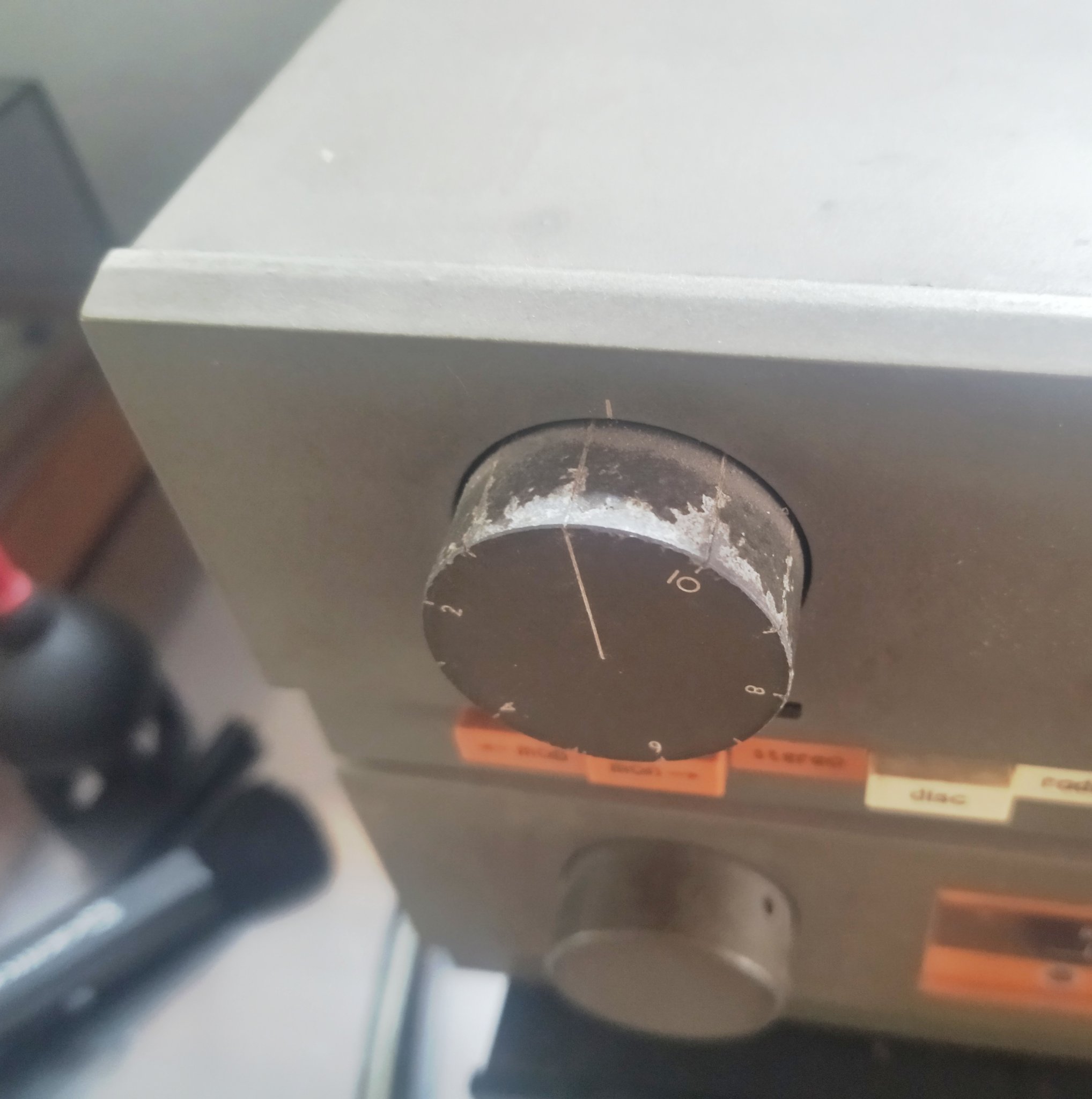

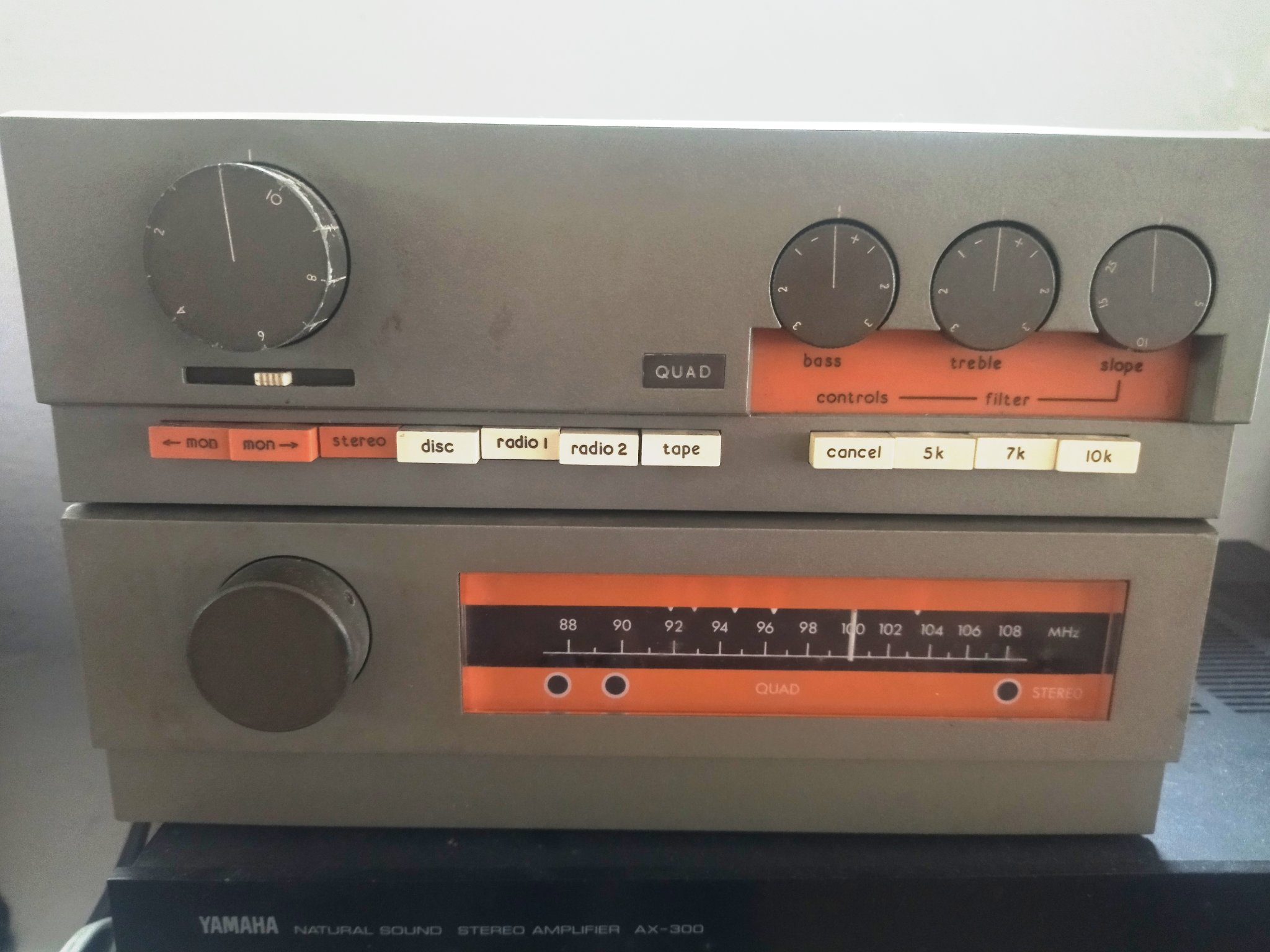

Here is the cosmetic condition of my 33 and fm3:
Any suggestion on how to deal with that nasty volume knob? It is the only thing that needs a touch up. The paint overall is in very good condition 🙂
