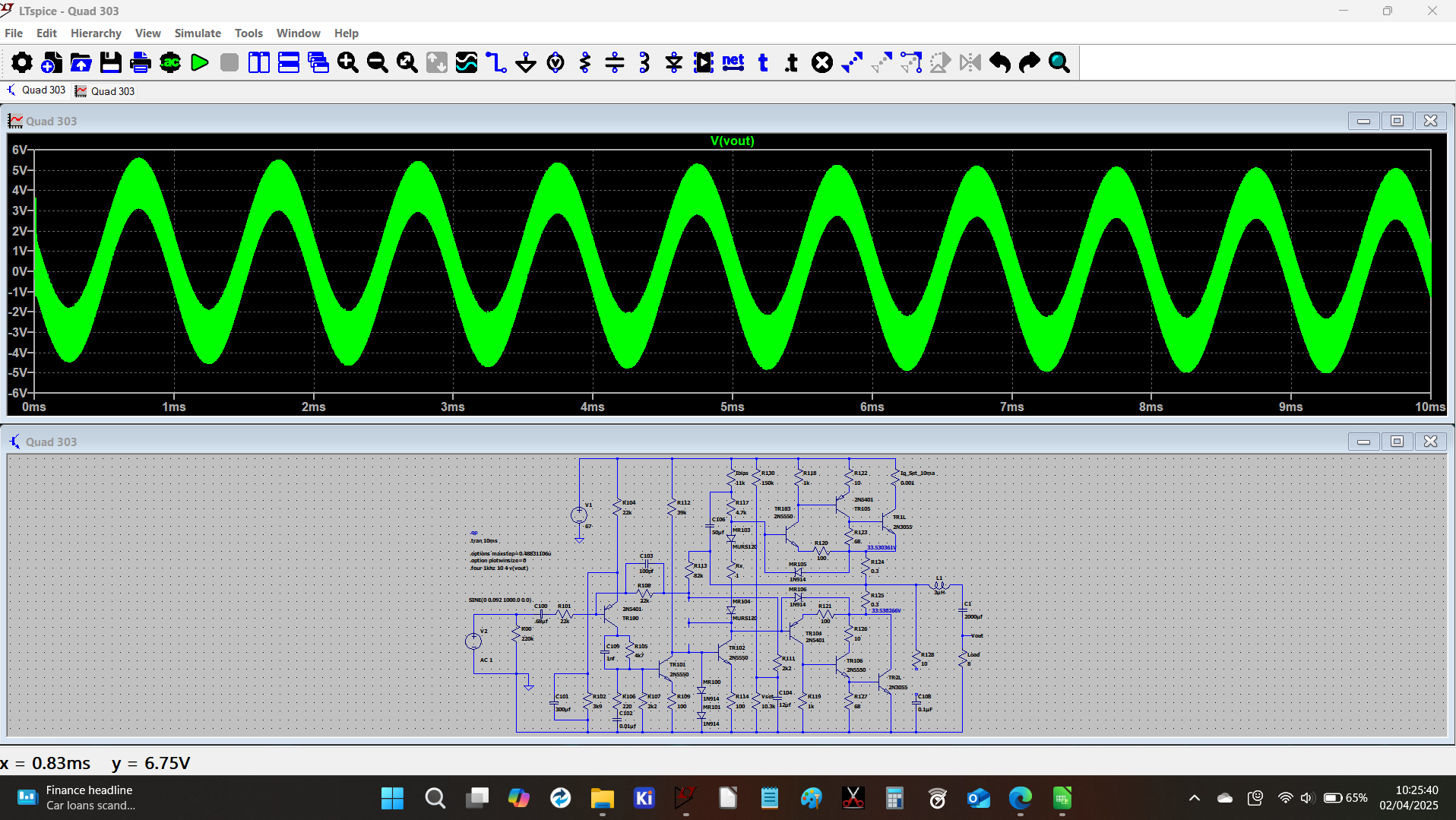

What could happen with an unstable design?

the 'triple' configuration used by Quad partly relies on the 'slow' speeds of the original devices for stability
The early 2N3055's from eg RCA, were hometaxial, with an 800kHz fT. Modern 2N3055's are epitaxial with an fT of 2.5MHz minimum. Spooning in a modern 2N3055 into a 303 might well result in instability.

It can behave as an oscillator running at many hundreds of kHz.What could happen with an unstable design?
This is a simulation of the 303 pushed into instability. The output is supposed to be a 1kHz sine at 2.83vrms (1watt/8ohm loading).

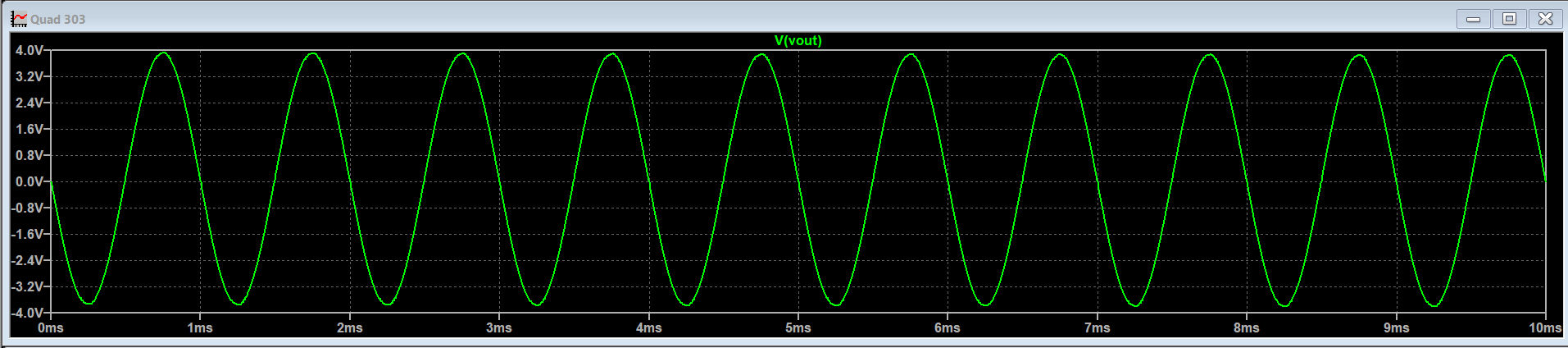

And it should be like this:

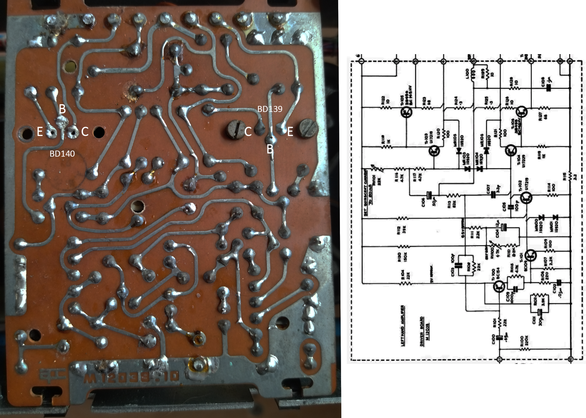

Just to make sure I don't screw this up:
Does this look right?
I will remove Tr106 and replace both Tr105 and Tr106 with BD140 and BD139.

I don't like working off pictures 🙂 but that does seem correct. Make sure you form the leads correctly to get the different pin out to fit neatly.

Now to the big update!
I changed both transistors and I'm seeing 67V across 1-9, 33.5V across 5-9 and I'm now able to adjust the quiescent to 5mV between 4-6 😀
Everything went smoothly apart from a strange behavior in the beginning. After turning it on for the first time the DBT flashed and went silent. Then after about 20 seconds the light started pulsating with a flash followed by about 3s of no light. After messing with RV101 for a bit it stopped so I guess that's the culprit. As someone suggested earlier I probably should change the pots, multiturn ones if I recall.

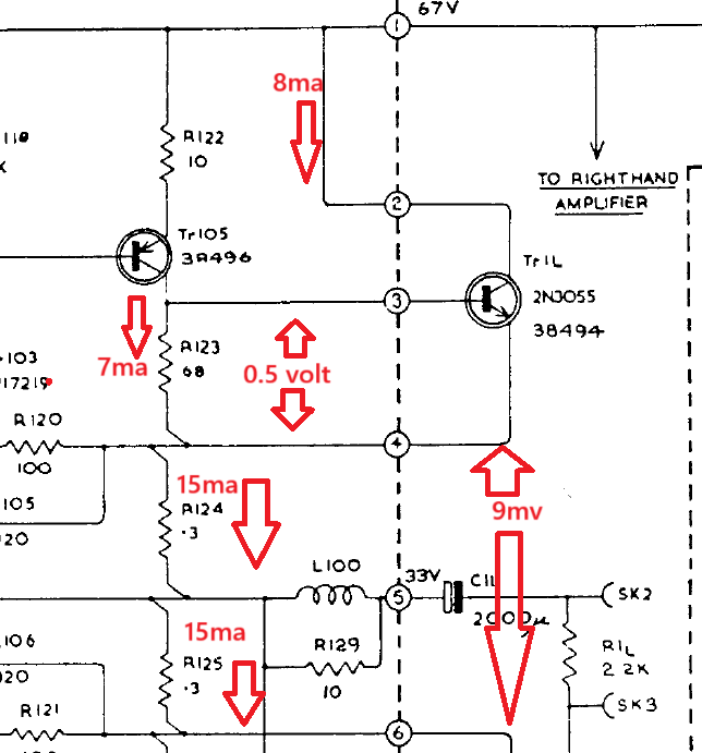

Just a small detail regarding bias current... looking at the circuit and the recommended bias current is 5 to 10ma. The current in the 0.3 ohm resistors is actually the sum of the currents in the output transistor plus the driver/s.
The current in the 100 ohm resistor is so low as to be discounted, the current in the 10 ohm can be either approximated (good enough) or calculated exactly by measuring the voltage across it. Approximation is fine here though.
The upper NPN output needs around 0.5 volt across base and emitter to just begin to conduct a little and so we can say that I=V/R =0.5/10 = 5 milliamps is flowing. When you measure the voltage across the 0.3 ohm/s you are measuring 5 milliamps PLUS the wanted bias current in the output transistor.
So lets say we want 8 milliamp bias current. That means we need 13ma flowing in each 0.3 ohm or around 8 millivolts across the pair of them.

That sounds about right. It works like this. The 8ma is the wanted bias current. The 7ma flows from the driver into the 0.3 ohm and so does the 8ma. That gives 15ma flowing in the 0.3 ohm which gives a total value of 9mv across the combined value of 0.6 ohm. Its not exact because we estimate the 0.5 volt and we also have a small base current into the 2N3055 but it gets us close.
The official way is to break the connection to the collector and measure the current but that can be risky as its easy to slip or make a bad connection. Another way would be to break the connection and add a 1 ohm in series and then set the voltage across the 1 ohm for 8 millivolts. That would be a true reading of the current.
