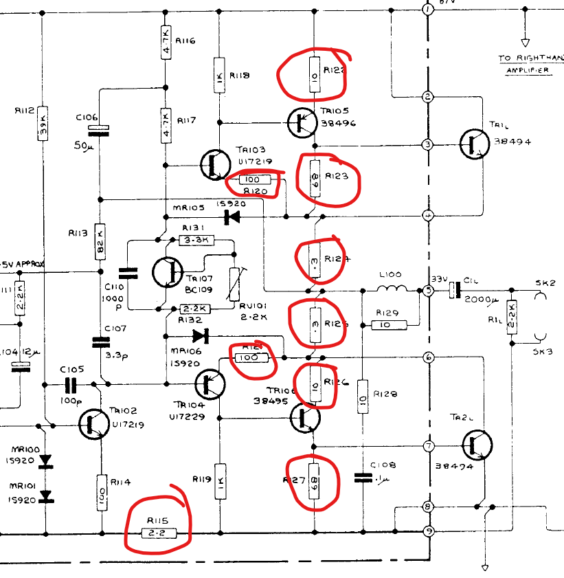

Excellent. So that channel you have powered up now seems basically OK.
The way to approach the other channel (well what I would do anyway 😉) is to power it up again (with the bulb of course) and look at voltage readings to see where and why the current is flowing. Of course give it all a visual look for burnt resistors and so on but remember that checking values in circuit doesn't usually work because of interaction with other parts.
The idea with faultfinding is to disturb and unsolder as little as possible. Try and gather the evidence by measurement.
Having said that the very low values may be possible to test in circuit. The two 10 ohms left uncircled should be fine. R129 would read 'short' in any case as its across a coil. Those two will be OK.
See what you find. Next step would be voltage checks to see where the current is flowing.
If they are easy to unsolder you could remove pins 3 and 4 and pins 6 and 7 which would isolate the output transistors. You could then see if the supply voltage comes up.
Ultimately I suspect you will be looking at more than a failed resistor and more likely a problem with one or more transistors but we need to isolate the problem first.

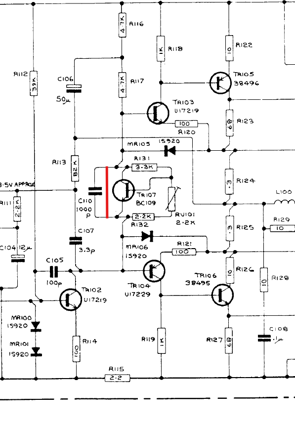

One other thing you can try.
Add a link across this cap so it shorts out the bias transistor. This would force zero bias current normally. I think its worth doing just to see if the output stage responds to that. If it did the current would fall to zero and show there is a problem with the biasing.
I suspect the fault will still be present (high current flowing ) but its such a quick check that its worth doing.

Another good news! From visual inspectio R122 is toast (10ohm). I already removed it, need to find a replacement. Could that be the cause?
I have 10R's but I believe they are for low current stuff. Tempting though😆
Edit: The resistors are blue so 2w right? Will swap.and see what happens

Quick update: Swapped R122 and now the bulb is lighting up real strong. Desoldered pin1 on the good channel to work only on the bad one.

Yeah wishful thinking on my part.R10 is a symptom, not a cause.
Tomorrow I will try the short cap test and see if something changes.
Tomorrow you should test all the power transistors before you do any such thing. Don’t apply power until you’re sure all the silicon is OK.
Do basic checks on the 6 transistors in the output stage.
You can isolate pins 3 and 4 to isolate the upper output transistor and pins 6 and 7 to isolate the lower one. Do that to test them.
See if the others read as faulty in circuit. Compare with the good channel if you are unsure. You typically see a low reading if one is faulty.
Lets see what all that shows.

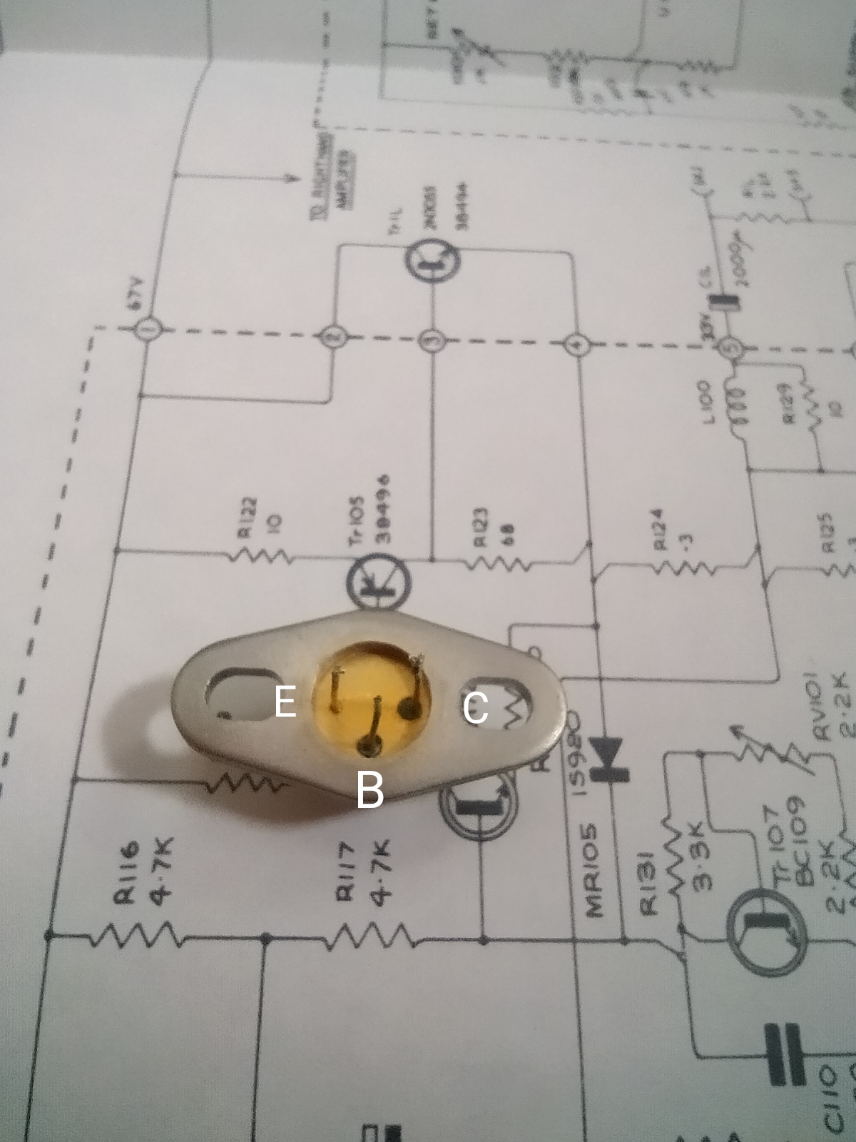

Tr105 is reading as diode between B-E and B-C. Giving a voltage drop of 770 for both.
Unfortunately it is giving continuity between E-C so toast right?
It looks that way. TR105 is a PNP and so should not read from C to E with the red lead on the emitter.
Does the transistor (which looks like a T05 style) pop out of that heatsink?
No, even applying a great deal of force it didn't budge.
There seems to be a ring inbetween the transistor and the heatsink (isolation?), maybe with a x-acto knife I can get in there. Or just ask my father, the king of angle grinders 😆
From my search the replacement should be BC461 or 2N5322
I was wondering about replacements as well. All these are very old devices now. Using something in a different package outline might be a possibility as well such as BD139 and BD140. Its all uncharted territory with regard to stability in the output triple configuration. Power dissipation in the drivers is low when the amp is idling but will increase at very high output levels, and so small heatsinks are needed really.
