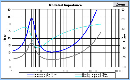

Two exactly the same drivers wired in series don't change Qts over a single
unit because the ratio of the variables involved in a calculation remains the
same.
You'll find in books following formulae to calculate TS parameters once
you have recorded impedance vs. frequency.
Ro=Rmax/Re; Rmax= max value of Z at Fs
Qms=(Fs*sqrt(Ro))/(F2-F1); F2,F1=frequencies at Rx
Rx=sqrt(Re*Rmax)
Qes=Qms/(Ro-1)
Qts=Qms/Ro
