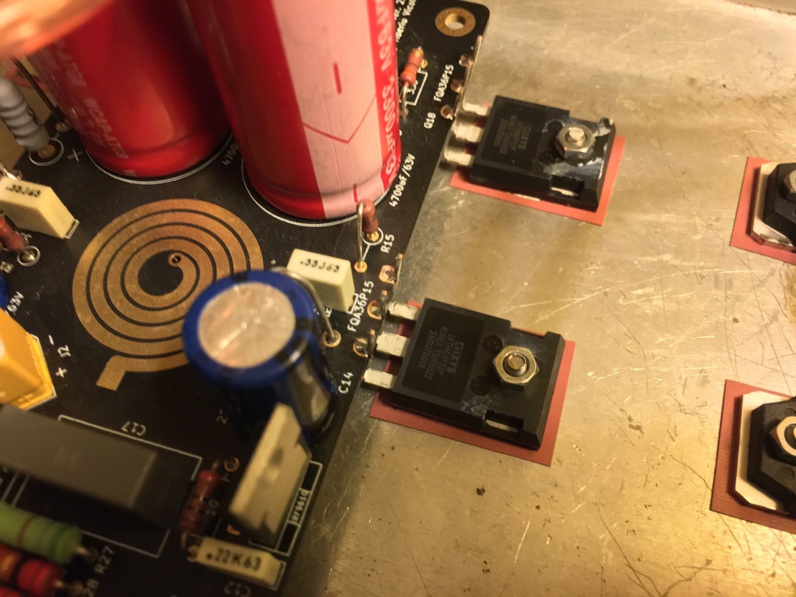

I accidentally had the circuit boards for the Q17 Turbo made with 1 oz instead of 2 oz as specified.
Can I still use the boards? Can they stand it? Or do I have to have another one made?

@ZoltanKl 1oz is very OK and amplifier will perform very well. @stef1777 did a great job and designed an exceptional PCB, so go for it.

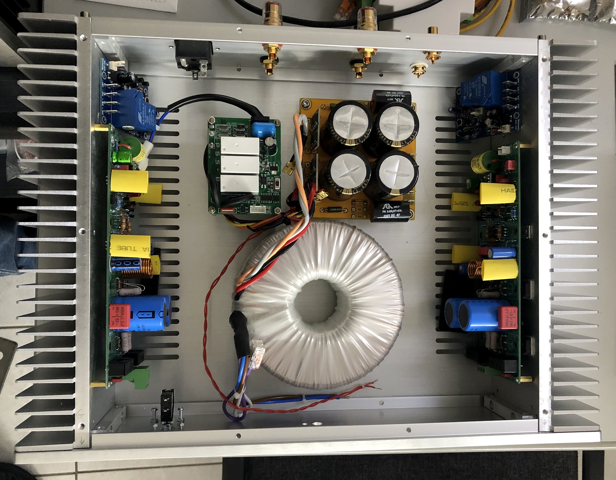

Hello everyone,

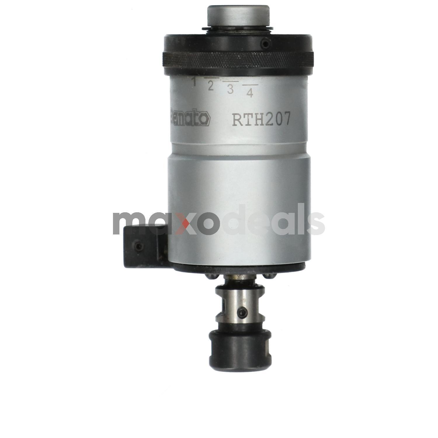

Just to let you know that my amp is progressing slowly. I finally received the chassis. I will have a lot of work. I have 42 holes to make, 22 of which need to be tapped. I gave in and ordered a device to do the tapping automatically.
The sequel to the next episode.
Stef.
