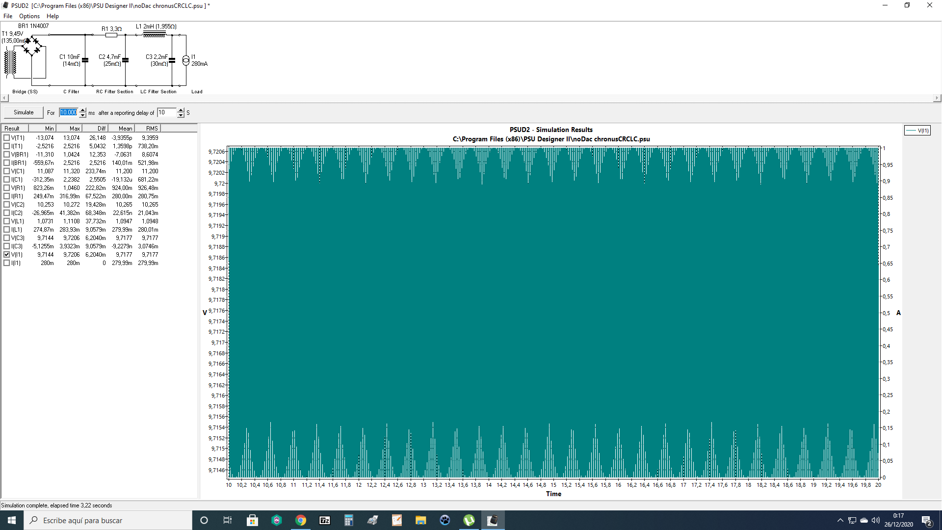

Attached new psudII simulation with corrected values.

There is a thread on diyaudo that measures regulation of a 15+15V 30VA R-core - I'd suggest you change the transformer winding resistance to about 5 ohm.

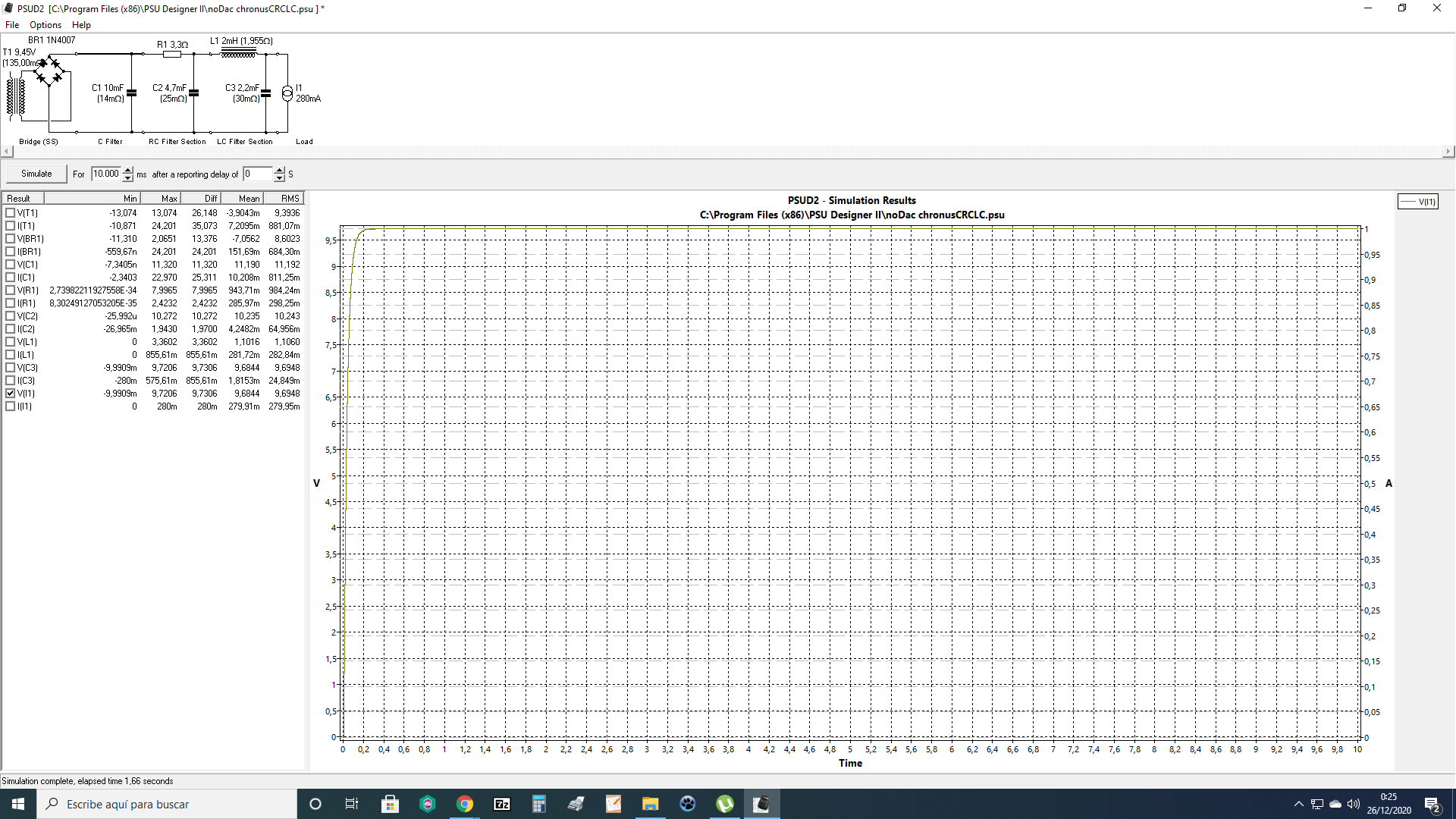

If you modify the load to a step load (eg. change from 280mA to 100mA, or vice-versa, from at 10 secs), and change the reporting to 9 sec delay and show 3 secs, then you will see no 'oscillations' - ie. the CLC filter is over-damped.

Given your likely load, and the filtering, you could have used any diode as the rectified current is so low and the winding resistance is so high.

Why? Do you refer to source resistance? The source resistance is low 135 miliohms. Do you want to say that I add a 5 ohm resistor between the power transformer & rectifiers?

PSUD2, like vintage valve rectifier datasheets, uses an equation to calculate the effective secondary winding resistance. PSUD2 includes a calculator where the primary winding voltage and resistance, and the secondary winding voltage and resistance, can be inserted, and effective secondary resistance calculated (click on the "..." button on the right side of the transformer part value input pop-up window).

It shows about 7 ohm of series resistance for the 15+15 windings. On review, your 9+9 windings are in parallel, so I'd suggest using 5//5 = 2.5 ohm. The present value showing in your sim circuit is 0.135 ohm.
9+9 windings in series = 10 ohm?

The 15+15V 30VA windings in series appear to be about 7 ohm (post #24 indicates 7Vrms droop for 1Arms loading).
9+9V 30VA windings would be fewer turns, with a higher current rating, so likely to be lower resistance than 7 ohm. Assuming 5 ohm as a series resistance (or even less), then doing some mental arithmetic without the alcohol, the two 9V windings in parallel would be 2.5//2.5 = 1.25 ohm.
