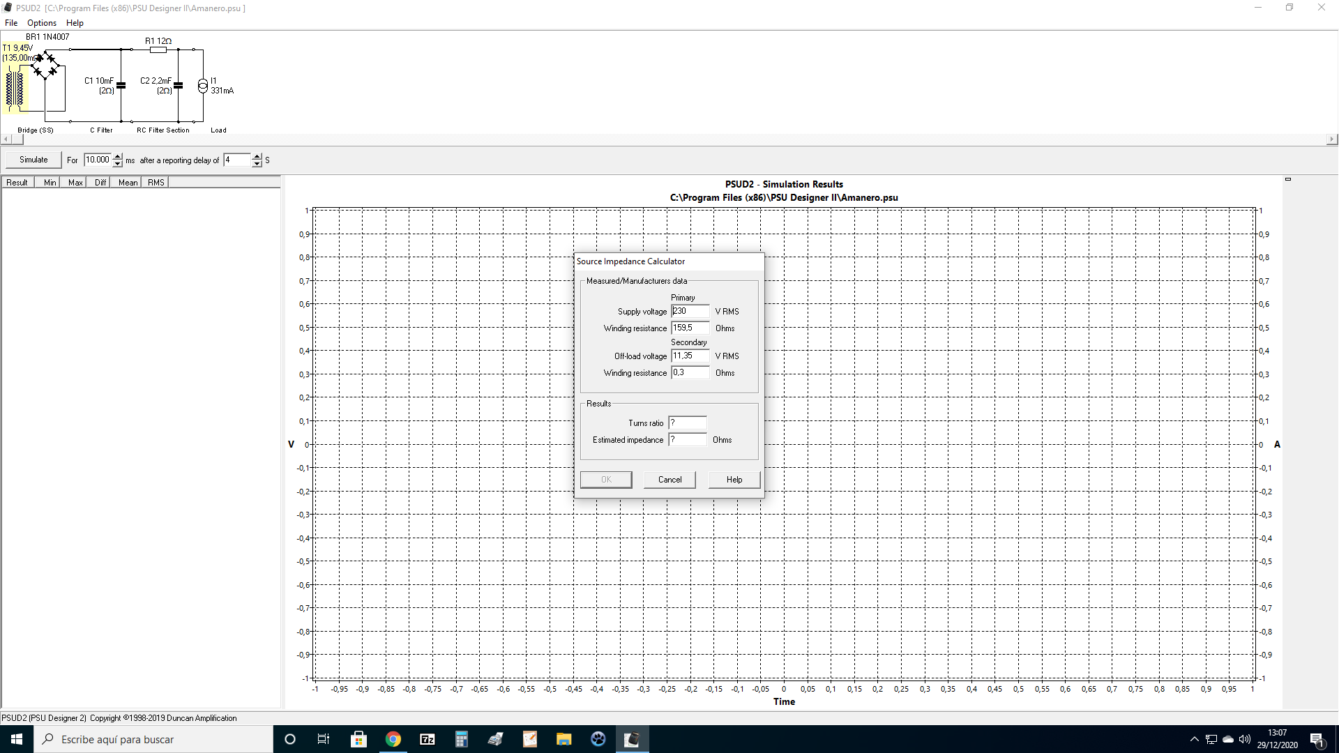

Do you mean posts #33 and #38 descriptions of estimating the effective secondary winding resistance ? Have you been able to measure the windings resistances with a meter?

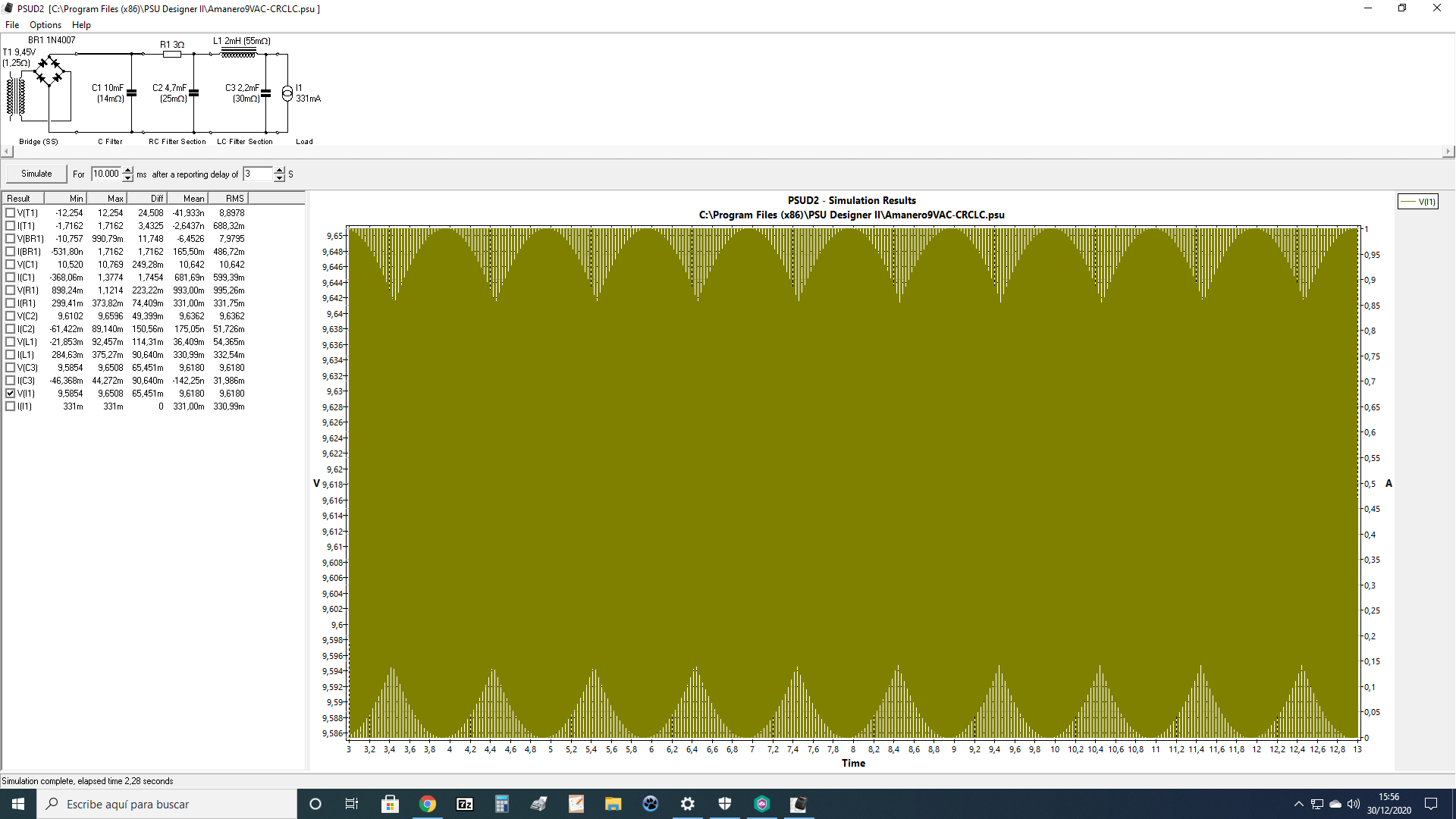

Something here does not look quite right: the simulation above is one supply-rail only, but the choke - IF I understand correctly - is a common-mode choke of 2mH?
In which case the series inductance that will appear in the single-rail simulation is the leakage differential inductance of the CM choke: and that is typically about 1% of the CM value - for reputable parts as named already.
So the L value should be around 20uH, not 2mH, for single-rail simulation. Also note that +/- 50, even 100% of that 20uH will have a small/trivial effect in the audio band - that is what I meant by 'close-enough'.
And yes - PSUD will probably not like to report on such small L values*
However - at just 20uH, you can hand-calculate the impedance at 5-10 frequency spots, and simply add those to the R value, to plot your own supply impedance curve - in the time it takes to make a good coffee. Close enough.

Does this refer to the Selectronic R-Core 2x9VAC 30VA from post #20 ? If so then please recheck measurements (note that some multimeters have a hard time measuring resistance for high inductance windings).Yes, 195 ohms primary & 0,3 ohms secondary.

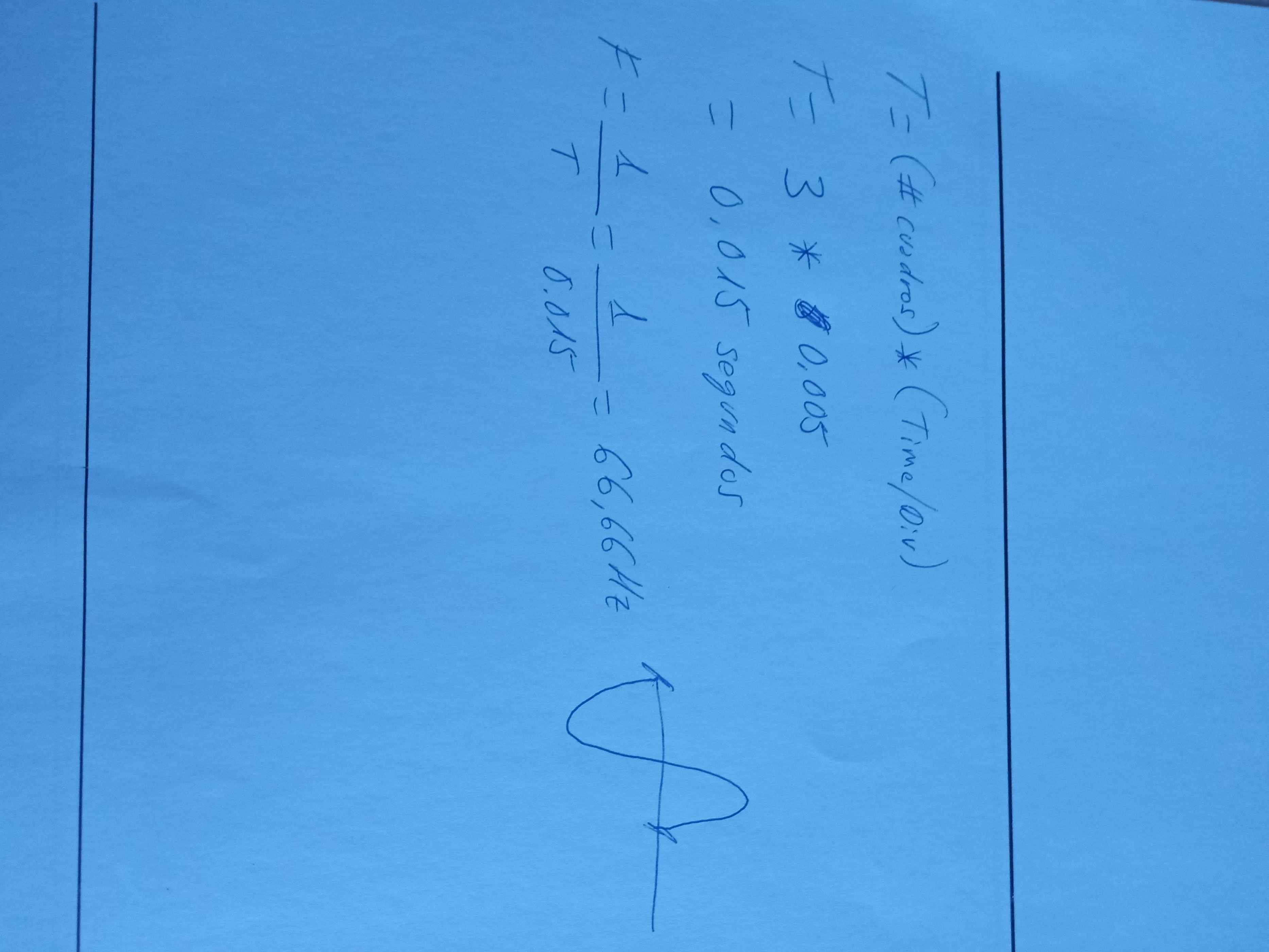

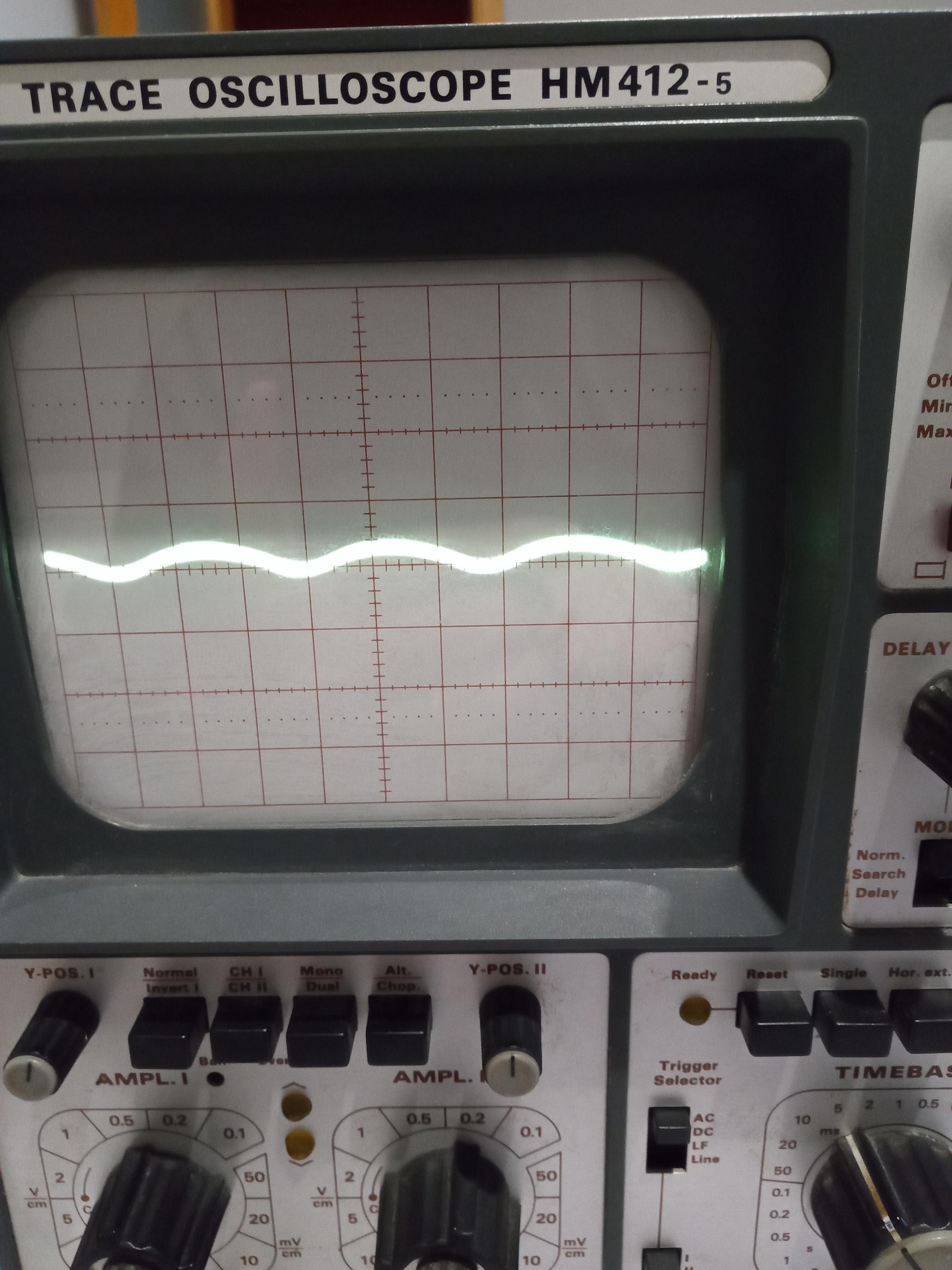

Measured with the oscilloscope the resonant frequency @ 66.66Hz, also measured the PSU AC ripple that's before the Salas regulators 2mV.
