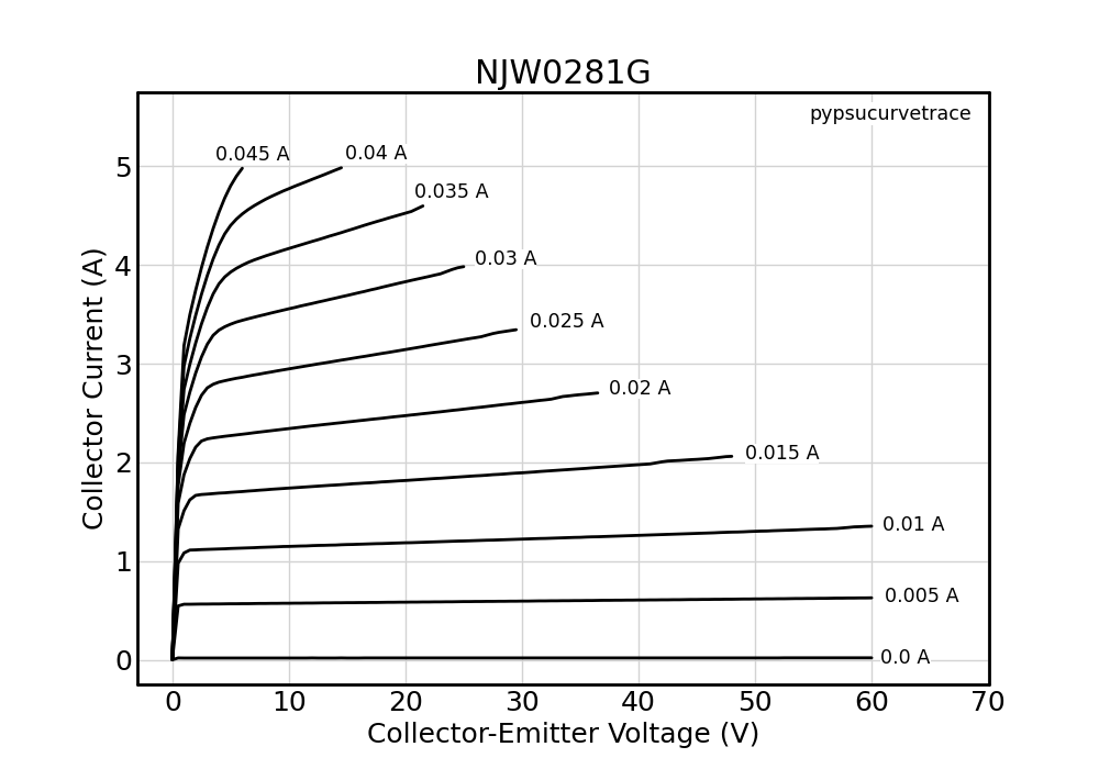

I'd be interested to see some curve results with audio power BJTs
See attached curves from a NJW0281G. The data are here.

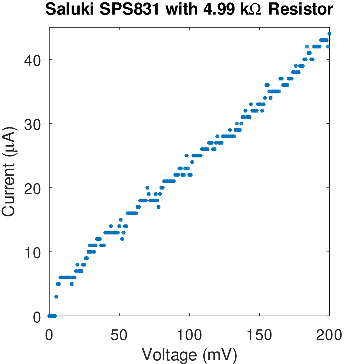

I've got a new toy: the Saluki SPS831 programmable power supply (30 V / 1 A) is specified with a superb 1 µA resolution on the current readback. I tested the SPS831 with with PyPSUcurvetrace using a 4.99 kOhm resistor as a load for the Saluki. Take a look at the attached plot: the resolution really is 1 µA, and the accuracy is about 3 µA or so (this depends on the quality of the internal auto zero for the current readings).
This is a very nice tool for curve tracing of low-power DUTs with PyPSUcurvetrace!
