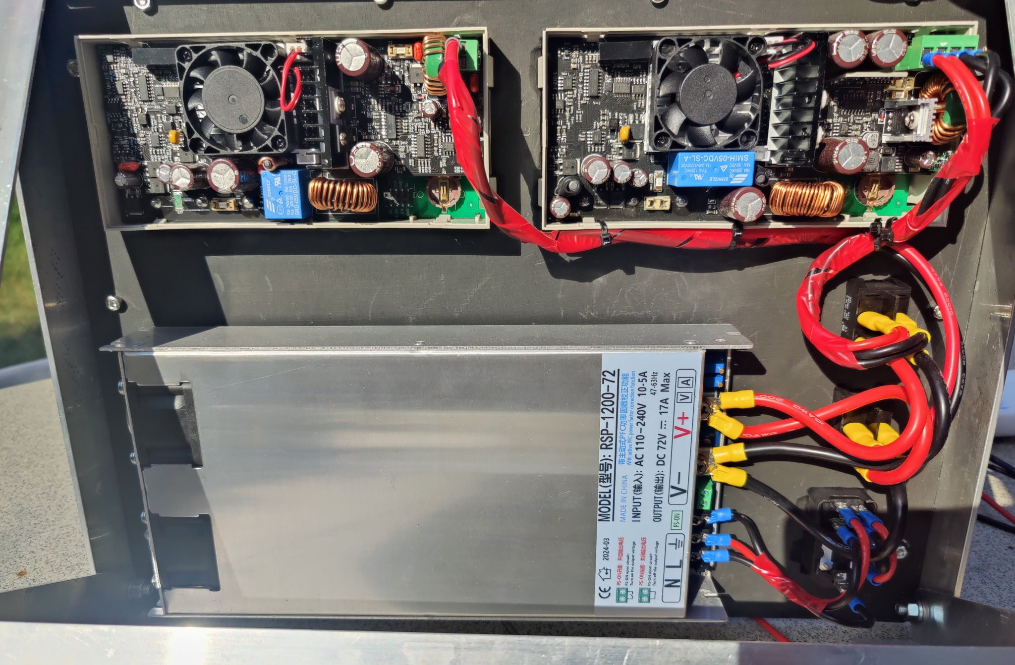

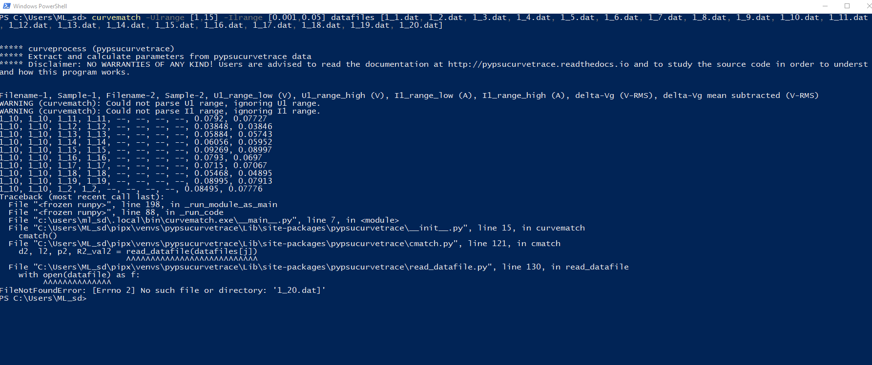

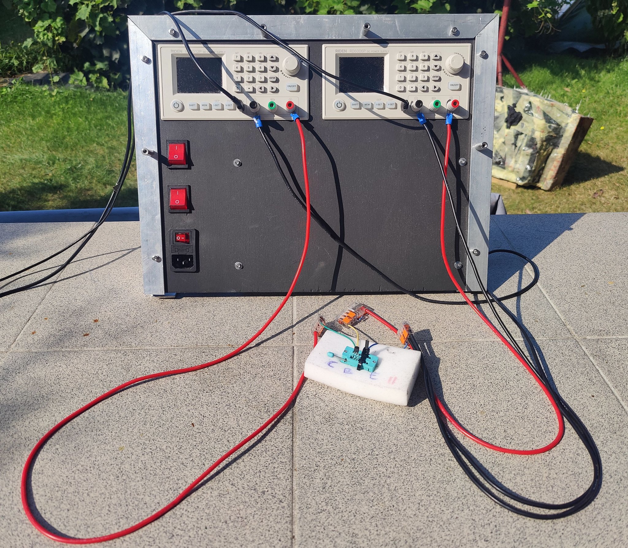

I was able to assemble “my” measurement jig which consists of the RD6006p and RD6012p. I’ve measured ~20 BC549c parts as per examples available on pypsucurvetrace site. But practically I don't know what I'm doing (more or less) 😊 … so I need help …
Step I’m stuck on is matching measured parts, I don’t understand syntax of curvematch command.
I’m using Windows, configuration went smoothly. My parts were prematched with PEAK DCA to 5hfe range (635-640), then measured with pypsucurvetrace. Configuration files are attached to this post, only change to “examples” is limited U1 to 15V (a bit faster measurements)
My questions:
1)How should curvematch syntax look like?
-Name of curvetrace output files: 1_1.dat -> 1_20.dat
-Files are located in C:\Users\ML_sd\
-How to limit U1range and I1range (maybe leave it as per configuration file? U1 1 to 15V; I1 0.5mA to 50mA)
-I don’t know what is –bjvbel; how to set it correctly?
curvematch –U1range [1,15] –I1range [0.001,0.05] –bjtvbe [???????????] datafiles [1_1.dat, 1_2.dat, 1_3.dat, 1_4.dat, 1_5.dat, 1_6.dat, 1_7.dat, 1_8.dat, 1_9.dat, 1_10.dat, 1_11.dat, 1_12.dat, 1_13.dat, 1_14.dat, 1_15.dat, 1_16.dat, 1_17.dat, 1_18.dat, 1_19.dat, 1_20.dat]
With above syntax I get result:
if i understand above correctly: sample 1_10 was picked as reference and compared to others samples? and last column is how close samples are matched?

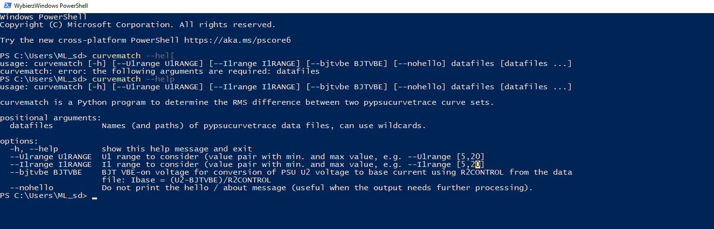

2) Curveplot
How to change units on Yaxis (to mA)

curvematch 1_1.dat, 1_2.dat, 1_3.dat, 1_4.dat, 1_5.dat, 1_6.dat, 1_7.dat, 1_8.dat, 1_9.dat, 1_10.dat, 1_11.dat, 1_12.dat, 1_13.dat, 1_14.dat, 1_15.dat, 1_16.dat, 1_17.dat, 1_18.dat, 1_19.dat, 1_20.dat
that shows proper results.. 🙂 what about rest 2-5?

I have no clue about Windows, but what about curvematch *.dat ?curvematch 1_1.dat, 1_2.dat, 1_3.dat, 1_4.dat, 1_5.dat, 1_6.dat, 1_7.dat, 1_8.dat, 1_9.dat, 1_10.dat, 1_11.dat, 1_12.dat, 1_13.dat, 1_14.dat, 1_15.dat, 1_16.dat, 1_17.dat, 1_18.dat, 1_19.dat, 1_20.dat
curveplot --help2) Curveplot

See here (scroll down to the BC550 example):-I don’t know what is –bjvbel; how to set it correctly?
https://pypsucurvetrace.readthedocs...mples.html#working-with-the-curveplot-program

this worksI have no clue about Windows, but what about curvematch *.dat ?
yea.. checked before asking; will read on morecurveplot --help

ok: how [PSU1] POLARITY option works? it switches PSU polarity or is it info for script to properly interpret results?
BC559 needs a negative Collector-Emitter voltage and a negative Base-Emitter voltage [...] connect the pins as follows:
PSU1-black to the Collector pin
PSU1-red to the Emitter pin and to PSU2-red
PSU2-black to the Base pin via the 100 kΩ
correct? or simply to invert POLARITY of PSUs?
thx.
The PSU hardware can't simply reverse the polarity. All you can do is to invert the connections to the DUT. The POLARITY option is simply there to tell PyPSU software what the polarity of the connections is.ok: how [PSU1] POLARITY option works? it switches PSU polarity or is it info for script to properly interpret results?
Looks alright to me.BC559 needs a negative Collector-Emitter voltage and a negative Base-Emitter voltage [...] connect the pins as follows:

I'm changing connections for BC559, so the [PSU1] POLARITY parameter should be left as is or should be changed (to what value).The POLARITY option is simply there to tell PyPSU software what the polarity of the connections is.
thanks for help!
POLARITY = 1 for normal (positive) polarityI'm changing connections for BC559, so the [PSU1] POLARITY parameter should be left as is or should be changed (to what value).
POLARITY = -1 for inverted (negative) polarity
