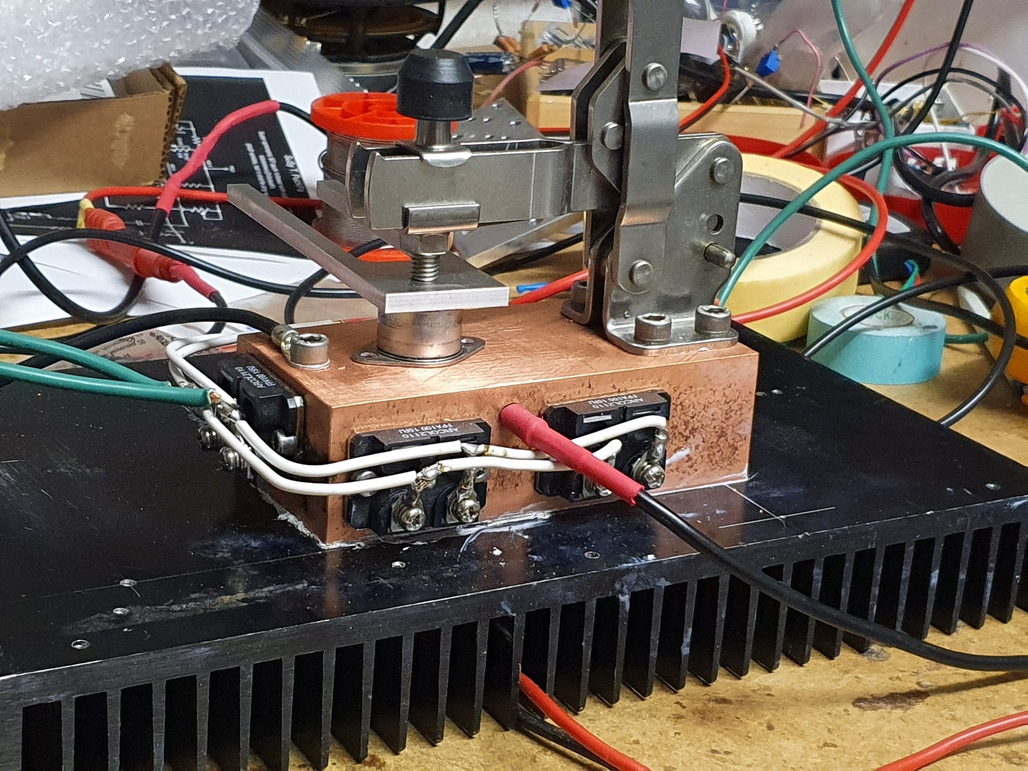

Yes, there is always some offset and hysteresis between the DUT temperature and the temperature reading inside the copper block. I minimized this by arranging the temperature sensor such that it sits immediately below the DUT. Also, copper has a pretty high heat conductance, so the sensor is thermally well connected to the DUT. The temperature reading is therefore quite close to the DUT temperature. In any case, the compression effects I saw before using the copper block are now completely gone.
Using a sample and hold would certainly work, but it would add more complexity and would take away the beauty of using just two programmable power supplies and nothing else. The whole idea was to make a curve tracer without any extra boards and stuff.
Yep. In fact, I could easily sink some heat and get it to below room temperature by using cold water flowing across the attached heatsink. I didn't have any need for this so far.If the copper block were liquid cooled then you could in principle raise and lower its temperature.
EDIT: I attached a photo of the whole thing, maybe that helps to understand how things work.

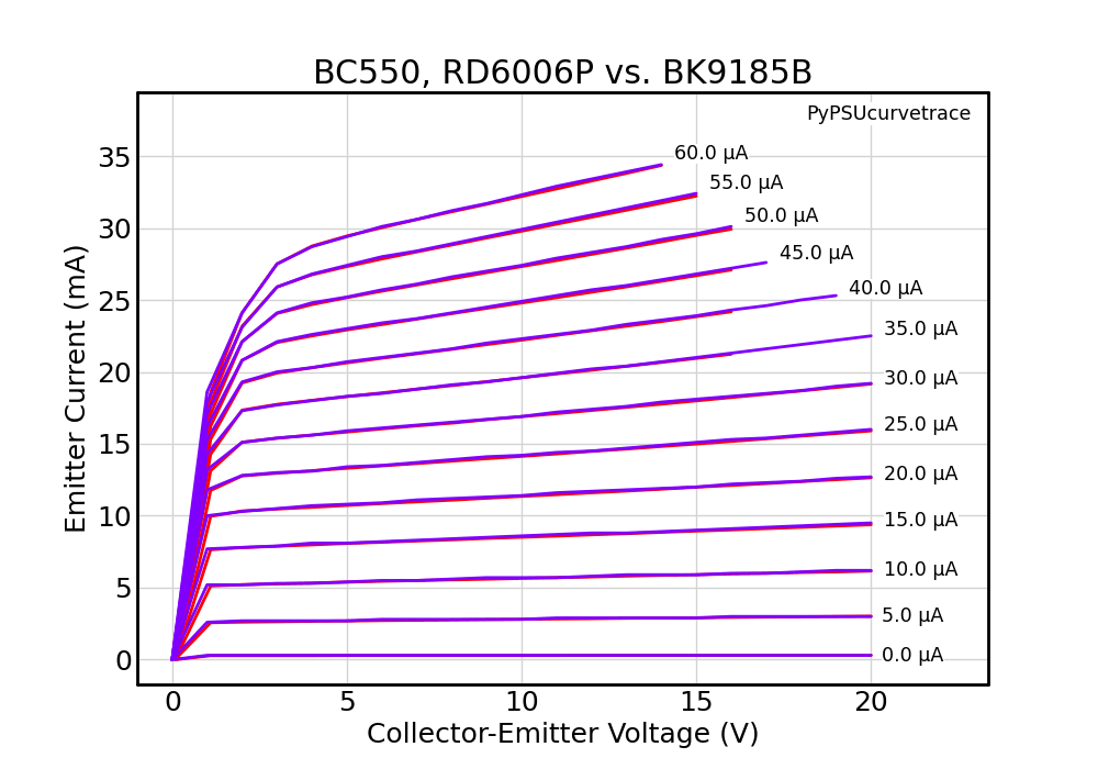

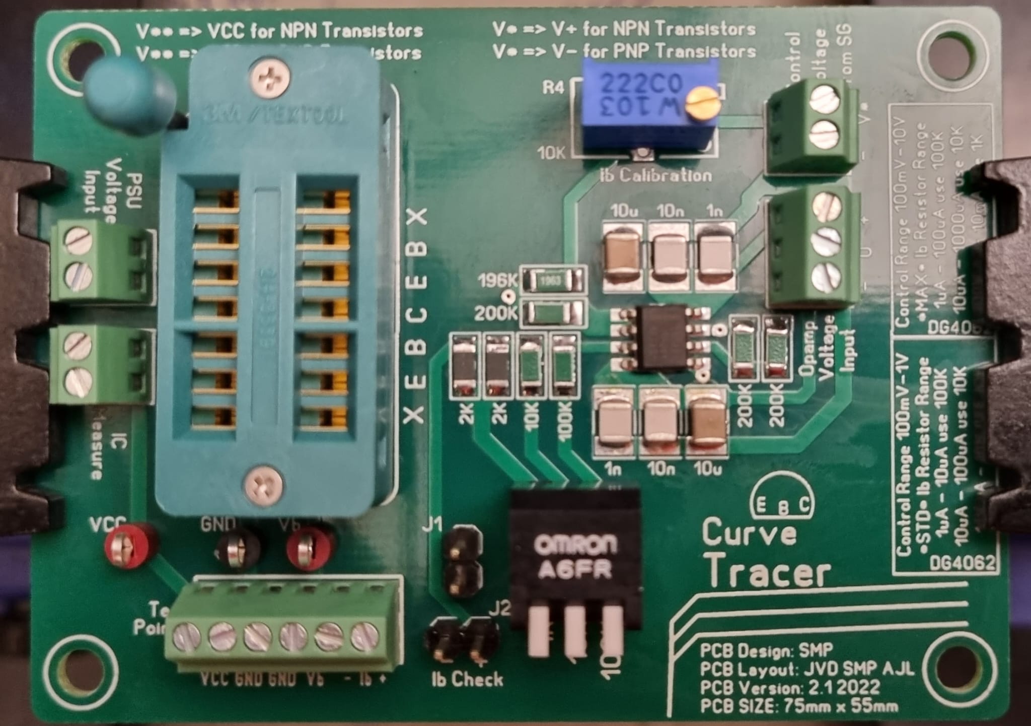

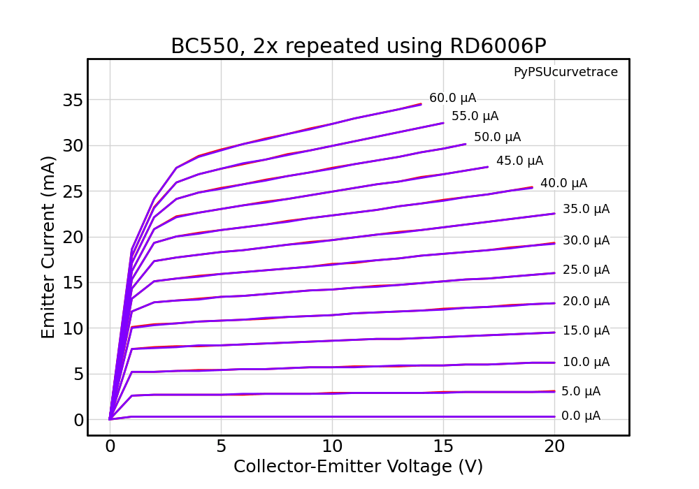

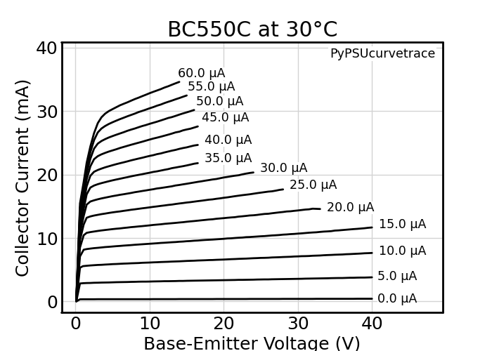

I realised that so far I have used PyPSUcurvetrace for FETs and tubes only, which are all voltage controlled. I gave it a shot with some BJTs that were floating around the garage and added a few options to the software to make it easier to deal with current-controlled parts. The attached curves from a BC550 shows that this works very nicely!

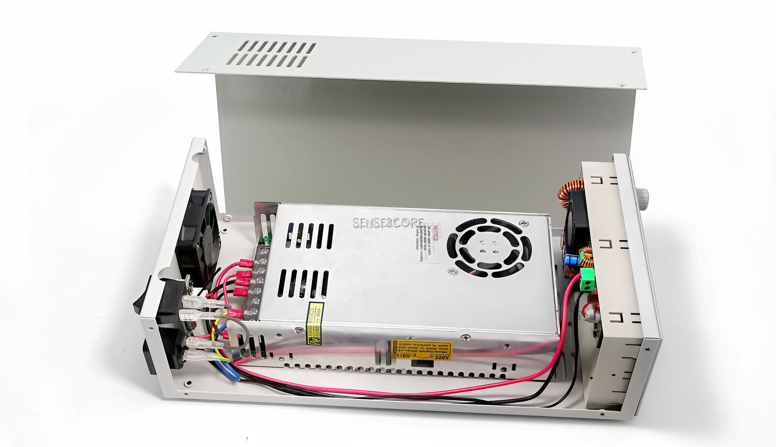

I got my hands on a Riden/Ruiden RD6006P power supply. These kit PSUs are relatively cheap, but provide 100 nA / 1 mV resolution from zero to 6 A / 60 V output. PyPSUcurvetrace already has experimental support for the RD power supplies! Once this is polished, the RD power supplies will allow a very powerful, precise, and flexible curvetracer setup for about $300 or less 😎
Oooops... that should have been 100 micro Amps, not nano Amps!I got my hands on a Riden/Ruiden RD6006P power supply. These kit PSUs are relatively cheap, but provide 100 nA / 1 mV resolution from zero to 6 A / 60 V output.

Where to get these Riden/Ruiden RD6006P?I got my hands on a Riden/Ruiden RD6006P power supply. These kit PSUs are relatively cheap, but provide 100 nA / 1 mV resolution from zero to 6 A / 60 V output. PyPSUcurvetrace already has experimental support for the RD power supplies! Once this is polished, the RD power supplies will allow a very powerful, precise, and flexible curvetracer setup for about $300 or less 😎

I got mine from bastelgarage.ch, but the Riden units are available from many different sellers. Google is your friend.Where to get these Riden/Ruiden RD6006P?

It is needed that part only?I got mine from bastelgarage.ch, but the Riden units are available from many different sellers. Google is your friend.
On ebay.it I found a seller that can supply it, but also can supply a metal case and a SMPS power supply for a complete working unit:
https://i.ebayimg.com/images/g/CP8AAOSwZIxg-mwm/s-l1600.jpg

The RIDEN units are modular. You can get just the main unit and take it from there, or you could also get the SMPS, case and fan (that's what I did).It is needed that part only?
