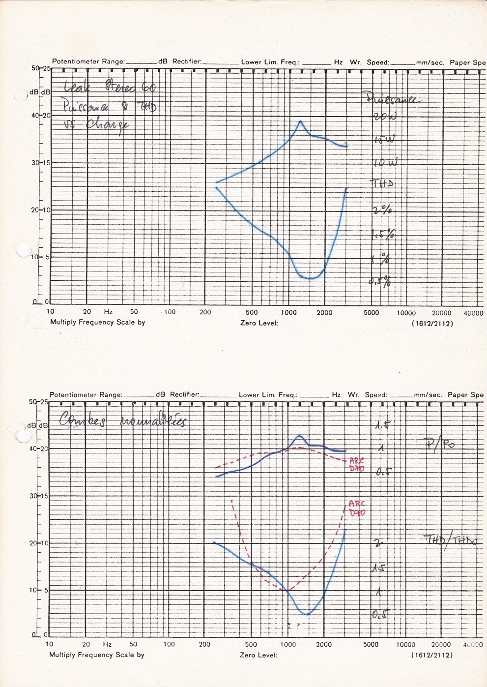

Here're some measurements I did long ago: you can see that, unsurprisingly, the Leak ST60 (blue) is not really optimized, whereas the ARC D70 is optimized for minimum THD @ rated impedance. The X axis is log Ohms... I think.

I completely agree with the statement, although I don't think I got the graphs right. Basically you are saying that the speaker impedance changes over the frequency. So the primary impedance of the OPT to the tubes also changes as the frequency changes (so called "playing music"), hence 99+% of the time when we are listening music, the tubes are off the load line that you think the tubes are on.Interesting to note that you don't really have to get the load line super right because the impedance of the speakers will certainly mess it up bad.

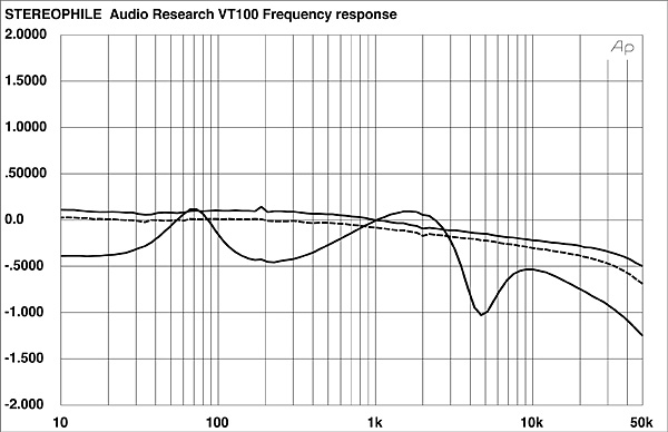

I guess that is why you just can't say anything about the quality of the amplifier from the datasheet or even the measurements using a dummy load or a fixed frequency sinusoidal signal. Probably this is a true statement "you just listen to it and you decide if you like it or not".

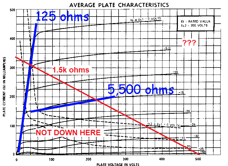

No.plate resistance specification. Doesn't that give you a good clue as to what load impedance might work well for it?

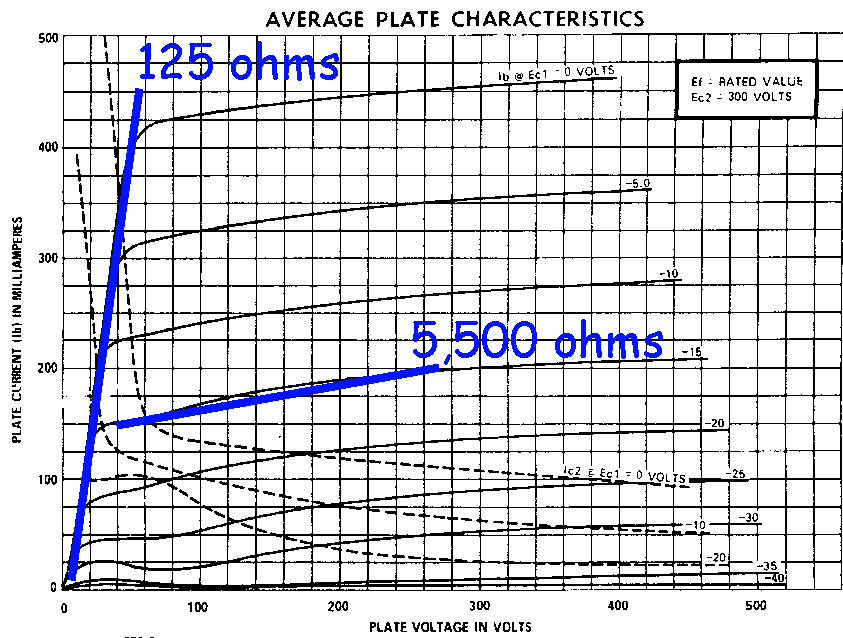

A pentode is a 2-slope device. The usual plate resistance is the horizontal part, very high impedance. Just as important for Power is the vertical part, a few hundred ohms. Ignoring limits, you can run almost anywhere between these two slopes; getting different powers.
Me neither, 40+ years is a long time... I don't think I got the graphs right....
The X-axis is Ohms x 0.01, so 1000 is 10 Ohms.
Think of the load line as a target that you want to be statistically close to. The real “dynamic” load line is elliptical anyway, because of speaker reactance. But in practice that doesn’t hurt things as badly as it does with transistor amps (transistor amps tend to blow up or go into very nasty sounding limiting modes unless you oversize the hell out of the output stage). If you plot it with a music signal containing a wide spectrum it looks like a hair ball, stretched out as sloped through where you would expect it to be. The more widely your speakers vary in impedance, the more “extra” current capacity you need to design for. The hair ball gets fatter and slopes up a bit more. Extra current capacity in tube amps is not free - it costs heater power and screen dissipation which must be managed.I completely agree with the statement, although I don't think I got the graphs right. Basically you are saying that the speaker impedance changes over the frequency. So the primary impedance of the OPT to the tubes also changes as the frequency changes (so called "playing music"), hence 99+% of the time when we are listening music, the tubes are off the load line that you think the tubes are on.
You mention the "horizontal part". Of what, please? Of the pentode plate curves? So the "horizontal part" is plate voltage (x axis), and the "vertical part" is plate current, the y axis?

slopes of the curves, 5500 ohms is (270-40)/(.2-.15) = 230/0.05 = 4600 ohms , missed?

Start with a transformer that is:
Push Pull 4k plate to plate and with a center tap, to an 8 Ohm tap that is loaded by an 8 Ohm non-inductive resistor:
1/2 winding = 1k Ohm (one plate connection to the center tap). The other 1/2 winding is the same, 1k Ohm.
But . . .
In Class A, each tube is On, and each tube is Aiding each other. So each tube sees a 2k load.
In Class B, only one tube is on, so they do Not aid each other. So each tube sees a 1k load.
In Class AB1:
Sometimes both tubes are On (each tube sees a 2k load).
Sometimes only one tube is On (each tube sees a 1k load).
When the tubes are in transition from one state to the other, the load impedance is between 2k and 1k.
Simple, straightforward, yet quite complex.
I hope that makes it clear, and makes it memorable.
Have fun deciding what operating Class you want to use.

So I can understand what's going on with triodes. But what about choosing the primary impedance for a pair of pentodes?
What I'm having trouble with is what PRR posted in post #25, after I'd asked whether the plate resistance (rp) specification of a pentode would give you a good indication of what OPT primary impedance to choose for it.
PRR posted this graph to explain:
When I posted that I didn't understand what the graph is showing,
I see the vertical slope alongside the y axis is labeled with 125 ohms and the horizontal slope alongside the x axis is labeled 5.500 ohms. But I don't understand the significance of that. Is that 125 ohm line a second kind of load line?
PRR wrote:
No.
TonyTecson replied:
