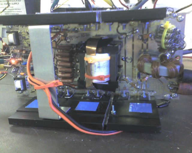

i have a few hours today and i am going to play with it, i rewound it with much difficulty and put it in my pcb. so we'll see what other issues come up.
i was thinking toroid but i am not sure about the coupling or if it would be simpler
i was thinking about wire bundles on the etd59 but i thought the windings might be to large to go around figuring at 500 mils per amp at 50 amps would need 25000 sq mils using say 24 or 26 gauge wire would need 65 wires in a bundle. the winding in one layer the etd59 has 1.625" of core length and about 0.25" space between the core bobbin and the core legs. blue sec, red primary.
so thats why i thought foil, which barely fit between the legs and the bobbin.

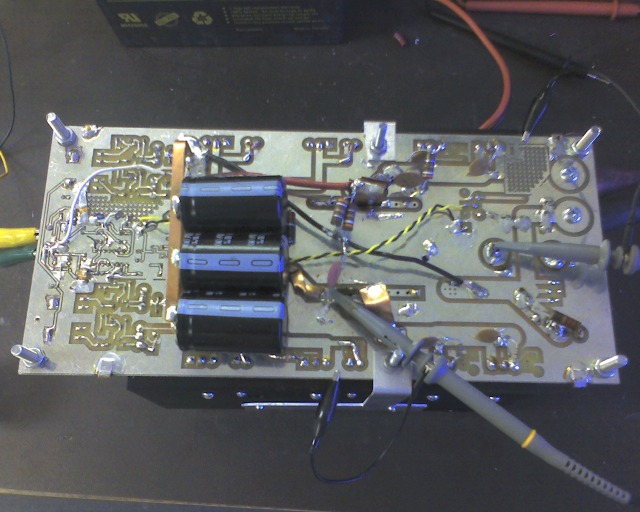

Where is the ground clip of the scope connected?
Do you have a picture of the setup and/or a PCB layout? What is the value of R1, R19, R4, R20? What does the gate drive waveforms look like?
ground clips a connected to the ground plane near the transformer.
r1,19,4,20 are 1k.
the circuit is a bit messy.
but has come a long way. i have started working on a second board layout that has better ground plane that is connected dozens of places and power traces on one side instead of both sides. the control traces on one side ground plane on the other the output caps on the board multi for low esr.
the series caps ar bypassed at this point i need more capacity than 7uf
i had droop on the switching. so i bypassed it and it squared up. i want them in eventually
the bulk caps might be too big 63v @ 10,000uf (3) black ones

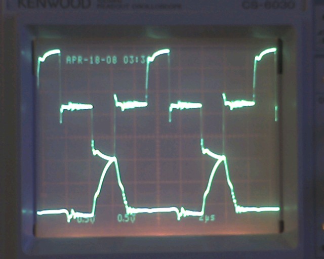

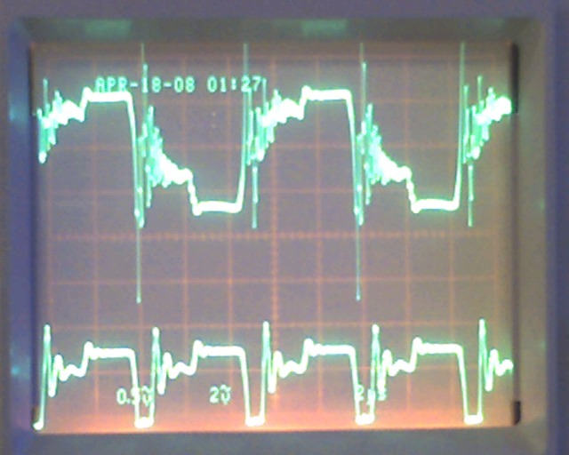

the top one is the output from the gate drive transformer
the bottom is the junction of r2, d5, q1(b), and d5,q1(e),r3 and q3(g)
i had a concern about this but the knee is 5 v then on up to over 10 (sharks fin)
i want to make sure it is not on in the linear portion
the main transistors are fair child HUF75652G3 75a 100v 0.008ohm
to-247 http://www.fairchildsemi.com/pf/HU/HUF75652G3.html which show a low Qc and around 4v on threshold......
the sync is off i think i have to figue out how to delay so the traces sync.
if any of this stuff is wrong i'll try whatever.

Isn't Q3 an upper side transistor? Is it measured without bus voltage or did you use a differential connection? The rise and fall time is worrying and not good for high power. Those transistors you use will need very sturdy gate drive to give acceptable performance. The datasheet suggests a 2 ohm gate resistor and the rise and fall times still suck with that, though they will be better than stated at 13V than 50V supply.
It might be possible to remove R3 and the corresponding resistor in all cells and decrease the value of all R2:s. The dischare resistors will probably need to be decreased too. The gate drive transformers will need to have low leakage inductance. Another transformer possibility is driving the low-side transistors directly from the gate drive chips and using a trifilar wound transformer for the upper ones. You could also use 30V or 50V transistors instead and get much easier to drive gates for the same on resistance.
The ringing looks a bit erratic as it is now but this should be because of the discontinous mode. The spikes going beyond supply voltage suggests there are too much inductance in the circuit between transistors and bulk caps though.

on the new circuit board i have moved around the bulk caps closer to the transisitors. and am thinking about not having a ground plane above the high current traces.
i could parallel to220 transistors.
just for fun i went to 0.7 ohm load and the out put voltage dropped to 9 volts @ 14 amps and the input went to 13 volts at 21 amps. so it doesn't keep up. yet.....i wonder if i could parallel 2 20 amp smps.
if my approach i can change it or frequency, i don't need to tread into unknown territory if it not technically possible..

well i am back for a week, and i was looking at voltage drops across pcb traces. and after out last discussion the traces at that frequency do no have enough surface area. 0.5"x0.002".
and the transformer straps from the transformer windings are also too small, 0.5"x0.016".
they would need to also be about 1.5" wide a this current level and freq.
after reading the ti information, i am going to pull the transformer and rewind one with litz wire in the traditional manner so i can come out with the litz wire directly to the transistors n rectifiers without the traces.(I will scrape off the traces) . the 'litz' wire is really 105 wires of number 36 enameled wire.
i will also change the gate transistors to 2 ohms.
i will change the 1k ohm gate turn off resistor to oh........270 or less and watch the effect on the gate turn off.............
