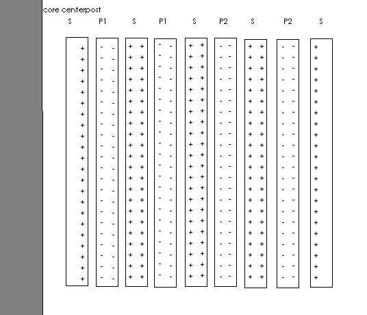

so what is the proper way for interleaving?
chryssis says two secondaries and one primary, brown says two primaries and one secondary and pressman says 2 primaries and two secondaries.
i am going to rewind tomorrow but?😕
ok time for mind loss.....
Are you happy with the 2:5 turn relationship? Are 2 turns enough to give reasonable core losses at highest output voltage?
The primary in the middle would be best so you can get the least number of layers in the secondary. Do you have thinner foil? 40 mil foil will give high losses if more than one layer is used. 8 mils is about the best that can be used with a S-P-S layout. Any thicker and the secondary losses will increase a lot due to proximity effect. I'm worried though that 8 mil foil won't be enough for the power you want.
S-P1-S-P1-S-P2-S-P2-S would be much better and I recommend that. With this configuration you won't have a problem with proximity effect losses. Both sides of most turns can be used so 16-20 mil foil would be best here. Thicker would work too but won't reduce the losses much, if at all. The two primaries would be parallelled.

megajocke said:Are you happy with the 2:5 turn relationship? Are 2 turns enough to give reasonable core losses at highest output voltage?

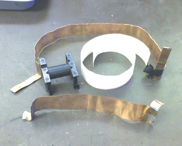

i am using a etd59 (i know i said etd 49 earlier) full bridge.
i do have 10mil, 16 mil and 40 mil foil.
i planned on about 500mil per amp.
i used about 1500g for my calculation for primary turns. would like to use less on the secondary but i am not sure the voltage/ will make it. in theory land 2:3 turns should do it but....
do you have a reality suggestion for pri turns?
running from 12v batteries i planned for a 1 volt loss to the transistors at a low of 10v , when the battery is about dead. to get about 15 volts @ 40 amp to the motor after the rectifier loss inductor relay and wire losses on the load side.
i would like at least 70 percent 80 would be best. i/o efficiency.

What is your freq and power? 50KHz-100Khz use only 8-10 mil foil. Anything higher only increases your ac resistance due to prox losses, regardless of winding geometry.
The interleaving that megajocke suggested looks pretty good.

If the primary and secondary are interleaved like S-P1-S-P1-S-P2-S-P2-S then there will be only half a turn per portion so 16 mil foil or a bit thicker can (and should) be used. 🙂 The outer turns on the secondary will only have 8 mils used for conduction though.
If done like SS-PP-SSS then you are right that thinner foil should be used. This probably won't do at the power he want's though.

100khz, i have tyvek transformer insulation about 6 mils
also i have only one sec output so .
also calc'd 1 turn but for step up ratio i opted for 2 on the primary so my step up will be 2.5 ish.
so if i use 16mil say, spsps or spsp?

spsps will be better but this will just be 1.5 times step up. (or 3 times if the primary turns are parallelled which should work if you want 3 times and the core losses aren't too high like this) If you do spspspsps you will get the 2.5 times step up.

Ooo. Fields are split, my mistake. Yes for the ones in the middle it would be double and the outer ones (of P1, P2) 8 mil will suffice.
Yeah, but it won't hurt either having them 16 mils all the way. Should be easier to wind that way not having to join 8 mil foil onto the ends. The whole secondary can be one long strip.

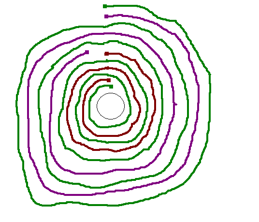

The picture shows how it could be done if seen from the side of the core. Green is secondary, red and purple are the primaries that are to be parallelled. Secondary and primary leadouts should be on the same side of the core or else there will be some portions with 2 layers which is not very good for the losses.

i am not understanding how you are getting the step up. i may have a major misunderstanding in winding with foil.
i wound the secondary five turns and brought out strips then wound 2 turns and brought out strips from the turns.
i thought then i should run another secondary over those and parallel them.
sp vs sps, however i think i do not under stand how you are stepping up 2.5 by parallelling spspspsps ?
Look at that spiraly thing I made and I think it should be clear. (If you don't get dizzy) 😉 There are one five turn secondary (green) and two two turn primaries. (red, violet)
If wound sssss-pp-sssss like you suggest only 8 mils of thickness of the primary turns will be used. The outer 8 mils of each secondary turn except the outermost ones will have current flowing in different directions. Say 1A is flowing through each 5 turn secondary: The outer turn will have 1A flowing in the inner 8 mils. The turn inside of that will have 2A flowing on its inside and 1A flowing in the _wrong_ direction on the outside. The turn closest to the primary will have 5A flowing in the right direction and 4A flowing in the wrong direction! Losses will be insane! 😱

i paralleling the primaries the inner most of each primary will be connected together and the outer most of each will be connected together.
the phasing for the pri to sec is not important?
i think i will use 8 mil for each pri and 16 mil for the sec.
