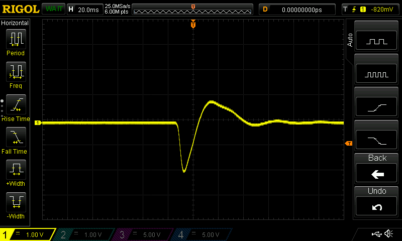

THAT.Here's me doing a quick test. 🙂
My oscilloscope connected directly to an old 10" woofer and me rapping the dust cap with my knuckle. (ie, the cone moving inward (toward the frame) with my rap.)

Induced movement is very small as you can imagine, would need a microscope to clearly see and measure it with my eyes or shine a thin beam laser diode just tangential to dome and a photodiode at the other side, again to measure it, but I have DEFINITELY confirmed by experiment that:
1) pushing cone backwards generates a negative voltage (as I mentioned above). <-- experimental fact.
2) that a negative voltage applied to secondary/passive speaker makes it go backward. <--- experimental fact
now add 1+2.
Part of experimental conditions is that both speakers are in parallel and in phase, of course.
And that speakers are closer than, say, 3400 km, so voltage at one pair of terminals can be considered simultaneous with that present on the other pair within 1% error.
Two 6.5" woofers wired in parallel.
Push one woofer in, the other moves out. However you need to quickly push ~10mm in to get ~2mm out of the other. One acts like a generator (speed and distance are important) and other acts like an inefficient motor. This electrical movement is minor compared to an inter-chamber air leak which nearly 1:1.
Connecting a low impedance path between them (amplifier, green wire, short, etc), stops the motion completely.
I'll have to update my conclusions on this one (sheepishly 😳). It only optically appears that the 2nd cone is moving out, however this is a bit of an illusion.
I connected a scope and reworked my experiment to just push and hold driver#1 and set a physical edge to driver#2. The scope definitely shows an initial negative pulse across the terminals and that does pull driver#2 down slowly, However, as soon as driver#1 stops moving, it causes driver#2 suspension to return to the null position (overshoots actually) and it does appears that it moved out because the return movement is faster and more pronounced. It's a tricky thing to separate.
