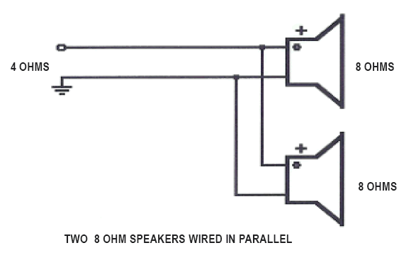

It may help to draw a schematic of the circuit. Maybe label the terminals on a speaker as red and black, or whatever. Then just work out the problem. One is a generator and the other is a load.

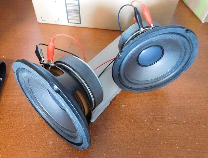

Two 6.5" woofers wired in parallel.

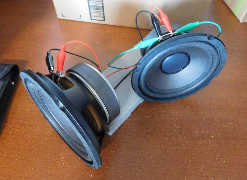

Push one woofer in, the other moves out. However you need to quickly push ~10mm in to get ~2mm out of the other. One acts like a generator (speed and distance are important) and other acts like an inefficient motor. This electrical movement is minor compared to an inter-chamber air leak which nearly 1:1.
Connecting a low impedance path between them (amplifier, green wire, short, etc), stops the motion completely.

A diagram (as I suggested in post #2) may help visualise this:
If the cone of the top driver is pushed inwards, an EMF is induced which opposes the cone movement.
Think of that EMF as being directed in the opposite direction to the cone movement, i.e., 'outwards'.
The bottom cone will then be subject to this 'outwards' EMF, so will move outwards, i.e., in the opposite direction to the top cone.
This explanation would certainly be in line with DonVK's experimental results.
