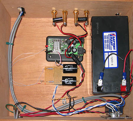

So here is an image of the JW Miller coil as compared to the stock coil on the Sonic Board.
You'll see the toroid on the right, stock coil in the center, stock coil uncovered on the right.
Hope that helps.
Oh yes, you will have to enlarge the holes in the PCB slightly to get the new coil leads in.

Hmm.. Or thin the leads on the coils

Hi All,
As an aside, I was using cheap Radio Shack non-polar electrolytic 4.7uF caps in my input circuit, in series with cheap RS 22k resistors.
I then replaced the input circuit with 22k metal oxides and 3.0 uF Solen Poly caps (wasn't ready to go Auricap just yet). I also managed to fry my board in the process, and for the life of me can't figure out how. No solder splatter, no soldering on the board (I have a second external board for the input circuits). My best guess is that the wrapping wire I used to connect to the SI board somehow shorted when I reapplied power ( the exposed wire length at the board end was very short, however...).
Anyway, I re-installed the new caps and resistors on my second SI, which was identically set up. I found I had clearly smoother midrange and upper bass with the new caps, resistors, and board. Unfortunately, it's not a valid finding since I switched amp boards too, but I suspect using large audio-grade poly/foil caps on the input circuit is the way to go IF you have the room for them.
Also, there was a noticably quieter power-up pop with the 3.0 vs the 4.7. The pop accompanying the 4.7 is about as loud as I'd want to go with efficient speakers.

Hi All,
Hi shelt,
can you email me a bigger pics. of your SI Mod.? The one on the threat is a little small. Thanks!
