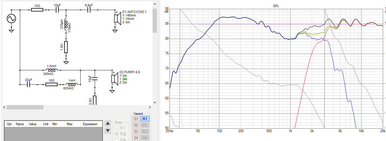

I'm going to be building the SPK5 kit for starters before trying it out in something maybe floorstanding later on, has anyone else tried to model that crossover? I get this, was only using spl trace of data from hificompass so probably way off and will get measurements of the drivers in the box when its built.
The hificompass measurememt is on a wider test baffel so you are missing the baffelstep in your simulation.

My SPK5 PDF shows a 22uF cap where you have 10uF.... has anyone else tried to model that crossover? I get this, was only using spl trace of data from hificompass so probably way off and will get measurements of the drivers in the box when its built.![]()
See the newer v1.10 PDF on the website
