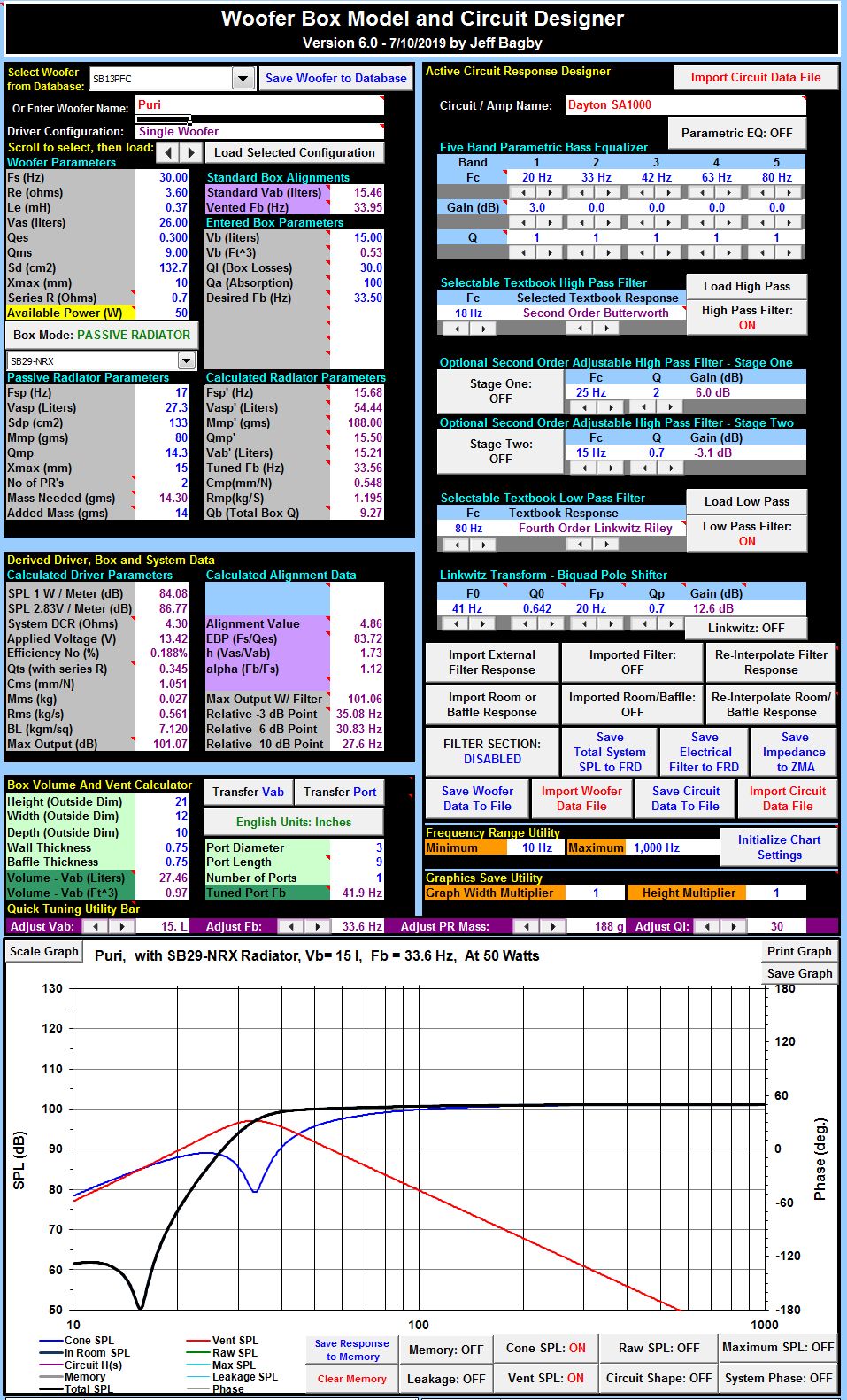

I was modelling the woofer and PR with Jeff Bagby's Woofer Box Model and Circuit Designer, and it looks like you would need two PR's per box?
Generally two PR’s of the same diameter as the driver are required assuming stroke of PR’s is same as driver.
Just a small correction - volume of that vent (tube) is only 1 liter (approx).The volume of a 57mm x 360mm long vent is about 3.7L, a significant amount of that 15L box, which now needs to be an 18L box.
