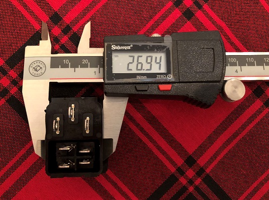

Did you consider using a file to add more clearance? Or a Dremel tool?
It was a really tight fit, but I was able to get my mine in place by just pushing on it really hard with my thumbs. If that didn't work I probably would have used a file to gently widen the case opening.
I'd thought of a file/dremel/sandpaper, but really didn't want to get into modifying the chassis or the AC inlet. I emailed Ghent and his response was simply to push harder.
Since I've already scraped up one of the AC inlets trying to force it in, I guess I'll lightly sand both sides, shaving off 0.1mm from each side shouldn't be too hard.

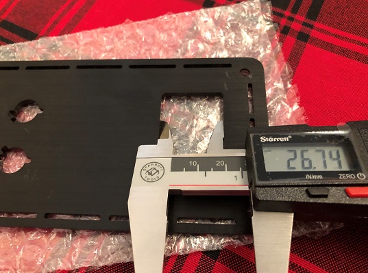

Richard,
Thanks for your excellent instructions. I am working on a pair of IcePower 1000ASP in Ghent GK-ASP-MXR cases build, and have run into an issue inserting the AC power inlets into the rear panel, seems that your did too.
The opening on the rear panel is 26.74mm wide.
The AC inlet is 26.94mm wide.
I've tried forcing it, using way more force than I think I should, and it still won't go. I've tried heating the panel in the sun and cooling the inlet in the freezer, it went about halfway in and was scraping plastic off the sides of the AC inlet.
Anyone have any other ideas?

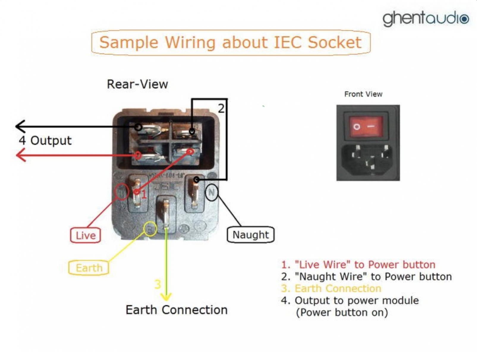

It does appear that Ghent is shipping a different IUC piece now. It may be worth updating the instructions with this picture from their website which shows how to run the jumpers.
I'll test the LS50 Metas on them tomorrow night.
franklyspeaking. Good of you to post the wiring diagram for the new IUC unit which appears on Ghent's website. I had mentioned this to Richard in my Feb 17 posting. The website has also ungraded the picture of the wiring harness with clear descriptions of each of the wires including the little jumper which is to be used on the power supply unit for conversion from 220 volts to 110 volts.
With these new pictures/diagrams and Richard's excellent instructions, installation should be even more straight-forward.

Just build one. Thx for the efforts Richi.
Some feedback.
The power socket changed as somebody mentioned earlier. That's the most critical part of all! Not good that it is not described.
The harness therefore also changed.
There's also a new 110V/220V jumper.
You get confused if you open the doc and find a different set of cables.
The problem.
You need to know that you find the latest info on the Ghent page. Because even Ghent himself refers to the no longer accurate build instructions over here.
It's really not that easy to get the wires and jumper attached to the power socket.
First of, make sure to follow the separate wiring images on Ghent audio!
Then you really have to make sure the wires sit tight. It happened to me that one came off,
even though I thought I was done with it. While doing it you also have to make sure not to break anything!

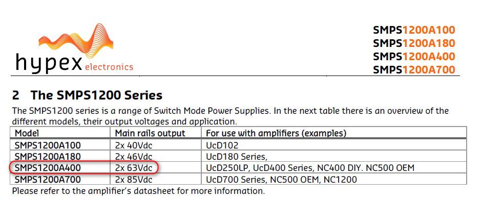

Good afternoon. You used SMPS1200A400 , what happens if you install SMPS1200A700 ? Thank you.
"Good afternoon. You used SMPS1200A400 , what happens if you install SMPS1200A700 ? Thank you. "Добрый день. Вы использовали SMPS1200A400 , что произойдет, если вы поставите SMPS1200A700 ? Спасибо.

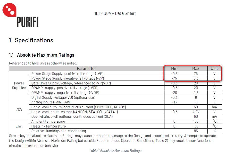

Using SMPS1200A700 with +/- 85V is NOT be a good idea with the Purifi 1ET400A with absolute maximum of +/- 75V.
https://www.hypex.nl/product/smps1200a700/137https://purifi-audio.com/eigentakt/

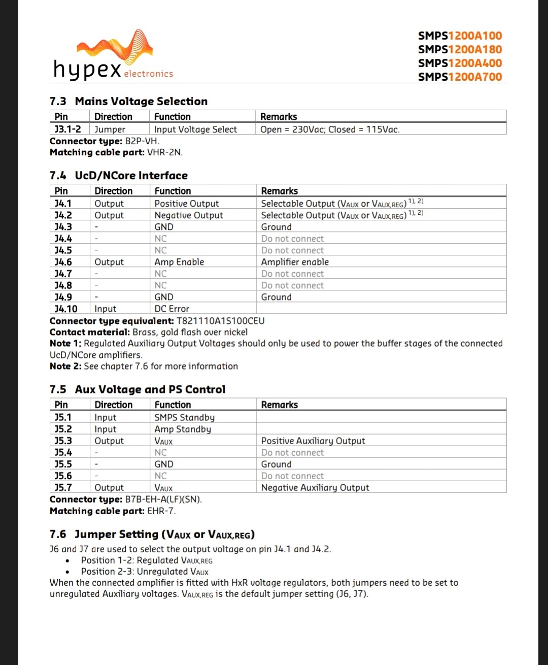

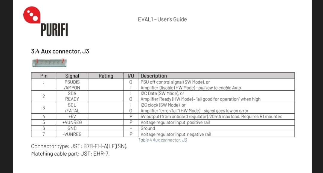

Hello,
I am interested in buying the eval1 kit plus hypex ps from Europe, but without the case as it is quite expensive, almost plus 50%.
https://www.soundimports.eu/en/purifi-eval1.html
I don't know if they provide the right aux cable to connect the purifi kit and the ps. In their supply it looks the cable is different.
https://www.soundimports.eu/en/soundimpress-pu400-2ch-kit.html
I don't even know if I understand correctly what does what.
Is it switch, aux power or both ? A regular connector would not work, right?

I got more information from the purifi site itself.
I don't know why they don't provide a power cable already made and why we shall have to finish the building of the cable
