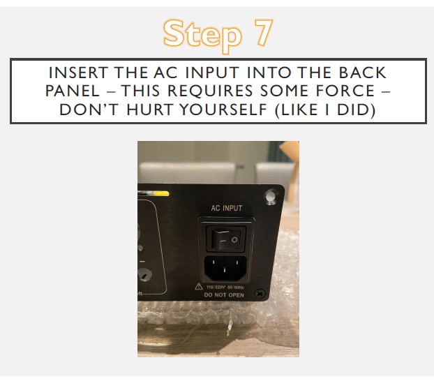

Hi Richard,
First of all, thank you for your excellent instructions which gave me the courage to try my first diy attempt to build the Purifi Eval-1 kit. I have some comments and questions and would be grateful for your guidance.
1. Ghent seems to have change the AC inlet from the one shown in your Step 12 (see the wiring diagram pictured in Ghent's website on the purifi casing). An additional pair of short jumpers was also included in the wiring harness I received, presumably to satisfied the new inlet configuration. Fortunately, the wiring instructions are not too difficult to follow. You may want to put an addendum in your excellent instructions on this.
2. Ghent also supplied a new part, a curious small speakon plug-inwith a little wire jumper inserted. Would you be able to advise what this is for please?
3. The purifi eval-1 module has an on/off switch sticking out from the rear. What is the function of this switch since the AC inlet also has a on/off switch please?
Appreciate your kind guidance. Thank you.
Richard, just wish to thank you for the excellent guide! Just assembled mine. Do you know if ALL Ghent supplied power cables are incorrect or just a small batch?
Hi Soulfood,
My apologies for the late reply, but I can't get the notifications to work on this forum. 🙁
Re your questions:
1. Putting an addendum in will be hard for me not having seen the other AC inlet that Ghent apparently supplies now with the case. Maybe you can share some pictures of the correct wiring and I will include it into the manual.
2. Same as 1, but if anyone can provide me with some pictures I will update the manual.
3. The 'on/off switch' sticking out of the rear of the EVAL1 board, is actually the standby switch S1. More information can be found in the EVAL1 user guide: https://purifi-audio.com/wp-content/uploads/2020/09/EVAL1-Users-Guide-1.25.pdf
BR,
Richard
Re your questions:
BR,
Richard

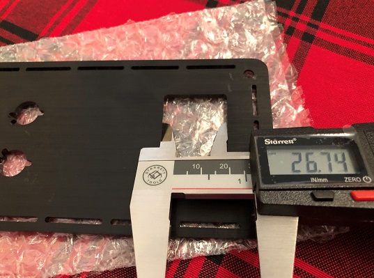

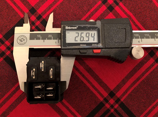

Richard,
Thanks for your excellent instructions. I am working on a pair of IcePower 1000ASP in Ghent GK-ASP-MXR cases build, and have run into an issue inserting the AC power inlets into the rear panel, seems that your did too.
The opening on the rear panel is 26.74mm wide.
The AC inlet is 26.94mm wide.
I've tried forcing it, using way more force than I think I should, and it still won't go. I've tried heating the panel in the sun and cooling the inlet in the freezer, it went about halfway in and was scraping plastic off the sides of the AC inlet.
Anyone have any other ideas?

....I've tried forcing it, using way more force than I think I should, and it still won't go. I've tried heating the panel in the sun and cooling the inlet in the freezer, it went about halfway in and was scraping plastic off the sides of the AC inlet.
Did you consider using a file to add more clearance? Or a Dremel tool?
