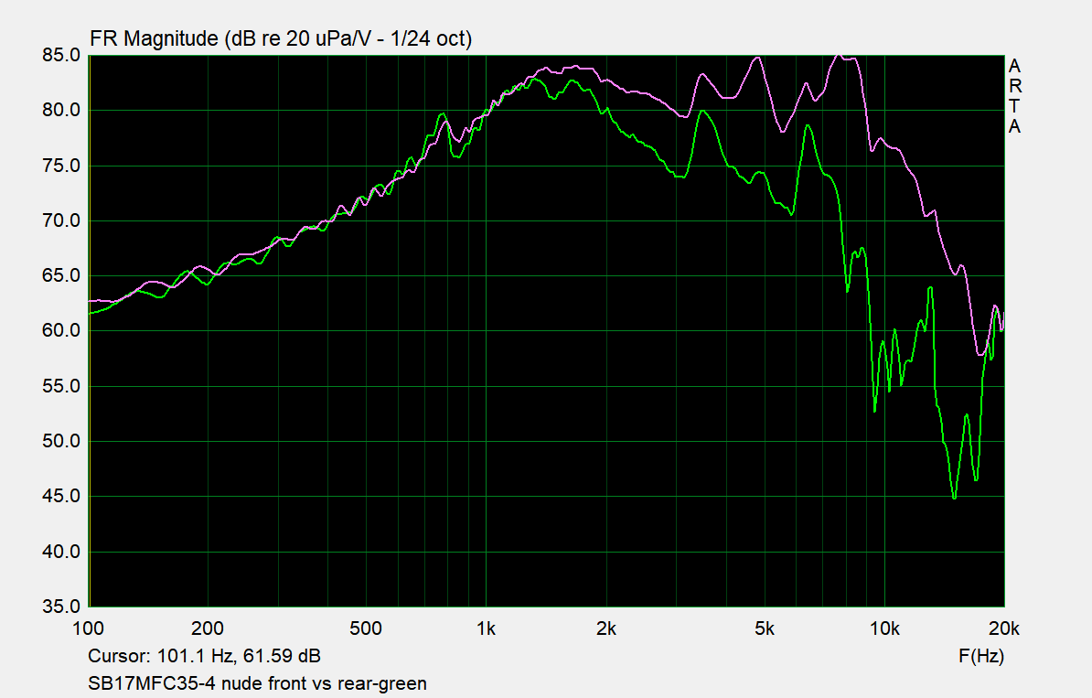

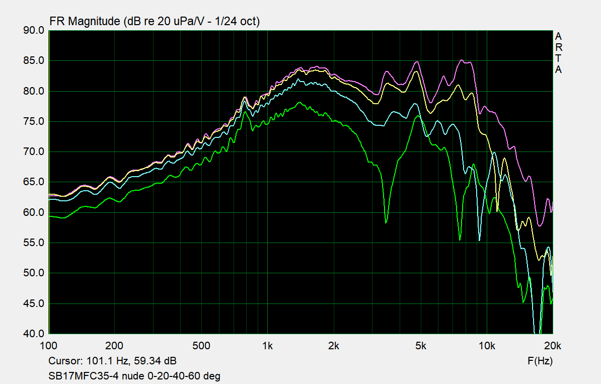

There is ONE cone type driver that I have found can be used above 2kHz, and that is the SB Acoustics SB17MFC. I have attached the front response (with a nude driver mounting). I can't find a similar multi-axis plot of the responses measured at the rear, but I attached the on-axis comparison of front and rear. To the rear there is only a gentle downslope above 1.5kHz compared to in front, which is no big deal.
As you can see from the front response measurements, the dipole peak is smooth and broad and the usable response extends up to just over 3kHz before you reach the first breakup peak, which isn't all that large. If you use a steep crossover and knock down the breakup peaks using DSP you can cross over above 2kHz.
