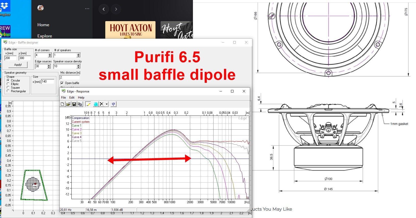

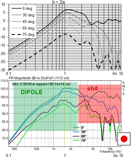

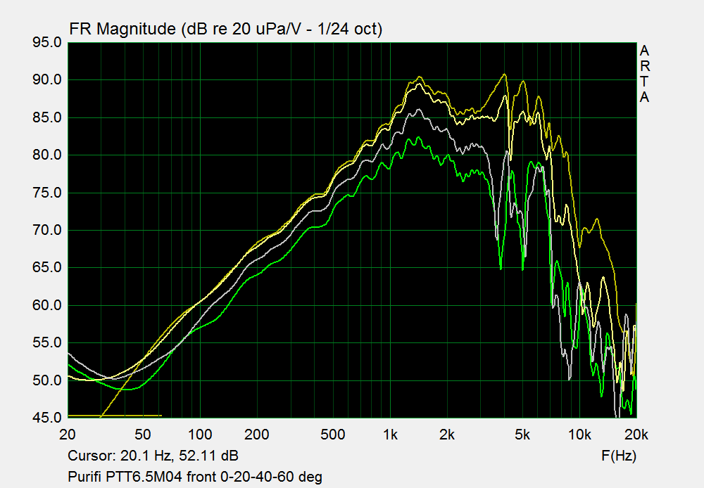

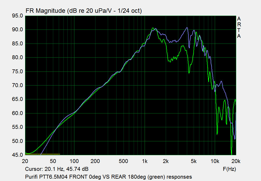

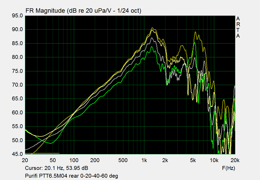

The reason has been mentioned before. The Purifi drivers ( even the 4 inch version) will most probably not have a similar radiation pattern on front and backside higher than 1.x kHz due to the big magnets, which work like an HP filter for the backside.
So if you want to achieve an overall similar radiation pattern for front and backside without using an additional (Non-Purifi) driver, you have to crossover lower than the frequency, where front and backside diverge.

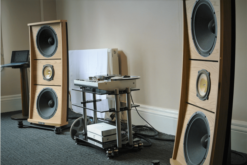

In my current system, a Purifi driver could fill the gap between my Acoustic Elegance Dipole 18 and the Scanspeak 12MU, somewhere between 200Hz (or lower) and 1000 Hz.
Dipole 18 - Purifi PTT6.5 or 8 - Scanspeak 12MU - Mundorf 25D1.1 …. … not to bad as well 😊

And a noob question. What makes these drivers less equal in front and rear radiation? Small-ish driver with large structure/magnets in rear or something else?

Its from my point of view e.g. the magnet, the spider, the basket.
Everything can influence the frequency response, as this components impede the sound radiation, and they typically do that more at the higher frequencies.
Probably also the cone shape has influence on radiation pattern differences between front and back.
But may be here are some experts, who have more experience with that than I have.

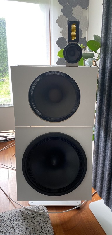

Out of your list I have had the ESS Heil AMT, the Dayton AMT4pro and the Beyma TPL150 and believe me, they are all very good tweeters but just like Hans555 said, in the end none of them blend in very well in an open baffle design because of their excessive vertical beaming. Their vertical response is as narrow as 20 degrees or less.
Out of curiosity, how did you end up using your AMTs (assuming you are)? The vertical radiation mismatch will be there with almost any other solution tpo, so what would you think would make the case in an OB application worse?
