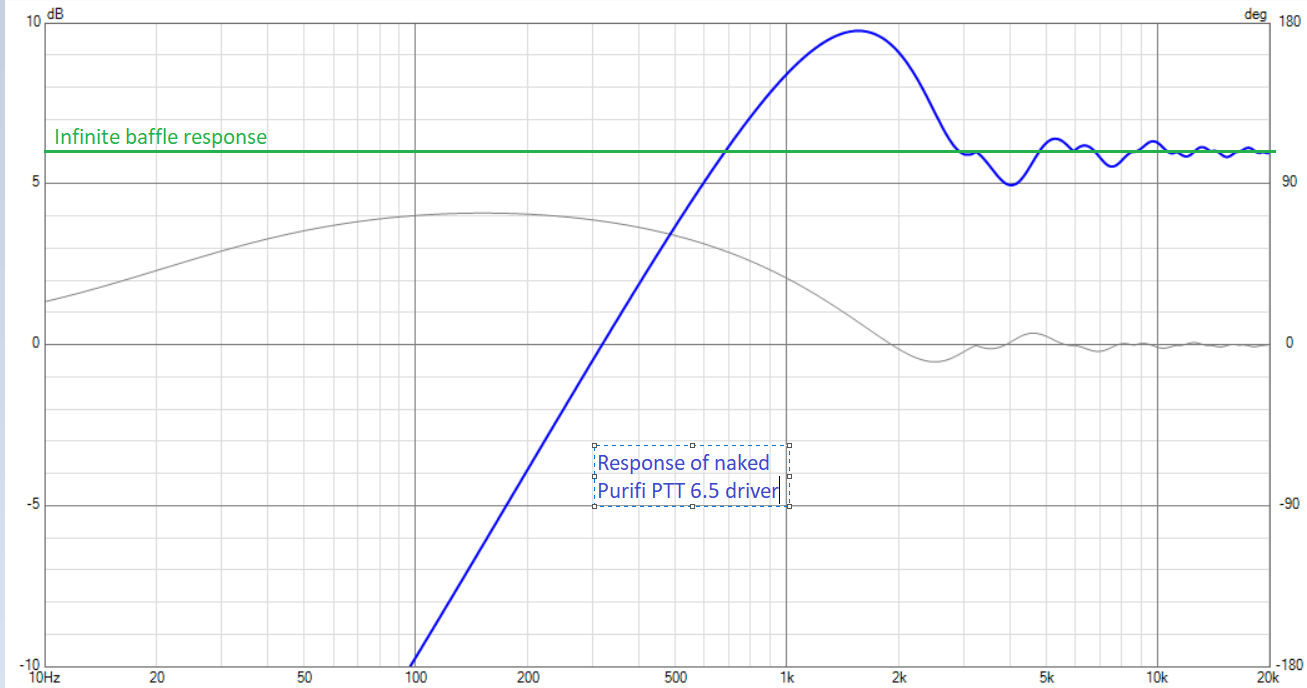

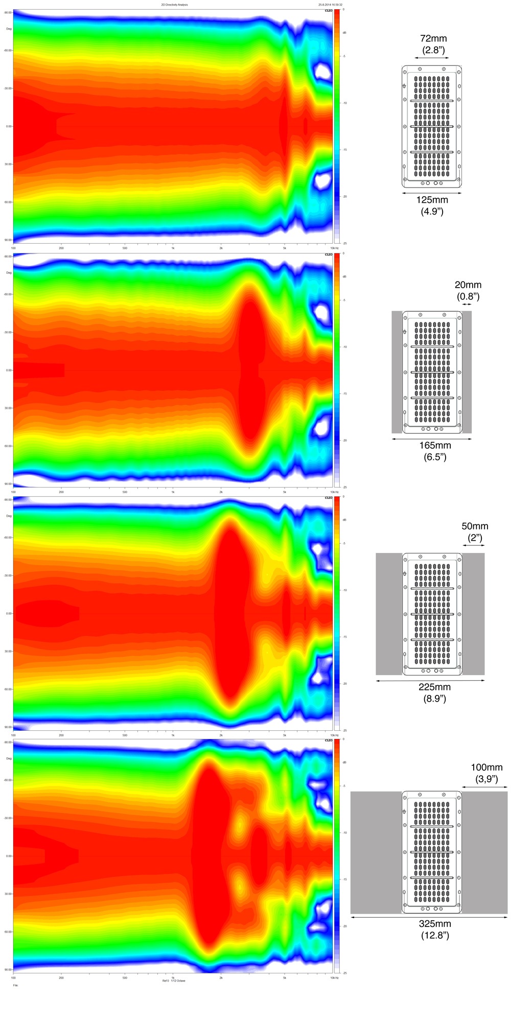

Diffraction effect of a naked 6.5" driver (Sd 133cm^2, OD 176mm) (ie. no baffle)
Simulated response of baffle-less PTT 6.5M-04. 2.83V drive level @ 1m.

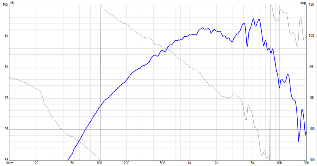

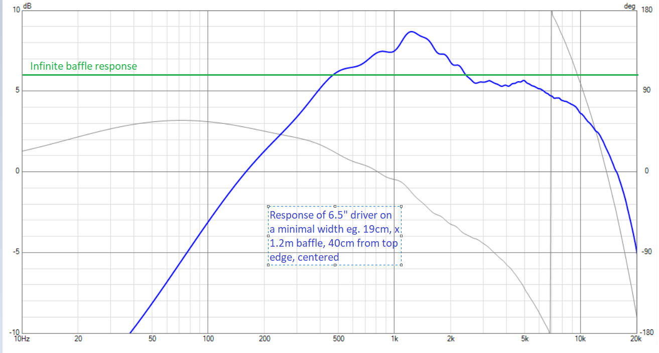

Diffraction effect on 6.5" driver on 19cm x 1.2m baffle, driver mounted 40 from top, centered along width. Open/dipole baffle. Mic & tweeter 10cm from top edge (reference axis)

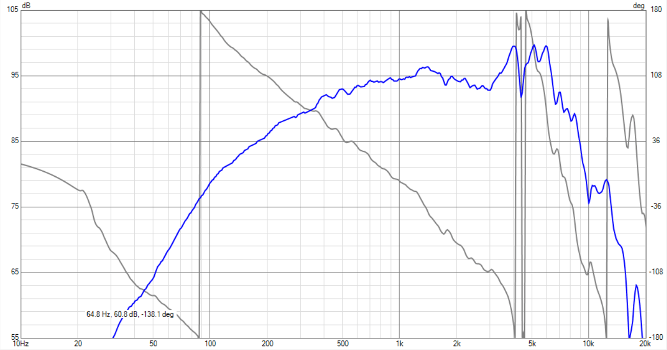

Simulated response PTT 6.5M-04 19cm x 120cm open/dipole baffle; 2.83V @ 1m. 40cm from top edge, centre along width of baffle. Mic 10cm from top edge, on axis with tweeter.

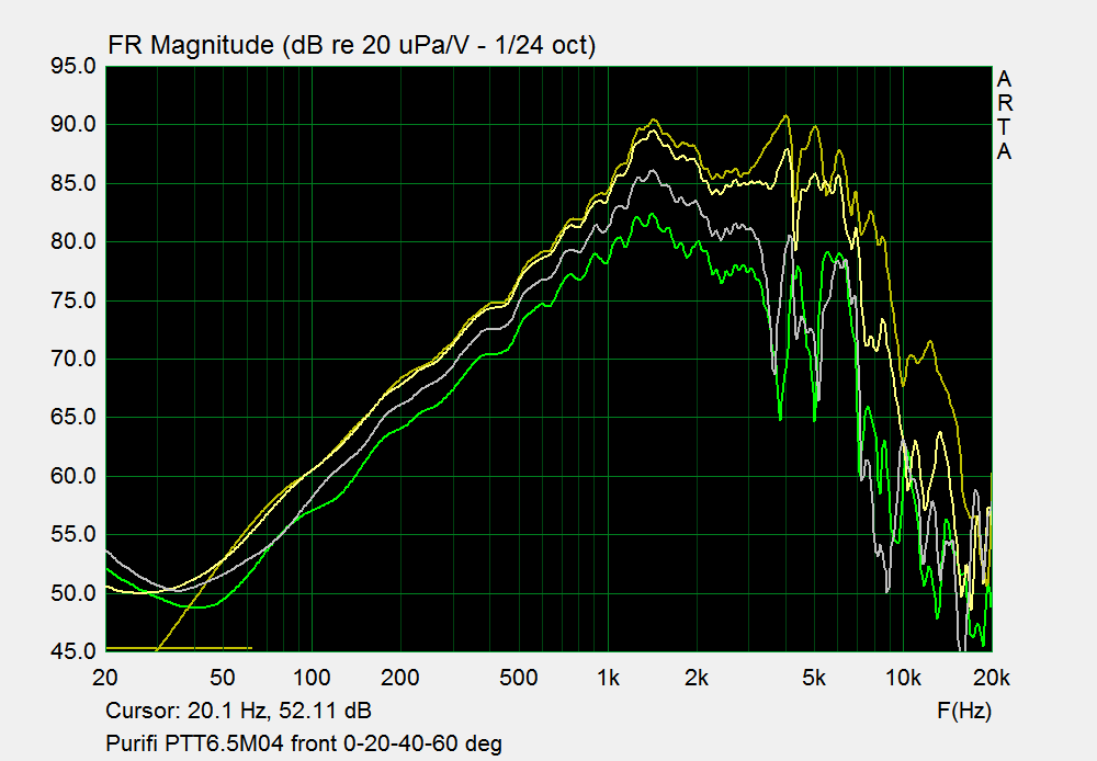

I posted an actual measurement of the PTT 6.5M in post #10, above. If you compare them you can see that the simulated response is quite inaccurate. That is typical - I have not seen a program that can accurately sim the dipole peak area and breakup region. You have to buy the driver and measure it, or find someone else who has done that under the same conditions. Don't trust the sims too much, especially if they include the dipole peak region.

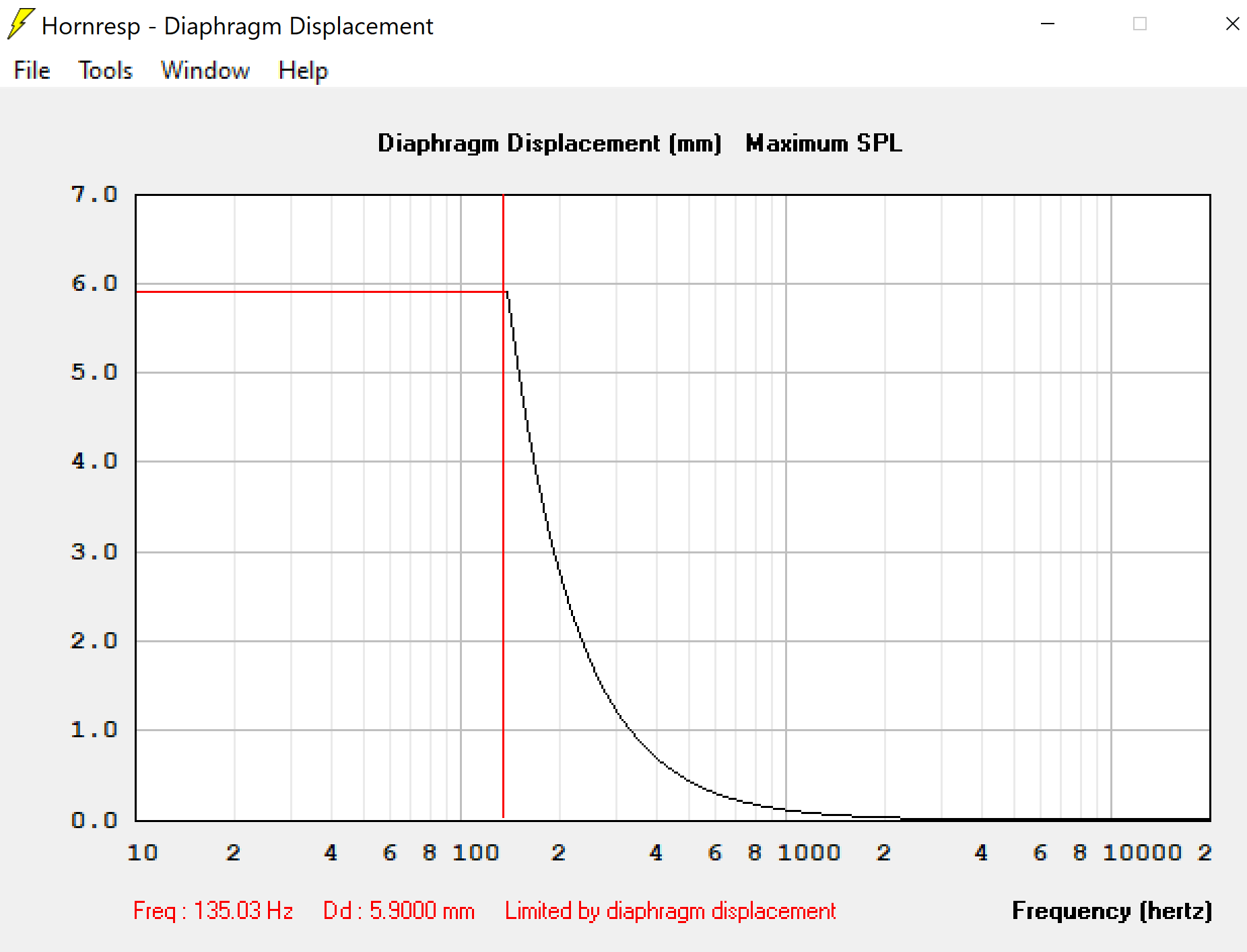

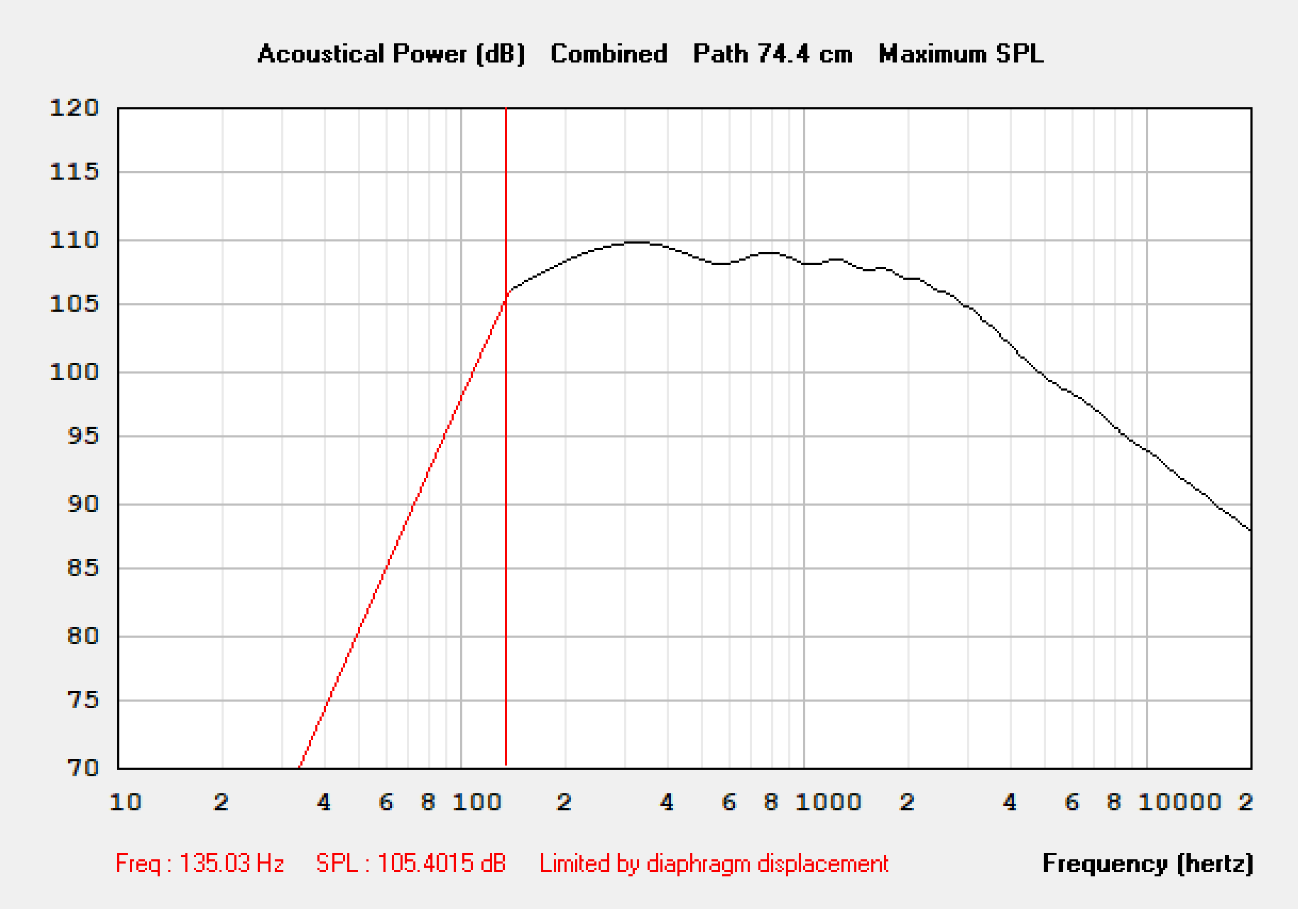

I'm most interested in excursion limited SPL for a driver with Sd of 130cm^2 & 2.9mm in an open baffle of moderate size, VS when it's baffle-less.
I agree Charlie, one needs to measure the drivers in their actual usage. Simulation is only that- a starting point, and shouldn't be used to design a speaker. Though for comparative use between open baffle and baffle-less, I thought it might give some insight.
For one thing, the input I'm using is traced from Purifi's datasheet. And assumes the input data is 2pi (infinite baffle). So If the datasheet data uses an IEC baffle, or any other baffle, then it is not correct. There's also a big chance it's mistake with my use of VituixCad2. So garbage in x user error = big garbage out.

What were the conditions for measurements of the drivers? eg. baffle dimensions, enclosure, measurement distance.

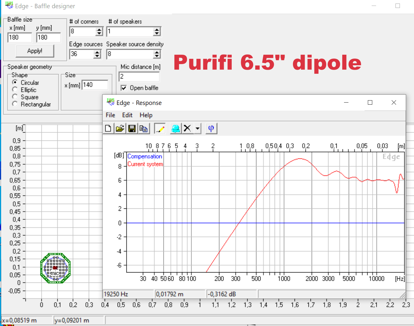

Dipole loss eq is really problematic, a challenge for drivers. I can't do calculations to estimate excursion or use modern simulations for it. Then another thing is how the driver handles this extreme excursion - motor, spider, cone and surround all make distortion with different behavior, and the sum of all this we can measure as nonlinear distortion with increasing spl/excursion.

we use a half space anechoic chamber (ie like a full space chamber cut if half and the cut replaced by a wall where the drivers sits and radiates into the room. mic distance is 40cm but measurements are scaled to show 1m results. This approximates infinite baffle. hope this helps?I'm most interested in excursion limited SPL for a driver with Sd of 130cm^2 & 2.9mm in an open baffle of moderate size, VS when it's baffle-less.

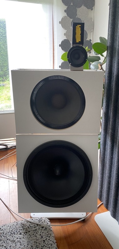

I tried to get a 3-way nude OB to work with an 18" woofer. It would have to cover the range 80Hz to 350Hz. The low end is more of a function of baffle. More baffle makes for more low end capability. But I could not really find any 18" driver that would work well up to 350Hz. Even some 15" drivers did not sound good that high. I think this is due to cone resonances. If you look at the impedance plots for 18 and 15 drivers you often see a glitch around 250-300Hz. This is probably the first cone resonance mode.

I think John Krevskovsky's ABC Dipole spreadsheet was useful for that. The main problem is that it's no longer supported, and I get Microsoft VB run-time errors when running.Dipole loss eq is really problematic, a challenge for drivers. I can't do calculations to estimate excursion or use modern simulations for it...

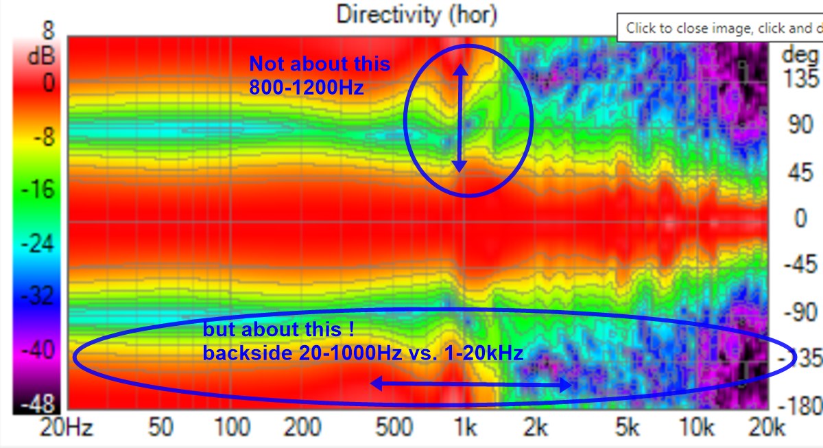

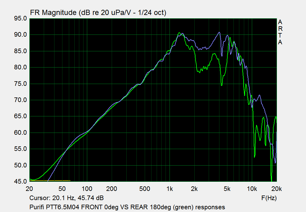

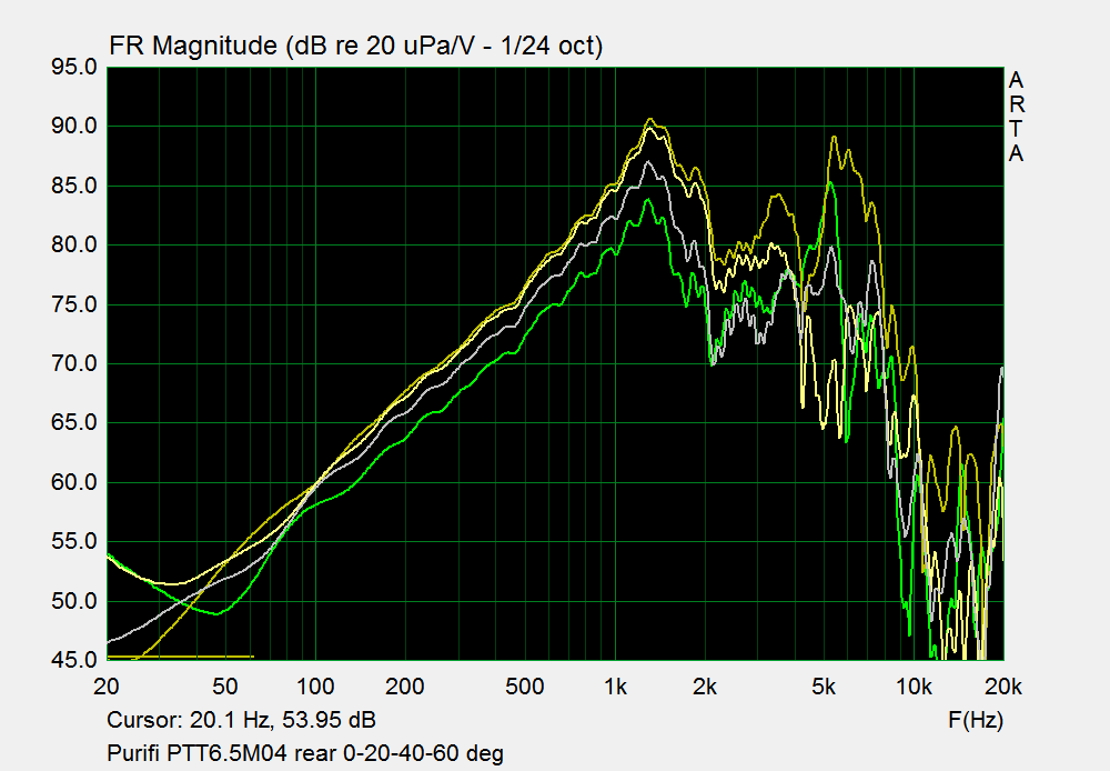

Charlie's measurements are on post #10. Backside responses look pretty good, but level above 2kHz is much lower than frontal. My experience is that the real challenges always come above 2kHz even with smaller cone drivers. Small drivers and minimal baffle is required.
Anyway it's important that the summed sound power radiated backwards is almost same, this will affect room decay. Without backside radiation treble sounds different than lower registers. This happens even with "normal" speakers with deep and wide horn speakers. Small differences in radiation pattern are not really important.
Wide open baffle speakers have rather wide range of almost omnipole radiation. That's why I can't call them dipoles. It's difficult to find full 360deg polars of them, I guess designers know that they wouldn't look good... Even Magnepan LRS isn't good

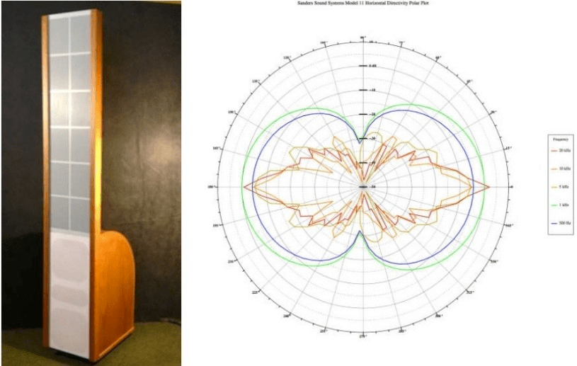

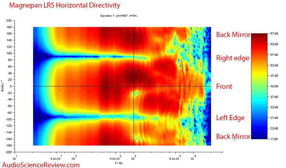

That Magnepan LRS isnt a good dipole example. Below is the Sanders ESL showing the expected dipole:Even Magnepan LRS isn't good

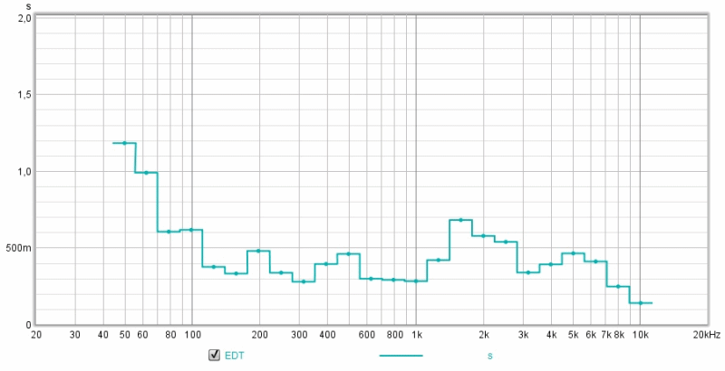

My experience tells that lowering ears is more effective than lowering source! Furniture specially sofas will effectively kill horizontal flutter. But at same time vertical mode's phase sum changes, and that might do good or bad.
The Greek study was done in 3 halls, smallest 6x8m. Every hall had quite high level of EDT etc. Typical home rooms are much better and as per my experience, handclaps will reveal only really bad cases. Learning will help for this obviously.

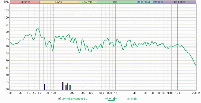

EDT is not always same, here are my MMM, 4 measurements per speaker L+R separately. One per speaker is from knee level, one above my head. I suppose lowest EDT of mid-high F comes when mic is low. SPL response shows variation too (500ms 1/12), notice that modal frequencies remain same.
