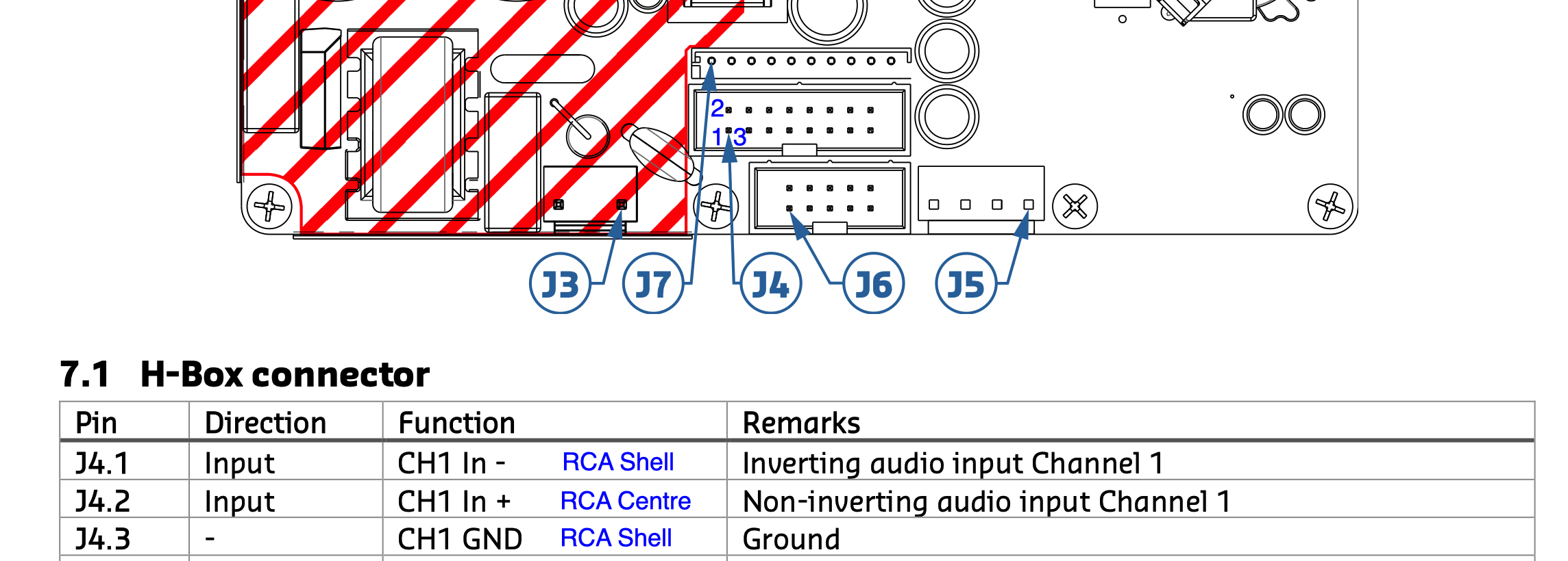

Can you tell me if I made a mistake in the above picture ? Just need to connect a RCA plug into my NC250MP module :
I suggest reading the NC250MP data sheet. You can download it from Hypex, though they might require that you register on their website before they'll let you download it. You can find the NC250 product page here: Hypex Electronics B.V.
The attached figure is a screen grab of the relevant section of the data sheet. You'll notice that the input to the NC250 is differential, thus, requires three connections: IN+, IN-, and GND.
Elsewhere in the data sheet, you'll notice that the input impedance of the NC250 is 47 kΩ.
Any audio source is able to drive 47 kΩ, but not all sources offer a differential (or balanced) output. So you have a choice:
- Use a pseudo-differential connection (as shown in attached figure)
- Use one of my Universal Buffers to make a single-ended/unbalanced to differential/balanced converter
Personally, I would fit the amp with an XLR input connector so you maintain the differential connection. The XLR standard pinout is:

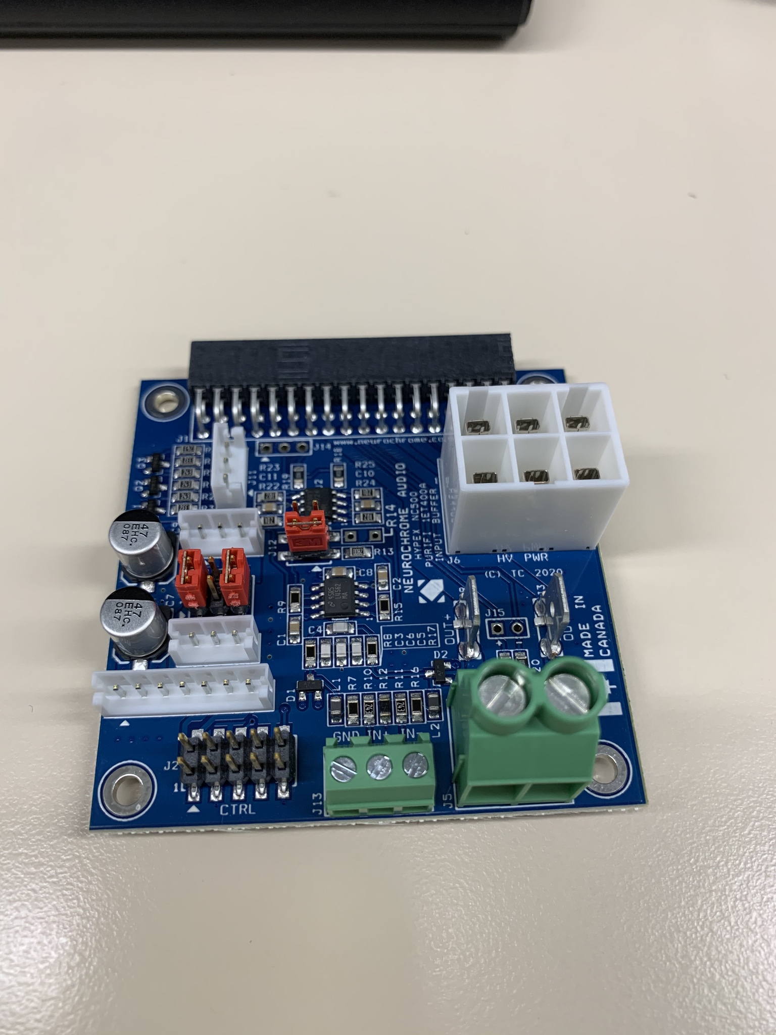

In this picture this board seems to be the output stage while the universal buffer is the input buffer. im confused as to what is happening here? why does there need to be this board on the output just before the speaker terminals? doesnt the amplifer board provide the amplified signal directly to the speaker? why is it called input buffer if it has the speaker level signal? I thought i knew what was going on but now im really confused:
I suggest you contact the original owner for the detail about this build.
The green boards were an early prototype of the Purifi/Hypex Buffer. It looks like the original owner bypassed the buffer board and wired the Universal Buffer directly to the input of the amp module. That's why you see that "flyover" coax cable. The prototype for the Purifi/Hypex Buffer did not have a differential output. That was added before the circuit went to production. That's probably why the amp is built that way.
If you contact me by email, I'm happy to provide the documentation for the Universal Buffer for you. Just include a picture of the board in your email so I can get the correct documentation to you.
I do not have documentation written up for the prototype Purifi/Hypex Buffer board. I'm happy to answer your questions about it, though.
