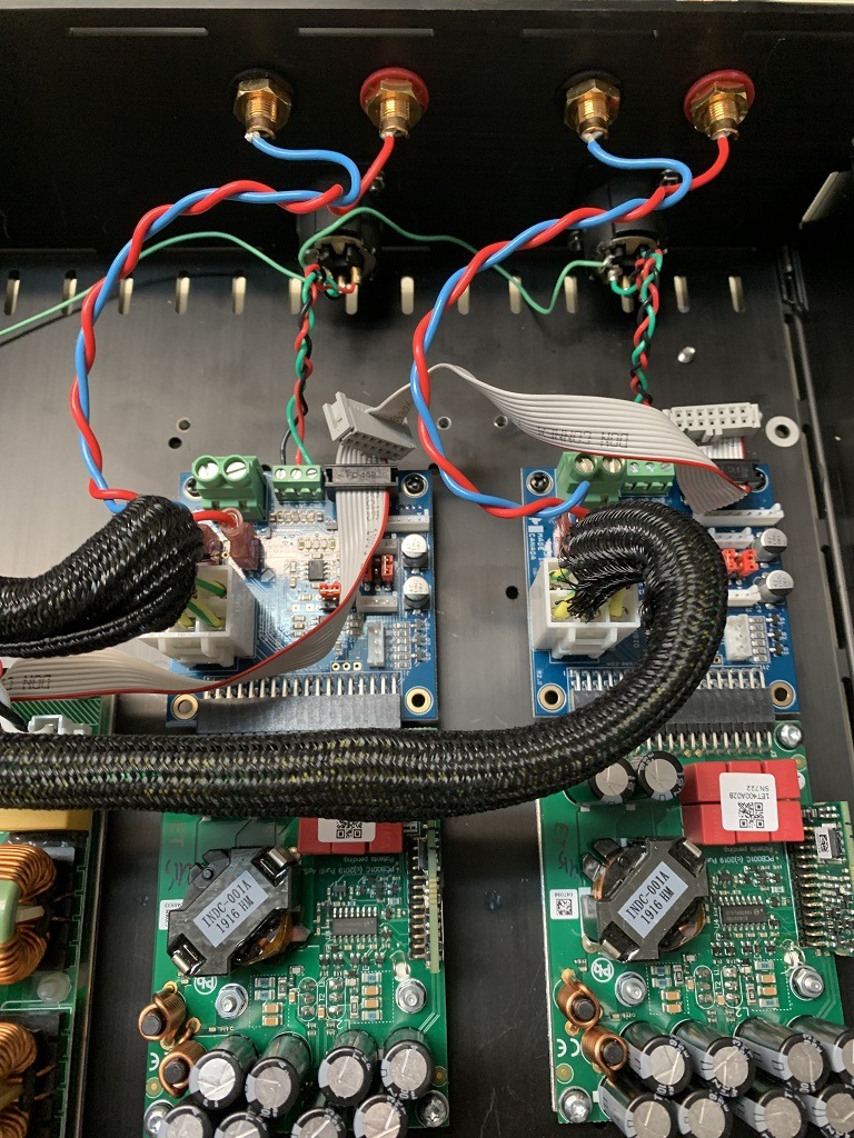

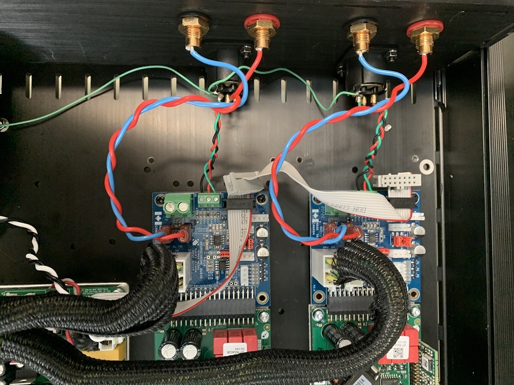

Nice to see this post.Here's one of them I just did a day ago. Kept the original power harness, added connectors on original ribbon, this way he can change back if he wants, redone XLR cabling. Added thermal paste under the power amp modules, even though it is technically not necessary. Plays super nice!

It was on my mind whether Tom's buffer's would fit into the VTV case easily, looks like the only work to do is drill 4 holes to attach Tom's buffer's to case, is this correct, or do I need a longer ribbon cable or does the original VTV do the job?
VTV puts a 14-pin connector on the 10-pin ribbon cable for some obscure reason. You'll have to add two 10-pin connectors. That's pretty easy. You just feed the cable through and press down on the clamping piece. Just make sure all the wires line up with the corresponding forks in the connector.
I think you may have to rewire the XLR connectors, but that's pretty easy as well.
Then just drill the four holes for mounting the board.
Tom

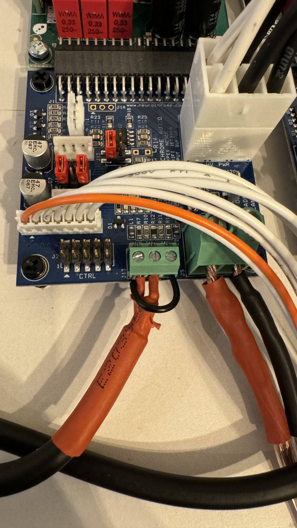

Hi Tom!
I'm making final checks before connecting my speakers to the buffer.
I provide a 432Hz signal with ~ 1VRMS to the buffer input using RCA input and measure the output signal.
The DC is ~20mV and AC is ~ 80mV no matter what volume level I set.
Today I checked my SMPS voltage and it's as expected, including the AUX voltage.
Could you please check if my wires connection is correct?
Also, what pins can I measure voltage to check if my buffer/amplifier is not damaged?
Thanks!

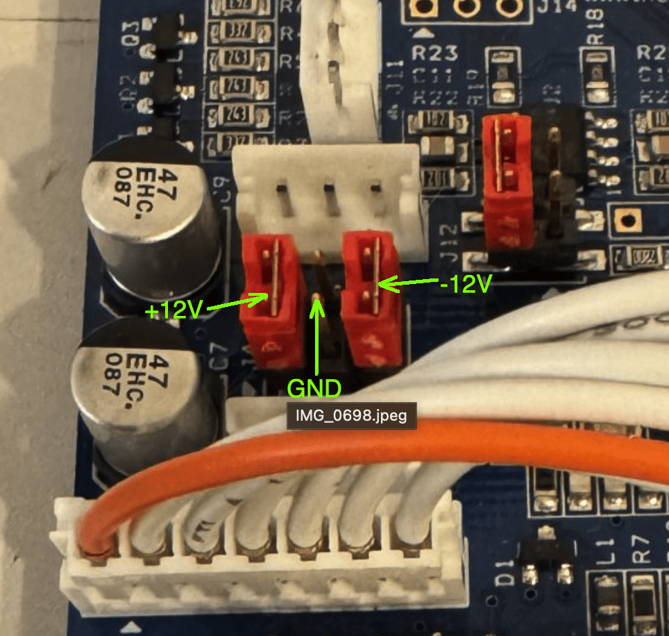

You should be able to find the AUX voltage here:
You should also have +12 V at U1, pin 8 and -12 V at U1 pin 4.
The input is connected correctly, assuming you have the RCA center connected to pin 2 of the input connector. I obviously can't tell how you have the rest connected.
Tom
Tom
Both channels have:You should be able to find the AUX voltage here:
+10V and -14.1V
I had a splitter for the J10 to feed both channels from the same SMPS.That's out of spec, so that's probably why it won't work
I removed this splitter and connected one channel directly.
AUX voltage on jumpers became 12V and -12V
When I increase volume on my iPad phone connector voltage on the speaker connectors is 1.2VAC.
Could I burn my Purifi module based on your experience? 🙂
Probably not. The modules are pretty rugged and also have some built-in protections against over/under-voltage and that sort of stuff. In fact, a customer of mine accidentally reversed the polarity of the ±65 V power supply. The amp modules survived but the power supply didn't.
I'd examine that splitter and see what went wrong with it. I do offer an SMPS Splitter to make life a bit easier for you.
Tom
