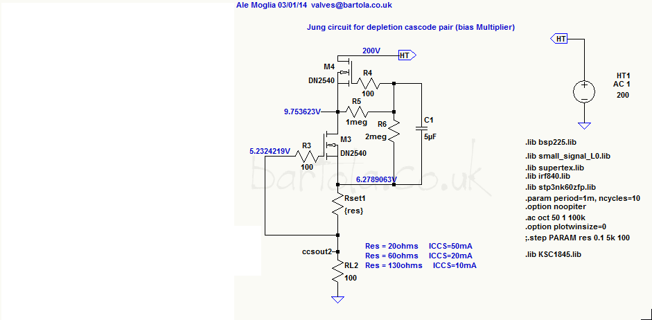

Try the jung circuit...
http://www.bartola.co.uk/valves/2015/08/31/ccs-not-everything-that-glitters-is-gold-part-i/

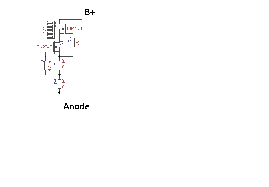

Could I use this IR LED in place of cathode RC bias?
https://www.mouser.es/ProductDetail/Vishay-Semiconductors/TSHF6210?qs=RzxYCzJDjPWqcTfiVxfCUQ%3D%3D
IR Leds are normally noisy unless you run them at high currents ... why do you need this type of led ?
