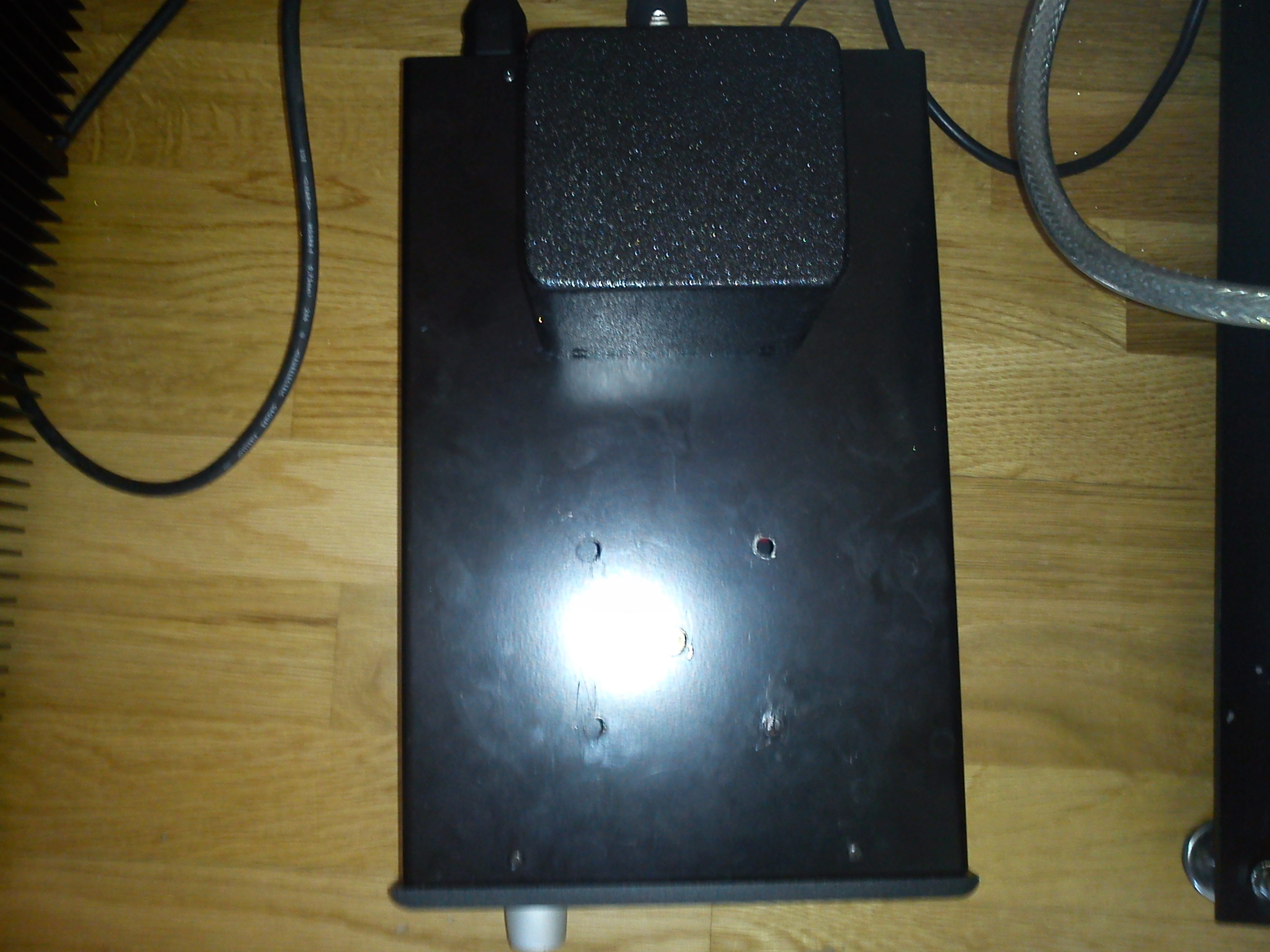

Can you post some pics ?
Is the TX near the amp boards ?

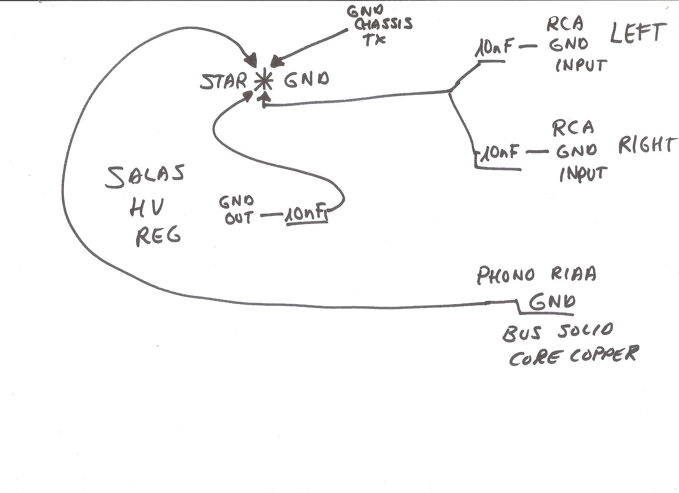

Can you post a schematic with your GND layout ?

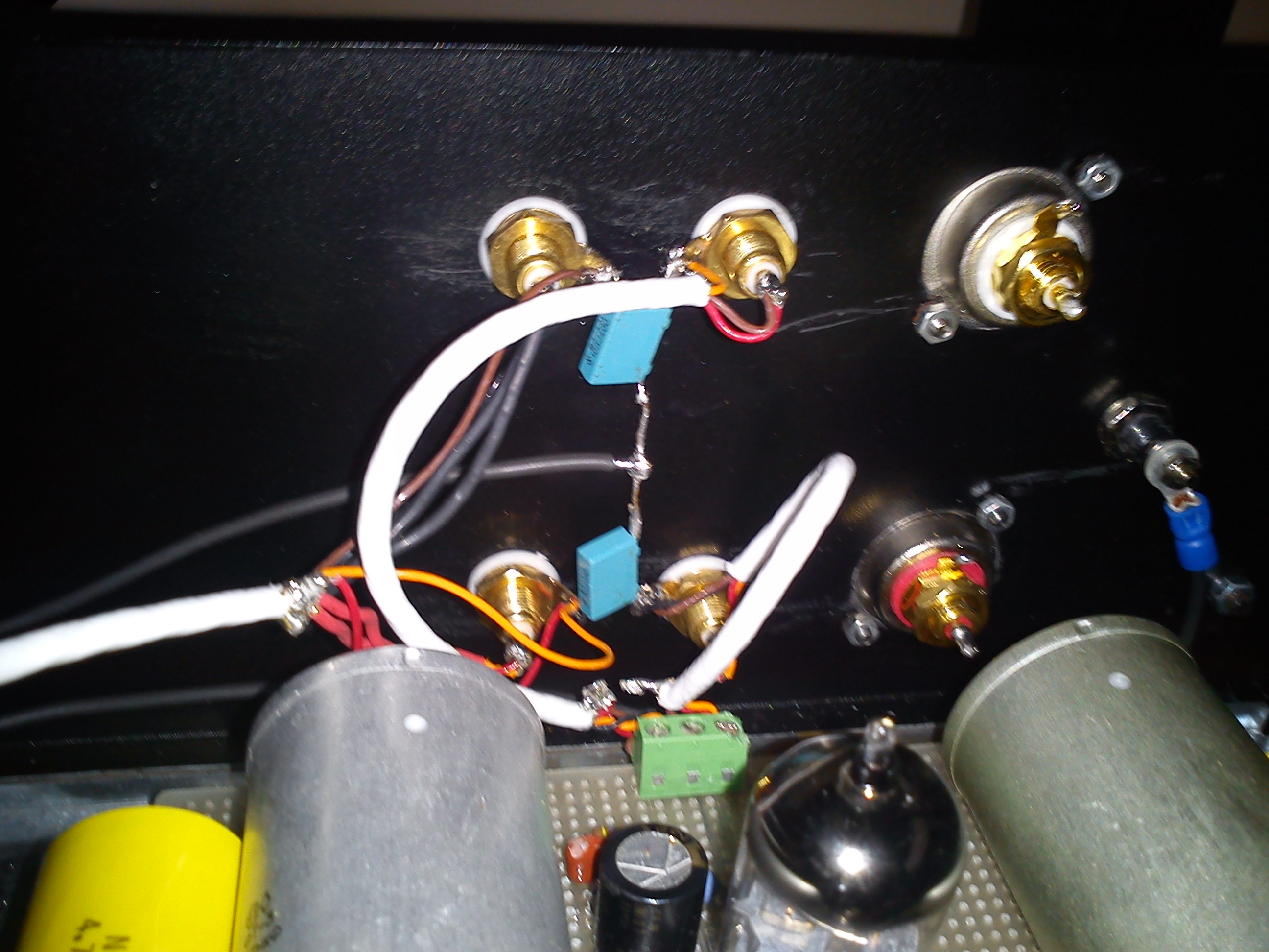

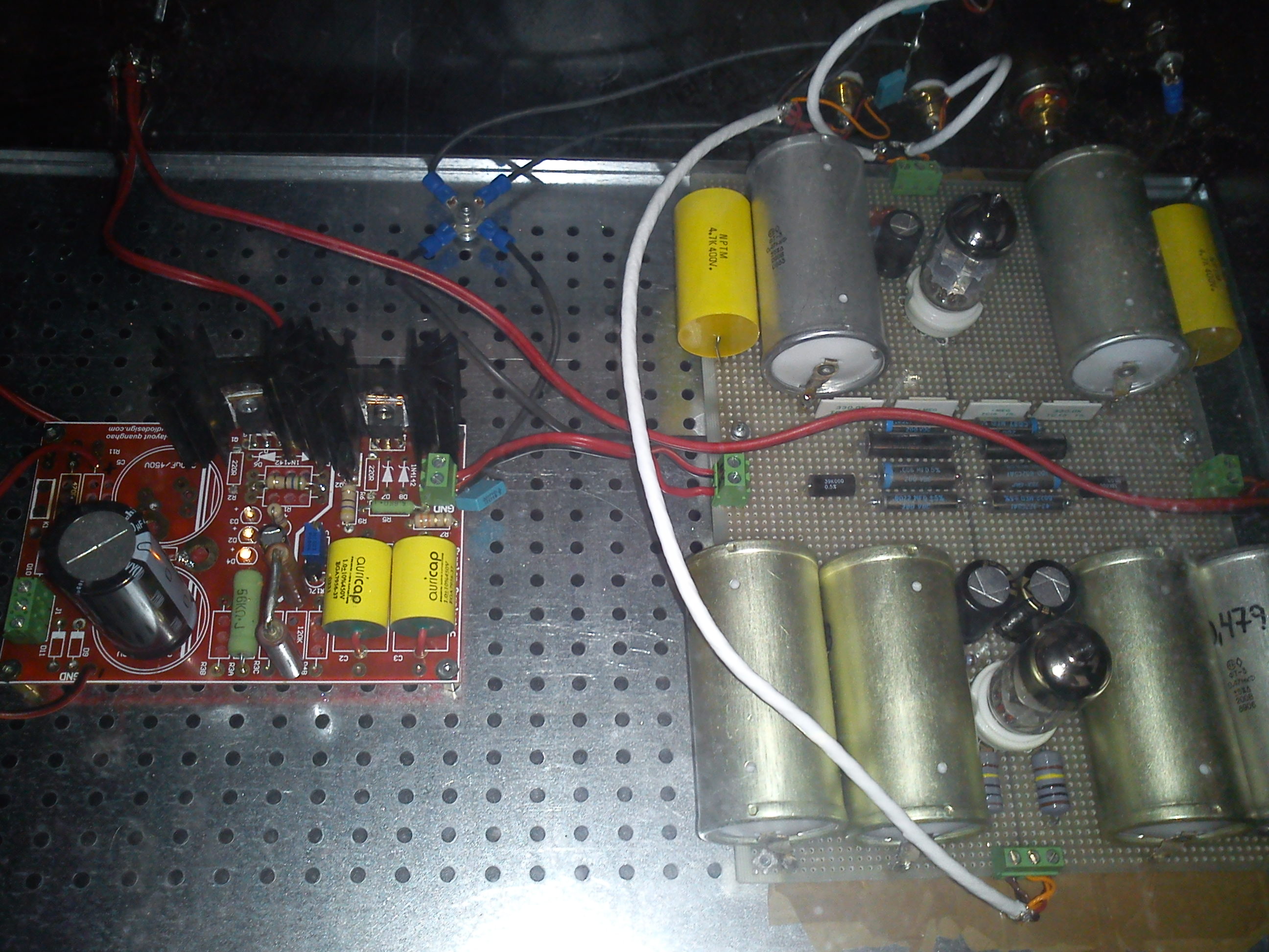

Tx & choke in a separate box as per pics
Schematic
GND is a copper bus solid core
AC gnd to chassis TX, gnd chassis Tx to GND solid core bus phono RIAA.
After + Salas HV reg 10nF to gnd phono RIAA chassis, Left & Right gnd 10nF to gnd phono RIAA chassis.

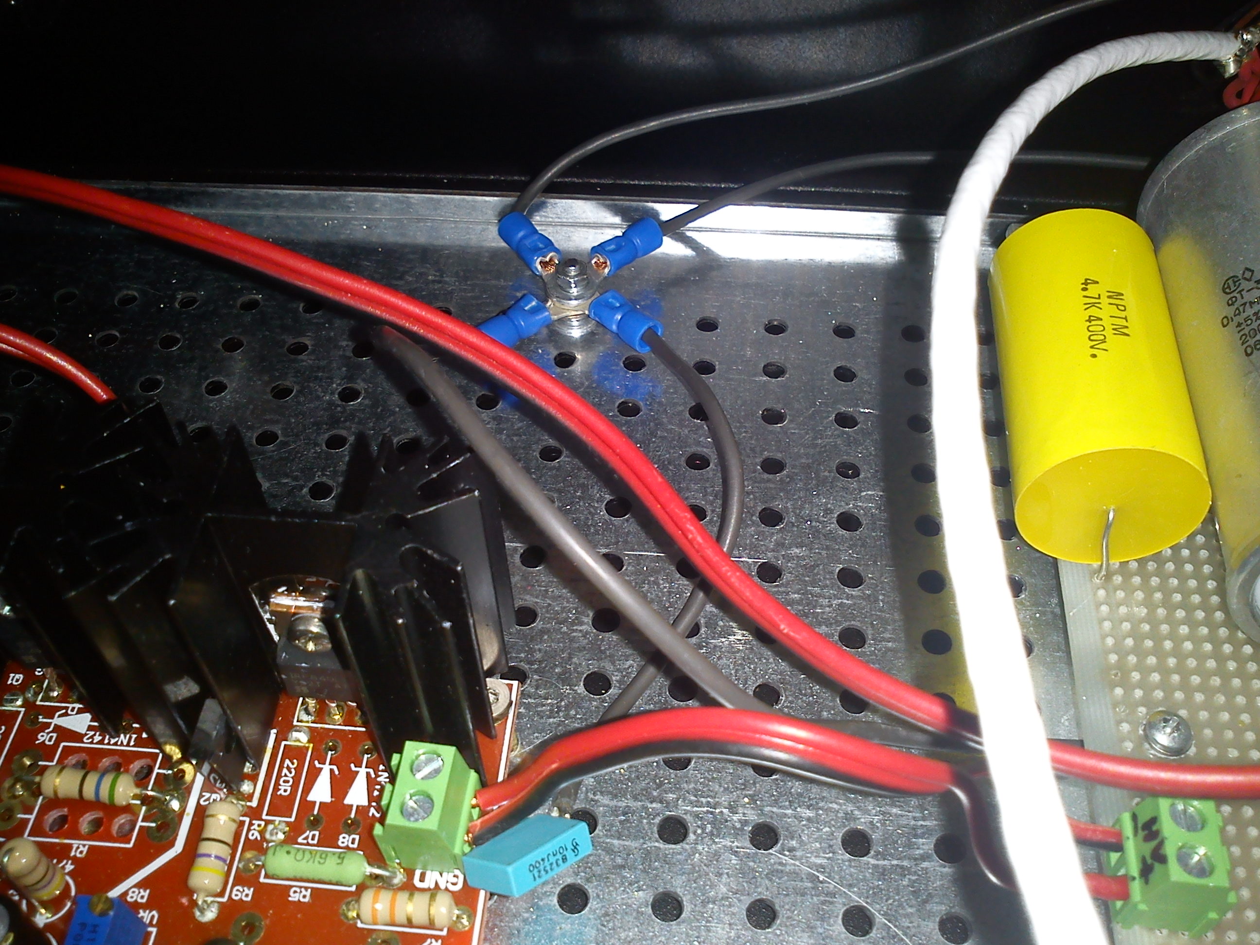

Where does your schematic GND connect to chassis GND ?
Why the Reg 10nF to chassis GND ?
My suggestion is drawing the GND setup including the star GND on the chassis and the wire coming from there to the back plate. It is very difficult to see everything in the pics.

I would experiment lifting the 10nF caps off the gnd.

Logical checks. Had sound and sound stopped? What has got changed meantime? Those 10nF caps are supposed to go from input RCA's rings to chassis locally, not in line with any signal. Rings should be meeting signal ground also with the coaxes. Is the same source playing both channels in another preamp? Connections, all secure? Construction, all secure? Tubes? Bias voltages? Etc.
Same noise, now in both channels but less noise in left channel more strong in right channel

Logical checks. Had sound and sound stopped? What has got changed meantime? Now sounds both channelsThose 10nF caps are supposed to go from input RCA's rings to chassis locally, not in line with any signalOK. Rings should be meeting signal ground also with the coaxesNO. Is the same source playing both channels in another preamp?Yes in my MM Rotel Connections, all secure?Yes Construction, all secure?Yes Tubes?Yes I tried with several to be sure isn't the tubes Bias voltages? I will measure & post Etc.

Gotcha HV B+ 95VDC instead 260VDC, LV filaments 6.3V, I tried to fix to 260VDC to see if noise disappears but trimmer only reach 130VDC. Main Tx 240VAC choke 10H 200mA. VDC in reg 260VAC, reg isn't working OK
Something in th reg is damaged because with the 15K dummy load only reach max 130VDC, all 3 LEDs are shining, the trimmer can go down for less VDC, both mosfets are hot, any resistor burned, can be SK170 in the Vref or any other idea where can I start?
