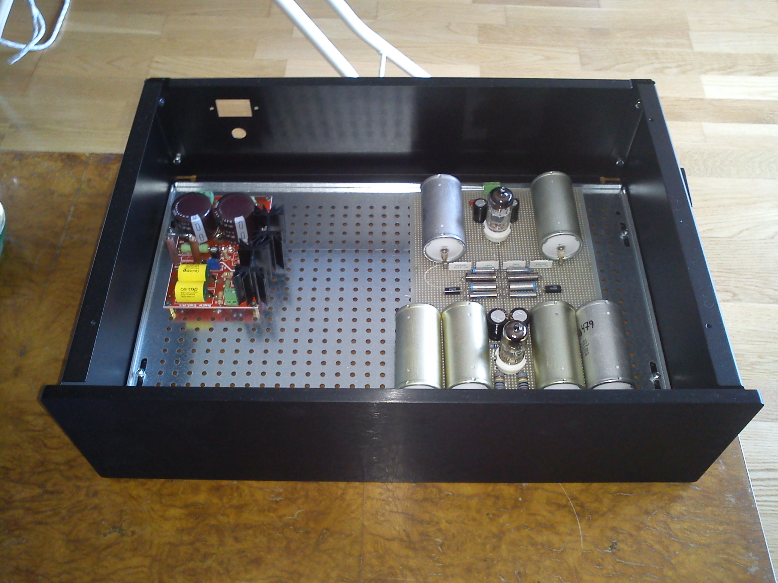

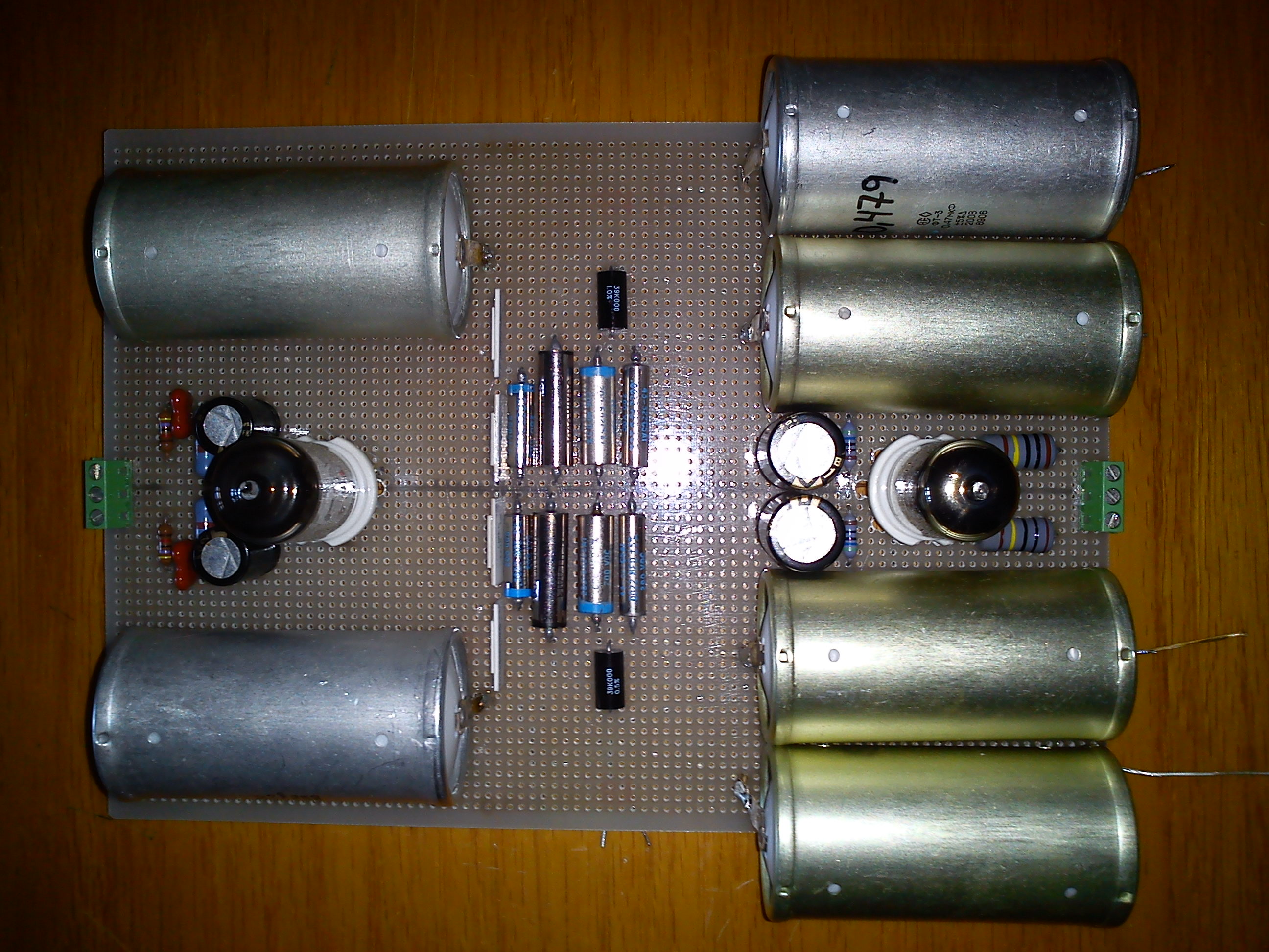

Only for fun a couple of pics
I wanted to know what was going to be before the puresound first stage because in this one there is no input cap and I was wondering about first stage tube grid leakeage.
Now I see the cart will be connected to a jfet input... It is safe.
