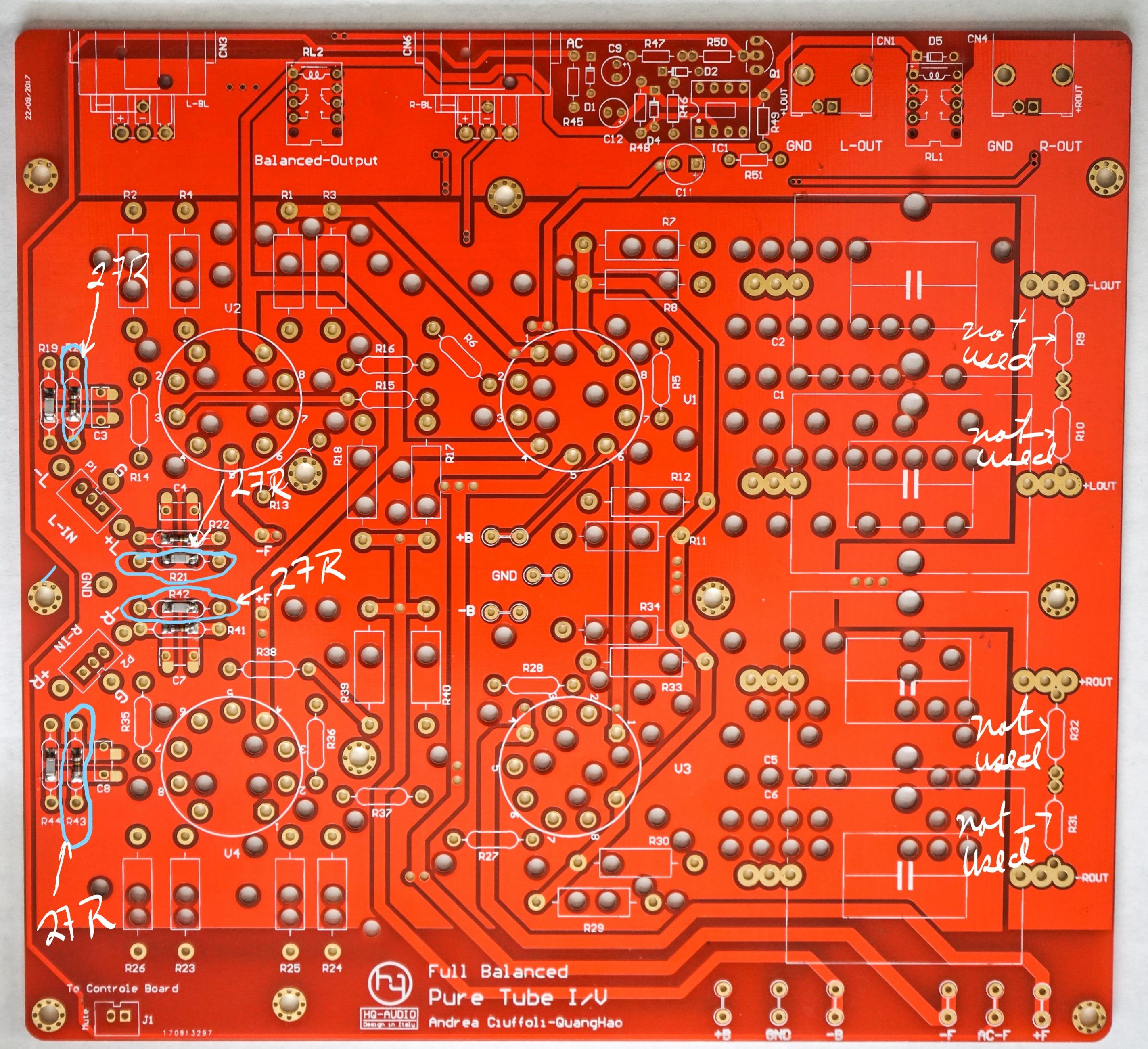

Here a look to the boards with parts on it.

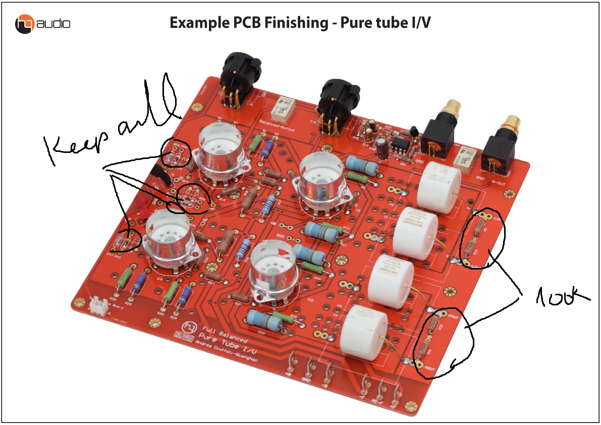

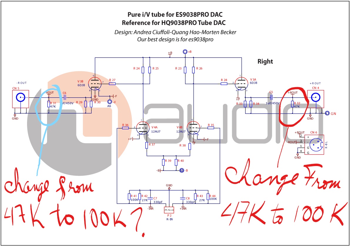

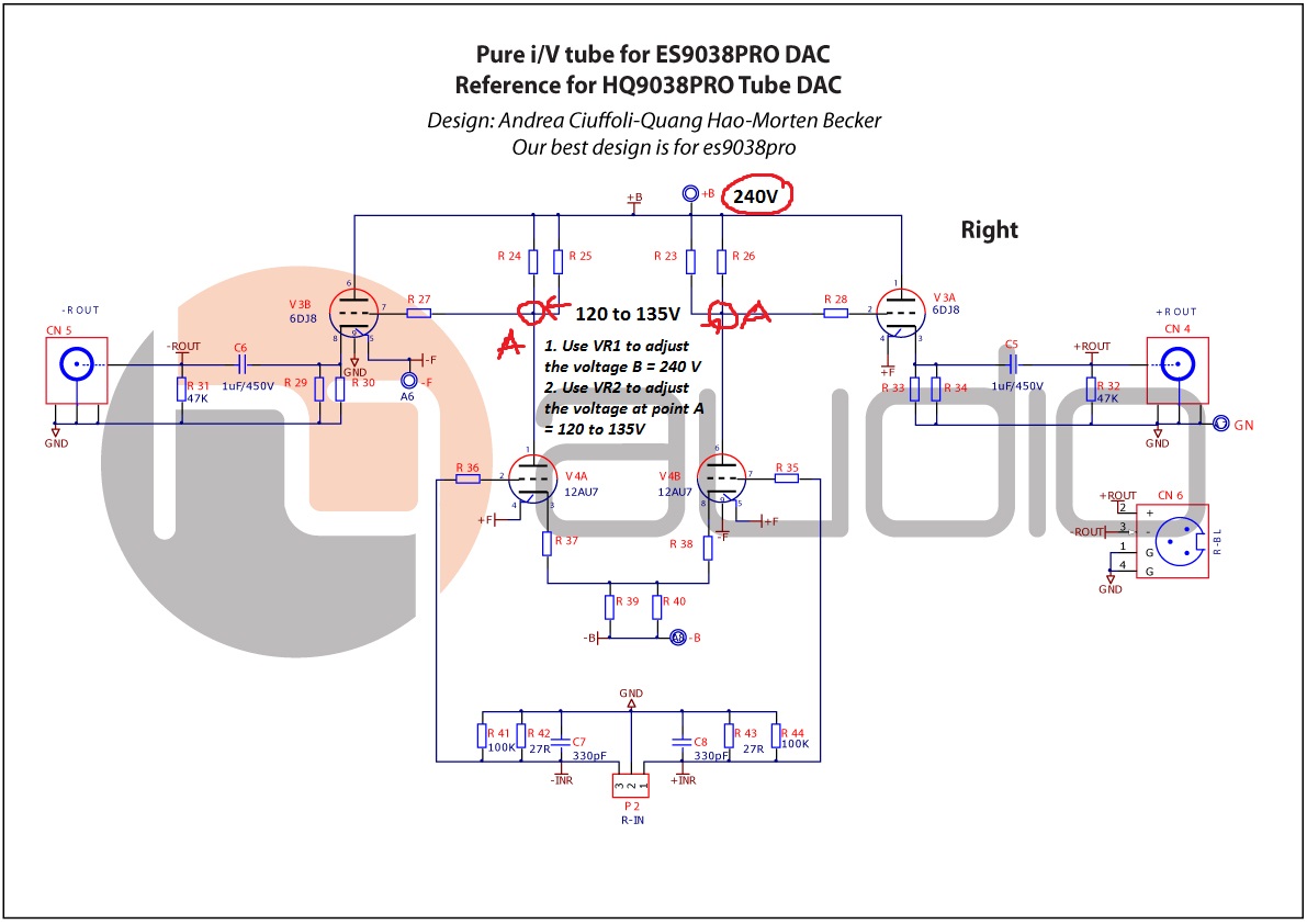

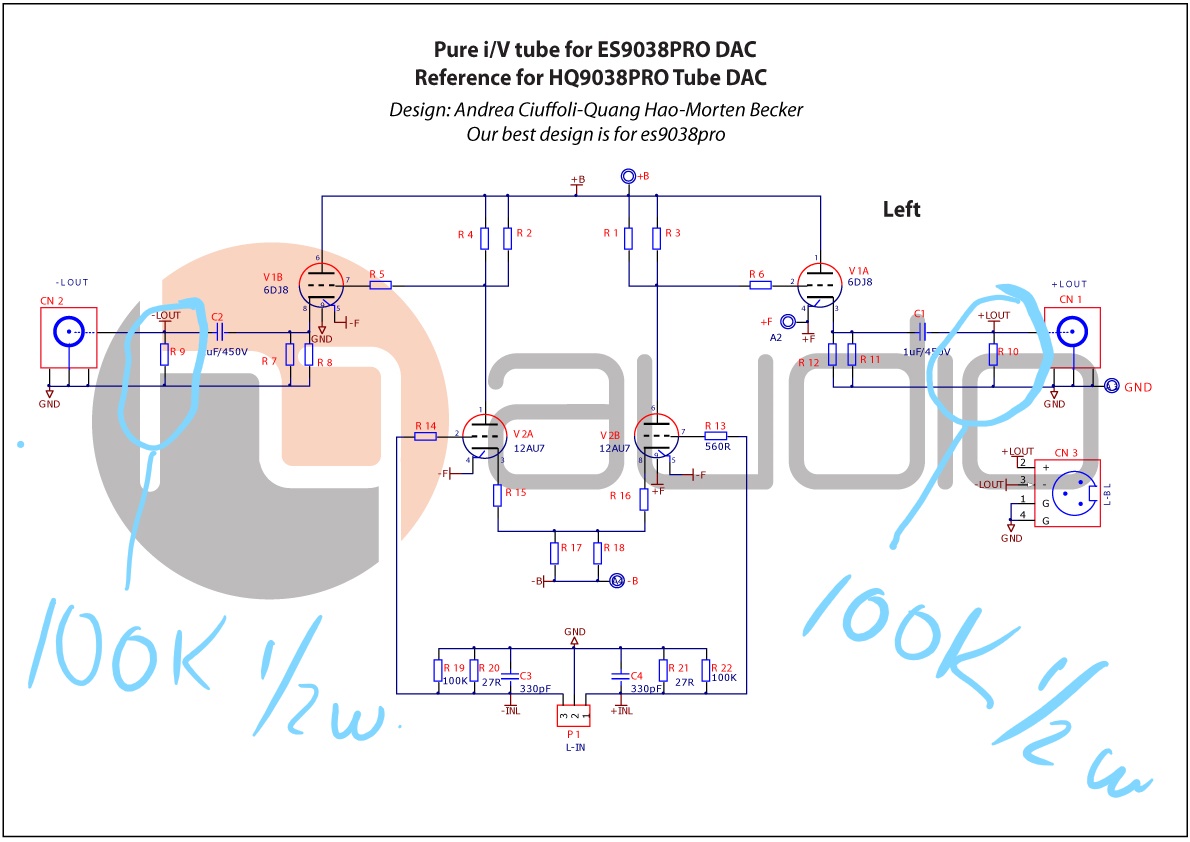

Hello QH, thanks for replay but in post #72 I asked about those resistors and you said not to used them because they are in parallel with R i/v , but in a recent post said need to use 100k resistor and in pure I/V right channel I have to change them from 47k to 100k, just a little confuse here, please advise. thanks

All the sample image 1 . You see good !
R I/V at all input . (27 ohm)

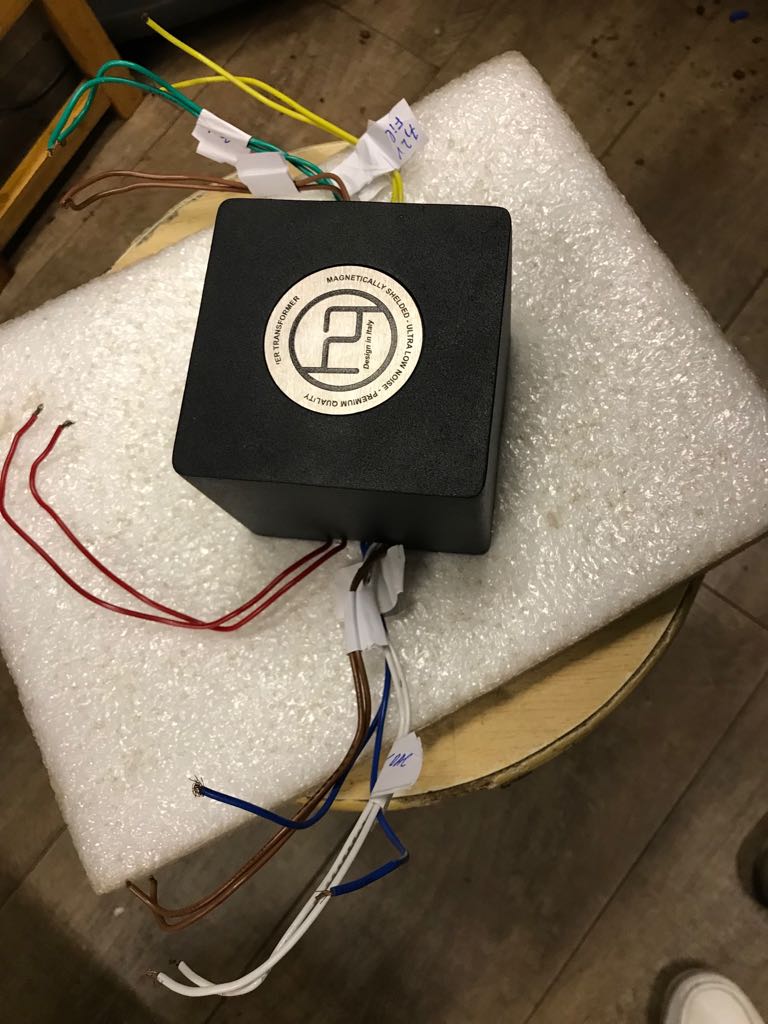

received the transformer, thanks alot.
and the red pair cable is primary 220v input?
yes 220v input!

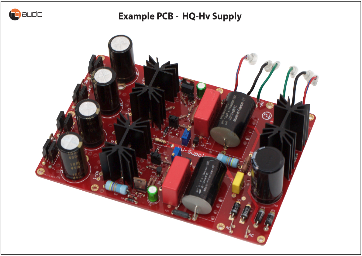

Please note: Adjust the voltage properly design!
1. Use VR1 to adjust the voltage B = 240 V
2. Use VR2 to adjust the voltage at point A = 120 to 135V
I invite you to see pictures!

Hello QH, thanks for asking, almost just waiting for two more transformer ( need 4 transformer to converted from 220 to 115). Is a challenge because chassis mod but I will finished it. I'm getting a wonderful help from Algar (Sylvain), he did the same to this Dac but he has a ton more experience in electronics than me, again thanks a lot to him. But I have more questions about some components, if you do not mind to ask you. Thanks
I assume this works fine with ES9018 dac chip and higher i/v resistor? What is the gain of the tube stage?
