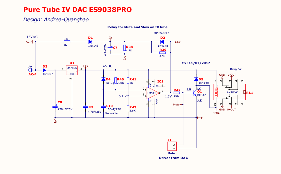

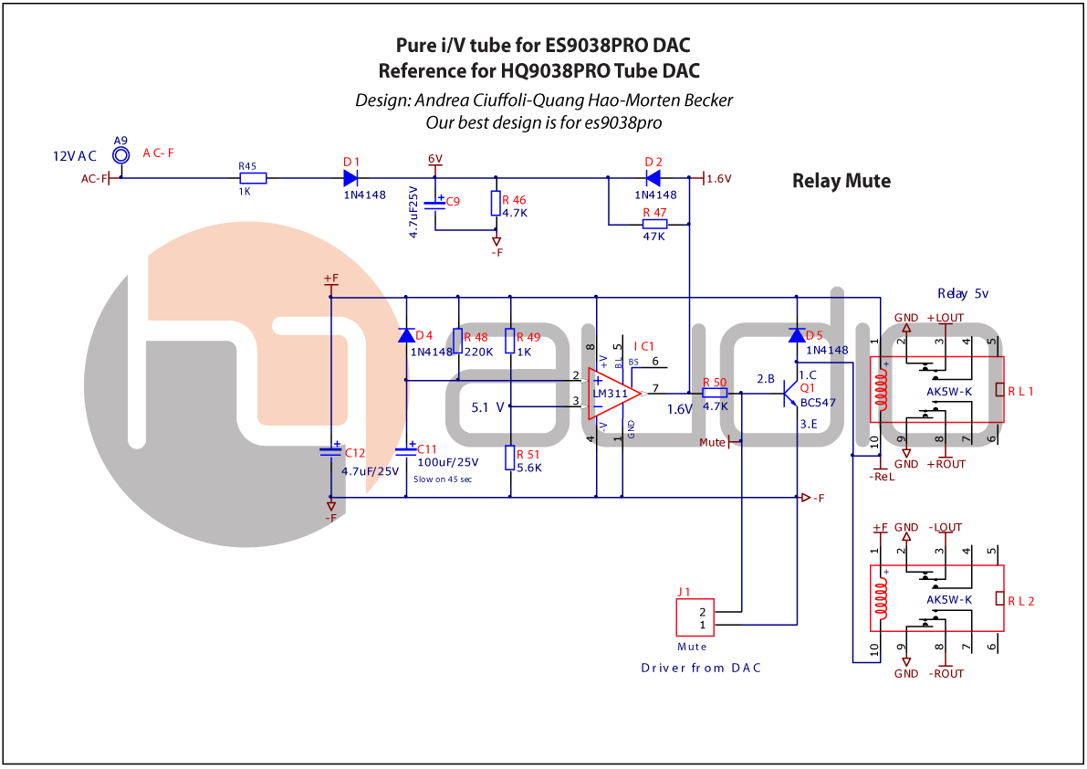

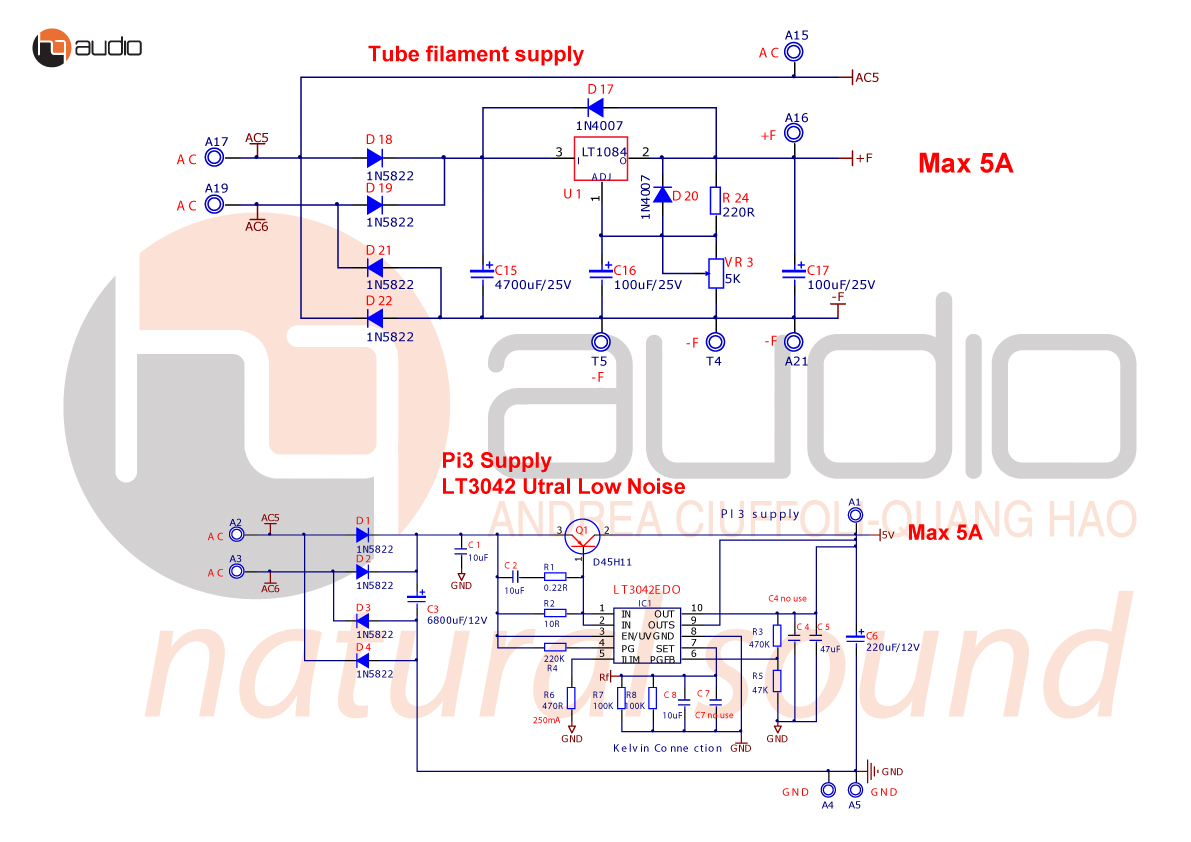

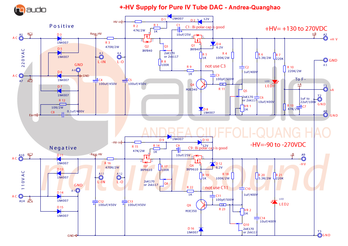

Quanghao,
I just got the Boards, thank you. Are you going to publish the correct schematic for the Tube Output? the one with the 4 tubes? instead of the 3 tubes? Also, the schematic for the power supply. The one that is posted has no link to the schematic. Can you please check, so we can start building this Tube Output?

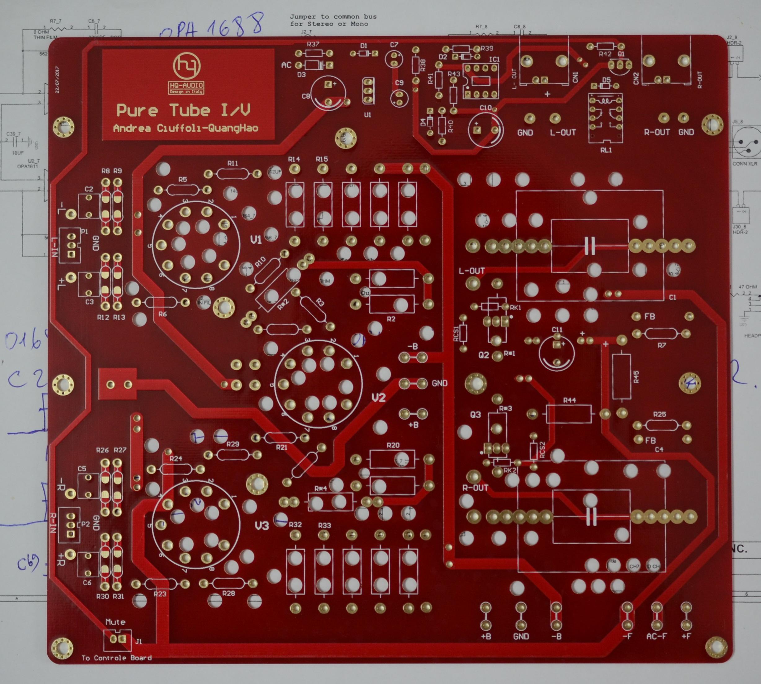

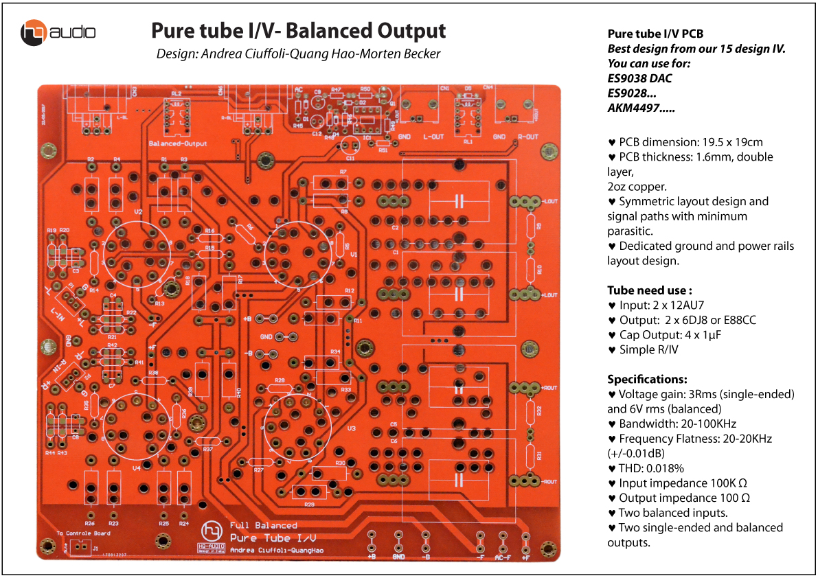

Hi vega65!
this information about the PCB IV for ES9038 Dac
1. Pure tube I/V- Balanced Output
Pure tube I/V PCB
Best design from our 15 design IV.
You can use for:
ES9038 DAC
ES9028...
AKM4497.....
♥ PCB dimension: 19.5 x 19cm
♥ PCB thickness: 1.6mm, double layer,
Tube need use :
♥ Input: 2 x 12AU7
♥ Output: 2 x 6DJ8 or E88CC
♥ Cap Output: 4 x 1µF

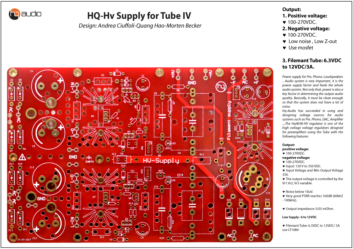

2. HQ-Hv Supply for Tube IV
Output:
1. Positive voltage:
♥ 100-270VDC.
2. Negative voltage:
♥ 100-270VDC.
♥ Low noise , Low Z-out
♥ Use mosfet
♥ PCB dimension: 19.5 x 13cm
And all Schema , please see image, Thanks

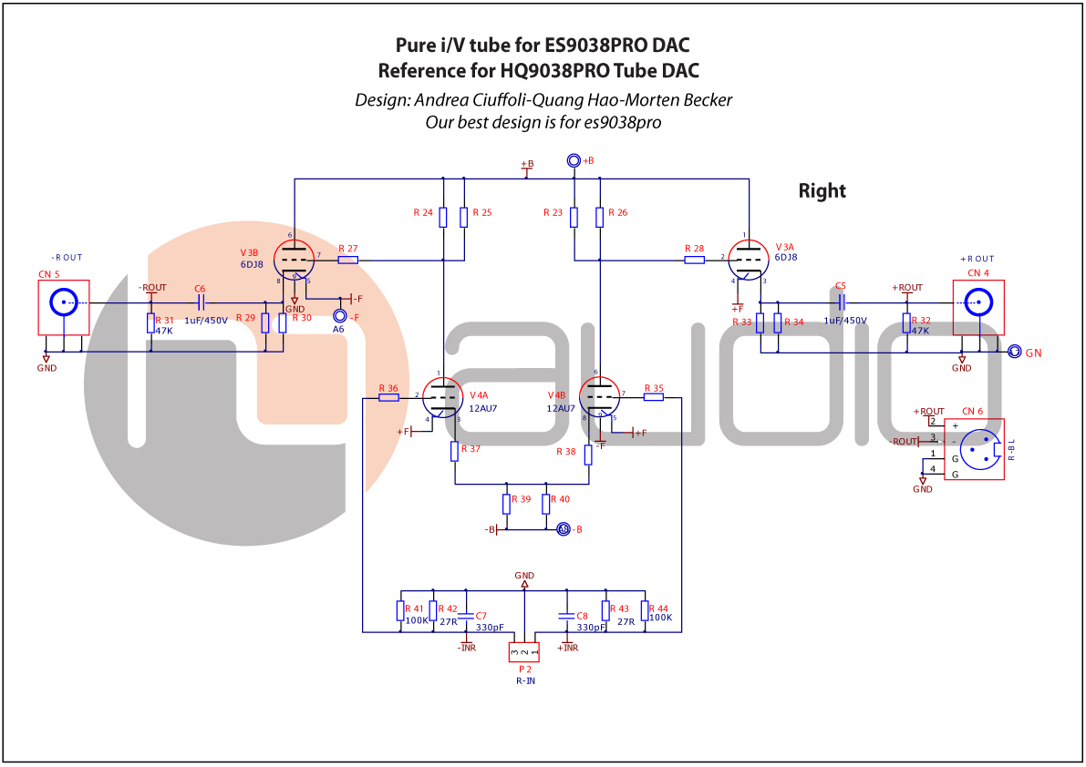

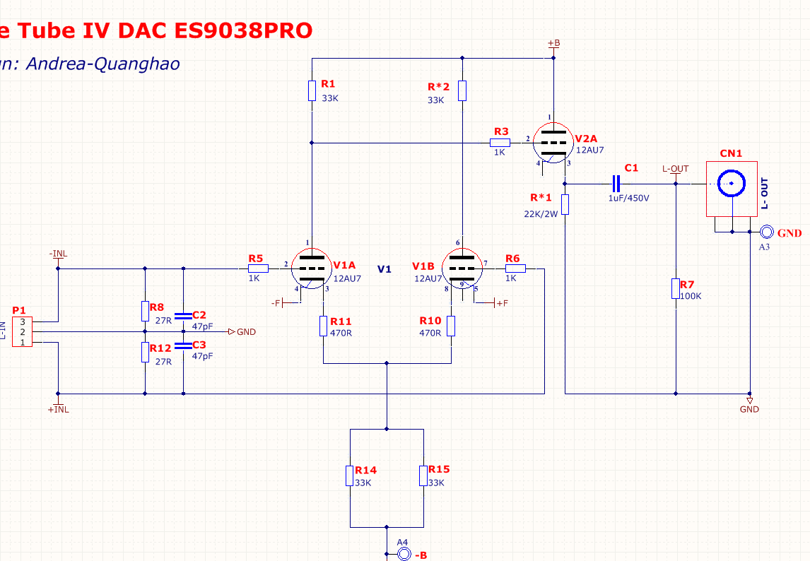

Please Can somebody tell me what is the difference between board with the 4 tubes and 3 tubes, the latter been old version perhaps? This is so confusing , after waiting for a year for this boards maybe I'm getting the old version ? this is not fair.
Pure Tube I/V balanced x 1
HQ-Hv Supply for Tube IV x 1
You can check the schematic to find out the difference. I have both of these pc boards. The 4 tubes can do balanced or single ended output and can use 6DJ8 or 12AU7 tubes on the second stage. The 3 tubes only has single ended output and all three tubes uses 12AU7. I have not tried it yet, but I am thinking of building the 3 tubes also as I dont need a balance output.
Alex
Alex
thank adeveza show for all!
quanghao

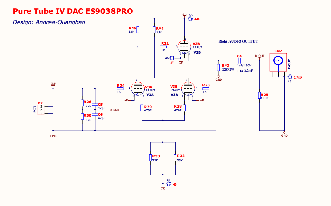

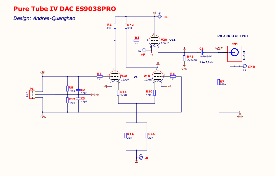

Hi JPDuarte and all!

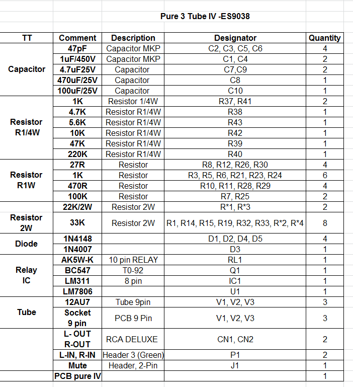

yes, i have 2 option PCB
1. Pure i/V balance with: 2 tube 12AU7+ 2 tube 6DJ8
2. Pure I/V SE with 3 tube 12AU7
3. HV supply for Pure i/V use one
Now you can see schema off Pure i/V SE and par list! thanks
quanghao

Thanks, is there any difference in sound between the two ?
It's almost the same, different output tubes 12AU7 and 6DJ8.

R*1 & R*2
Quanghao,
I asked you this before, but I did not get a response, please explain, what is the meaning of the * in R*1 and R*2 on the main schematic.
Can anybody tell me what this means? I do not want to build this unit until I totally understand what everything means.
Alex
Quanghao,
Alex
Quanghao,
Alex
it is all normal.
R*2 = R1 and R19=R*4 it is R for balance input Tube.
R*1 = R*3 , R set current for output!
all is symbol
ok, you see now???
please see image
thanks
it is all normal.
all is symbol
ok, you see now???
Sorry quanghao, but where is R*3, R19 and R*4? Its not in the schematic?
