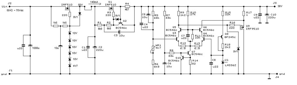

Ohh, the final schematic is superb work, indeed!!! I can think of nothing to add/change. I will put one together as soon as possible. To tell you the truth: I think even NP is a bit amazed🙂
steenoe said:Ohh, the final schematic is superb work, indeed!!! I can think of nothing to add/change. I will put one together as soon as possible. To tell you the truth: I think even NP is a bit amazed🙂
seems that I'll embrace benefits of "needlepoint" protoboards this days, just to make final adjustments to shunt reg schmtc ;
after that , all pcbs will be finished soon ; ya know that you'll be ........not exactly beta tester,just because all beta testing is long time ago finished, but certainly beta builder ;
you can wait that long.......few weeks ,in fact.

crummy image

off course- there is slight mistake with position of 9V1 zener at gate of last (shunt ) mosfet .
it must be k to + and a to gate (via 220E) , not like it's drawn
ZM -as master of disaster
