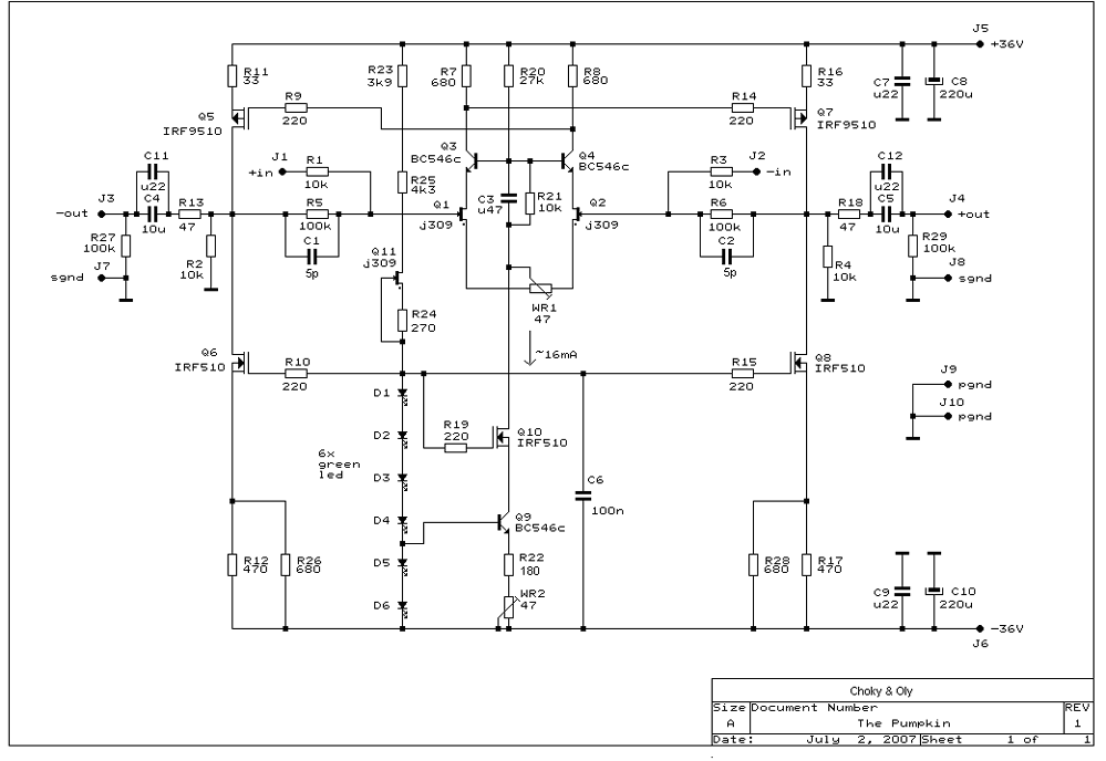

to all : with one really minor change ( bias point for little bjt in middle CCS) Pumpkin schmtc is finished . PCB guru,also known as Oly , is on the move .

first and last time
full Pumpkin schematic - active part
shunt reg(s) in few days

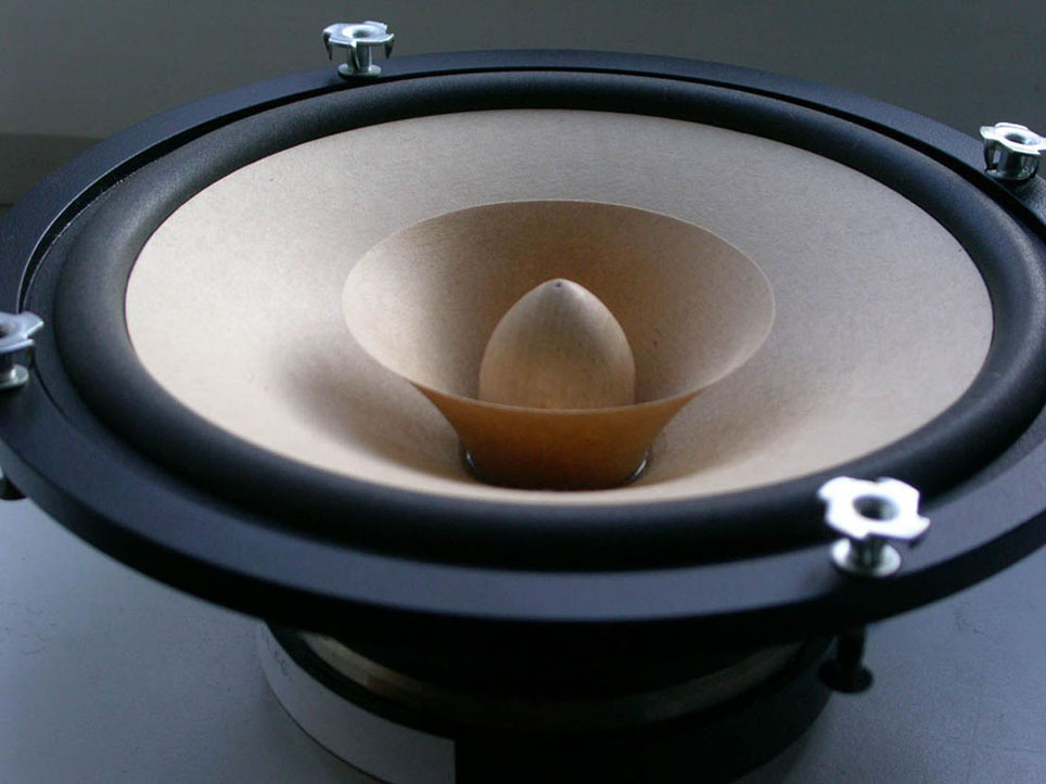

HeHe,
Look what came with the post yesterday. :Pumpkin:
I'am very exited to share Igors thrilling experience.
Will be as soon as I reach my summer residence in France.:cool:

Yes indeed. They seems to be very well made.
Thx for the recommendation.
Actually they look better than on the picture (delightfully transexual).
I plan this combo : Pumpkin-F4-sonido.
Manu.
Mpmarino : would the pumpkin be able to drive an F4, thats the question?:devilr:

Nice looking speaker Manu! I hope her tone is as nice as her looks.:)

If you aren't sure that you need or like or can afford place for big horns for them (and that is without doubts best solution) , you can always pair them with Eminence Beta 15 ( dirt cheap in Serbia,at least) on OB ........ JamesD is man responsible for Quasar variant , so attractive for me ;
somehow I have doubts that :Pumpkin: can drive F4 ...........:hot: :devilr:
