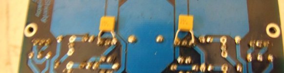

I've done everything you suggest and there is absolutely no change in the symptoms.
I am at a loss on this one.

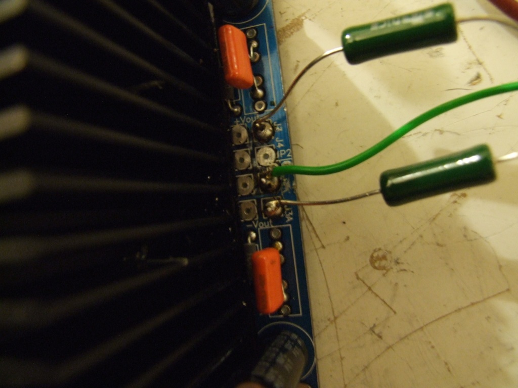

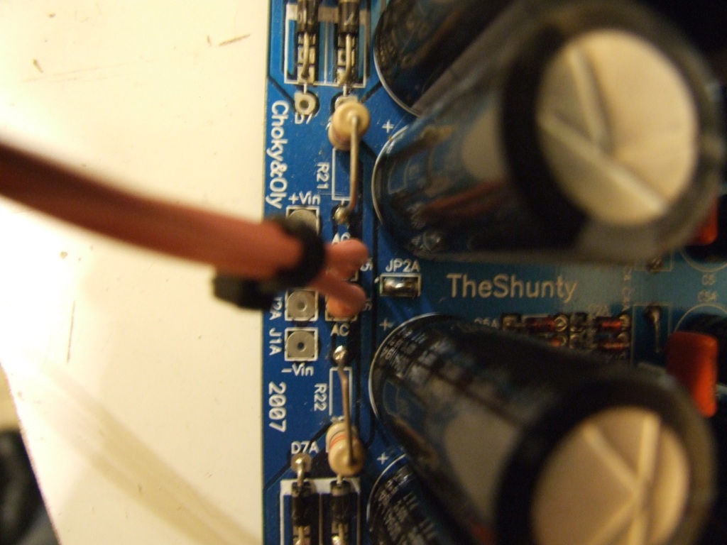

Ive only got JP2A connected. Not JP2. Ist it EITHER/OR or BOTH.
PLease bear in mind that I have removed this Shuntky from its case to try and figure out what is wrong.
well ....... Gremlins on work ;
there is no way that pcbs are so trashed that voltage is ok , but oscillation is here - on all 4 legs .....
try any adequate TO-220 non-darlington transistors instead of darlingtons
to make that possible and adequate - solder additional 390R resistors across R12 and R12a
What I cant understand is that the current drawn through the two fuses is only about 146mA, with the 470R load resistors. Why is there such huge ripple (100mV) after the CRCRC filter. If you remove the fuses and measure the output of the CRCRC filter with a 500mA load it is CLEAN.
