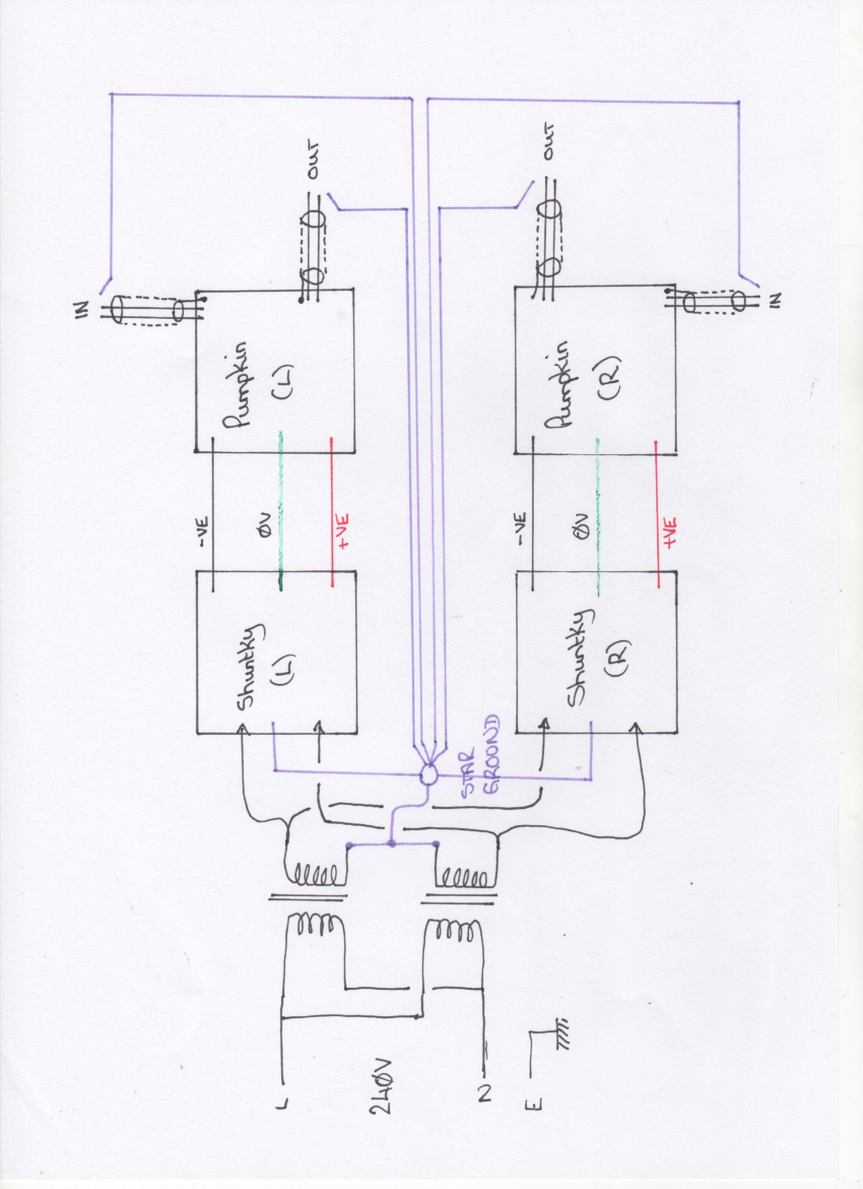

Zen, Can you provide a line drawing of how you connect up your Pumpkins.
I'm using a single mains transformer with two Shuntkies and two Pumkins. The only common point is the transformer.

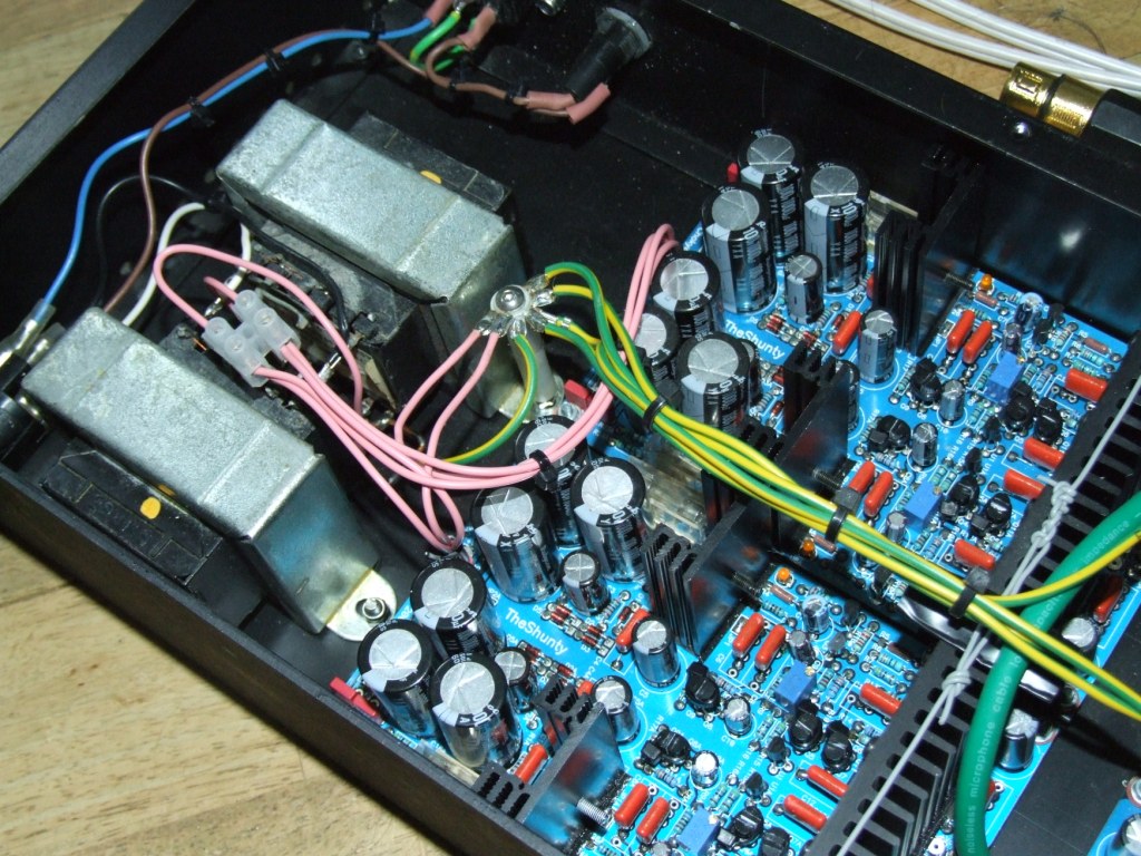

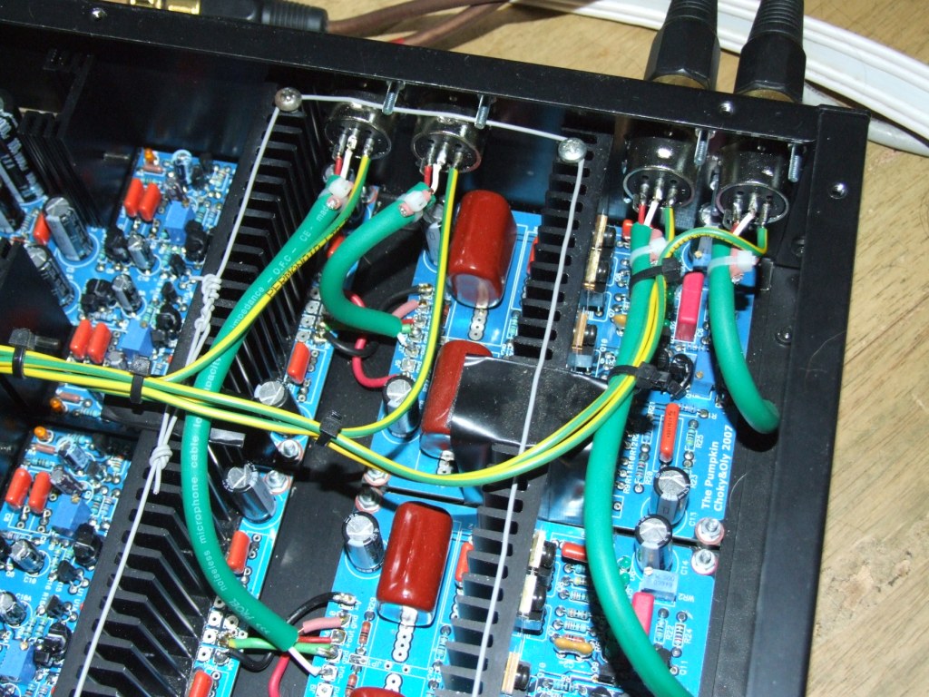

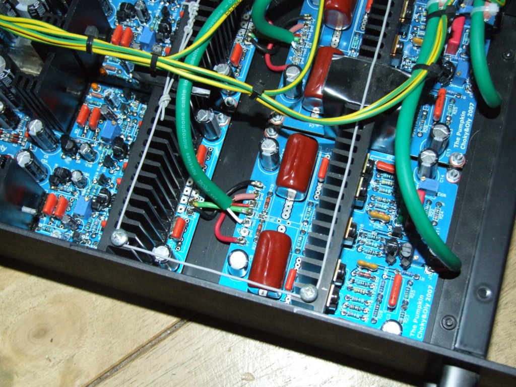

ZenMod,
After re-routing all the 0V connections the Pumpkin is still very noisy.
I have got it configured so that all 0V are connected to a single start connection at Transformer 0V.
Measuring the noise at the output of the Shuntkys, there is a considerable 50mV of noise at the DC (both + and -) of both Pumpkins.
This occurs even with the inputs shorted.
Next step will be to try a regular regulated PSU to see if I can improve on the noise.
The STAR 0V is on top of an insulated pillar and is not connected to anything other than the star.
You will note the odd transformer arrangement - this is because I had 2 x 40V transformers going spare.
Andy
Andy
