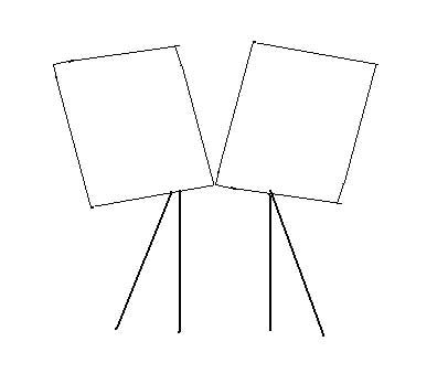

Mhh. I thought about this while I was waiting for my post to be released by a mod. The error is exactly the same on both Shuntys. Its likely I placed a part wrong. I recalled my last steps and altough I'm not sure there is a possibility I mixed up Q4/Q5 Q6/Q7 Q4A/Q5A Q6A/Q7A pairs. I prepared the Q4/Q5 Q6/Q7 pairs first and may have placed them in Q4/Q5 Q4A/Q5A. Unfortunateley this means unsoldering 8x6 legs, break up pairs and check. 🙁 🙁 🙁
Abraxas336 said:Mhh. I thought about this while I was waiting for my post to be released by a mod. The error is exactly the same on both Shuntys. Its likely I placed a part wrong. I recalled my last steps and altough I'm not sure there is a possibility I mixed up Q4/Q5 Q6/Q7 Q4A/Q5A Q6A/Q7A pairs. I prepared the Q4/Q5 Q6/Q7 pairs first and may have placed them in Q4/Q5 Q4A/Q5A. Unfortunateley this means unsoldering 8x6 legs, break up pairs and check. 🙁 🙁 🙁
don't do that ;
cut thermowrap you used for tying them , then gently bend top of each transistor body against other one ; wipe thermo-conductive goo if you use it and try to read marks
