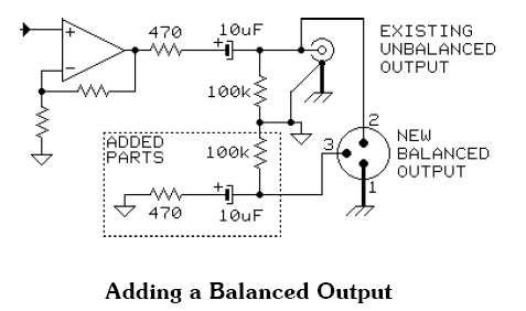

look at Jensen and see that psuedo balanced amounts to one extra resistor and one extra capacitor.
It's a very cheap way to allow a balanced input to perform as a balanced input should.

what Andrew wrote is pretty much correct ( look here , if you didn't already - http://www.jensen-transformers.com/an/an003.pdf , and look at that site for more interesting documents ) .
just few things :
- I'm strong proponent of xformers , feeling things in way that I put xformer in signal path whenever I can , sometimes even without thinking are they completely adequate for task/implementation position
; one example is - even if output impedance of cheap CD player isn't low enough , puttin' phone repeater xformer (ancient 600:600 nickel toroid thingie) can spice sound pretty well , and make it pretty listenable ...
is bal/unbal and unbal/bal converter itself , but also pretty good "paraphase" stage .....
you don't need to ensure bal signal to it , to ensure proper functionality , even if some parameters are certainly worse than using proper bal input scheme . SUSY functionality will suffer ( ie. will not be in full blast amount) but - in which way compromise will be smaller ( worse sounding) depends really of particular case ;
meaning - is it better to use xformer on source side ( good xformers aren't cheap , and there is always question is preceding stage able to feed them) , or is it better to use "not entirely SUSY" ( ie. unbal feed to
choice is to you ...... if some element in chain is unbalanced , you need somewhere transition to balanced ; where is most appropriate - sometimes only matter of money involved .
my advice can be - finish first thing first - use RCA-XLR cables made in whichever way you want - for enjoying your newly made amplification chain , then experiment with most adequate ways of converting your source to balanced one .

I've spent some time looking at Jensen's document an003.pdf and a few things asre making more sense. This .pdf article gives four options for unbalanced output to balanced input. The first (2.1) is a simple cable, configured *exactly* as the guy in the shop said yesterday, which also appears to be how Douglas Self recommends on his site. (I presume the differencefrom what AndrewT was recommending is that 2.1 is for input to the pumpkin, Andrew's suggestion for the output from it. So "send end" was correct for both 🙂 ) Unless anyone advises to the contrary I'll follow Jensen for input and AndrewT for output.
For the future, though, I'd like to give Jensen's 2.4 a shot... This is the circuit ZM posted in post 2692. Is it too off topic to ask how you would figure out what to use for the values of the "added parts" if you had a commercial DAC you wanted to use this trick with?

jensen 2.4 shot - Papa's schm is simpler , omitting both 100K resistor and cap .

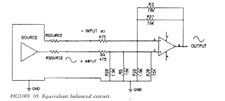

Stupid question about the Pass A75 article... Figure 10 on page 12 (which is the circuit you posted earlier) shows two triangles; I presume one represents the source, which in the article is a preamp, but in my context is the DAC, but does the other represent the amp we're feeding, which in this case is the pumpkin? If so, then how would we connect R3 and R27, which appear to be feedback resistors? (Or did I misunderstand completely and this triangle is really an opamp?)
Thanks again

OK, thanks. Seems pretty straightforward. (Apparently I had part of the idea...) Knowing this value presumably substitutes one of the resistors

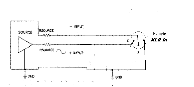

redrawn a little ;
off course that you can redraw it even simpler ,with resistor tied directly from XLR pin3 to gnd
