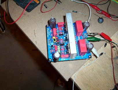

Regarding offset
I have been able to get the VoltM DC readings down below .5volts or so with WR2, and .2 or .3v from V+ to V- using WR1 inside of circuit method.
These don't look like great numbers, and is always drifting a little.
But I can't get zero, so I don't know what's acceptable.
I would like to know what other have achieved here if you got the time. I am just shorting the inputs, so I dont know if it will behave better with a real volume pot, and sealed up better than my unfinished case.
At least I didn't blow all the fuses out...YET!

:clown:
that's good enough for Pumpie outa box .
now - you can make a box and , with all pcbs cooked inside , finish procedure .

Sweet.
I am still nervous about the g to s voltage variance, but I will look for you data - it seems I am off on Q5 and Q7 pairs. I have been checking the nearby resistance figures, and look okay at a micro level.
