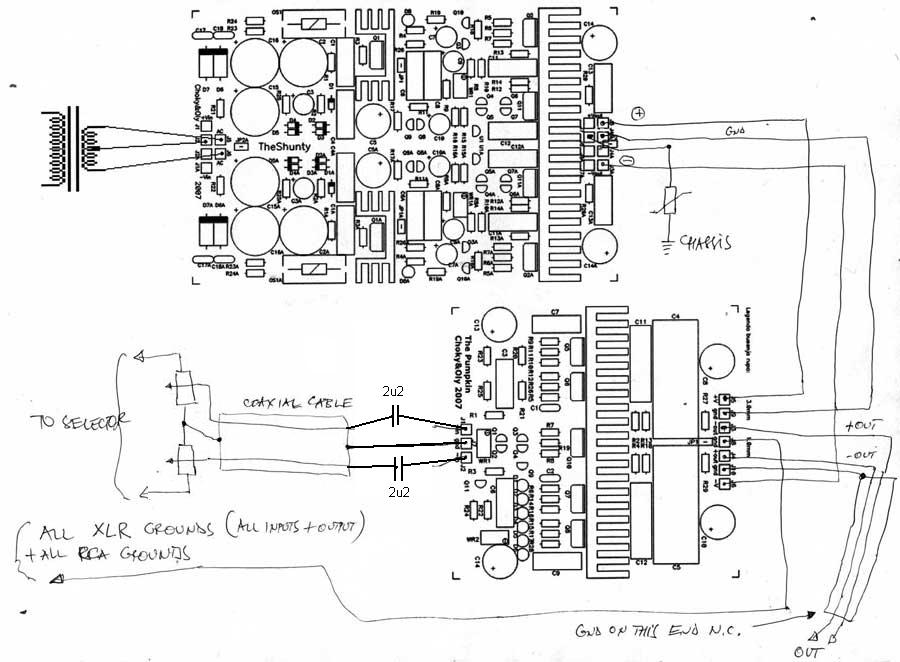

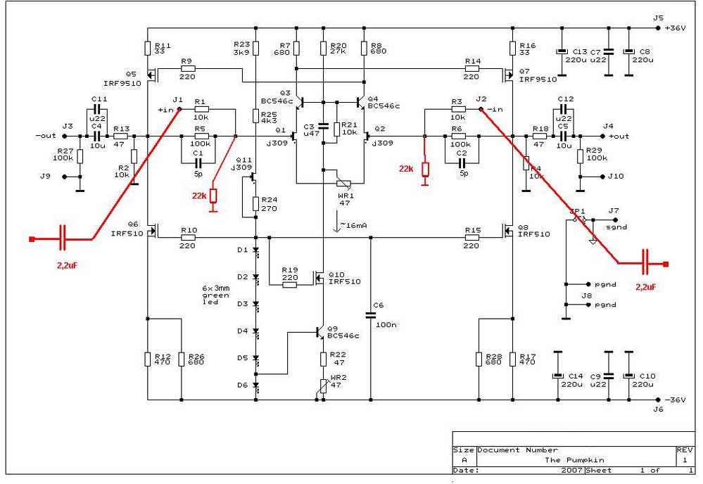

Drawings for MITHOMAS
1/2
here is schematic , dunno did I posted it already ?
n next drawing you'll see how and where to situate input caps ;
22K resistors - just solder them on bootom of pcb - one end to jfet gate , other end to nearest gnd point
1/2
Thanks ZM,
anyone know where to order those XLR jumpers Papa uses to tie pins 1 and 3 together? Is there a name for them?
mithomas said:Thanks ZM,
you can't find anywhere locally piece of Cu solid wire with adequate dia?
where this world is going .......
MAKE YOUR OWN JUMPERS !
(then tell to all your friends that's last batch of jumpers from personal stash of Baron Krupp ....... )
What I have fashioned so far seem a bit ackward in real use.
I will keep working to try to please the frugal and intense ZM.
mithomas said:What I have fashioned so far seem a bit ackward in real use.
I will keep working to try to please the frugal and intense ZM.![]()
naah ....... I'm just (!!) stubborn 😉
I hate to pay for finest FiFi fog ...
been there .....
or just use two XLR cable connectors , with shorted pins 1&3 ;
these are certainly fancy , and still useful later ....
been there .....
no I am using F4 with XLR with vampire male with RCA stuck in the end, and internally shorted. Of course with Pumpie, I am not sure I want to build in RCA set for CD player, or just use a shorted homebrew XLR to RCA cable(think that's what your saying). Just thought a good jumper would do the trick, without being weird. I also assume there is no penalty for dual XLR outs here....But will re-read cookbook later.
