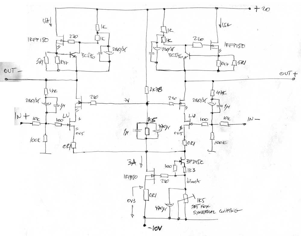

in that case ....... take this - SUSY F3 .......... simplified ....... and without Iron
( off course - ordered by Steen ...... who else
you can make it even with single supply with 30Vdc , if you put caps on gate and reroute LU gate resistors to top of tail CCS

Re: SUSY f3
you can't find mucho ; it's drawn tonight ...... after few mails from/to Steen

Got the LU's. Dont undestand much about what the PS would look like, assuming your considering using just v+ with mods for 30vdc.
H have 22v and 18v trannies available. Of course the -10v has me even more confused. Of course it's late over there. And I need to get a clue.
I am still listening...

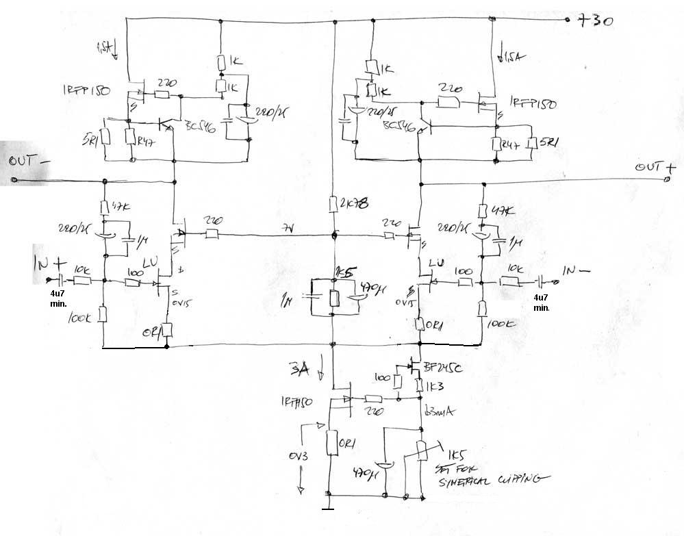

I'll make another schm for single supply - tomorrow ...... now I really must go to slllllllllllllllllllllllleeeeeeeeeeeeeeeepppppppppppzzzzzzz
( off course - ordered by Steen ...... who else)

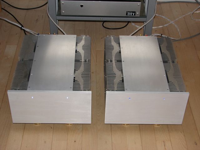

Suddenly I found myself with these two cases vacant for something special and that susy thing is just what i was looking for😎 Just gotta find trafos with correct secondary voltages.

I presume that we'll have few things to solve on the fly .....
anyway - count on that , and leave enough place in these ugly and small cases for final adjustment ;

(btw - I think that - if you stay under 100W/ch. with dissipation , yu can squeeze both channels in one case ........ at least looking at heatsinks ...... not really counting on space in between

The bigger the better. A big honkin' CLC supply would be my first bet. Second choice is a cap multiplier ala ZenV9. The advantage of the latter is that the multiplier could be set up to regulate the neg. rail to 10V by use of a Zener 😉 Pretty convenient and probably the easiest way to go, avoiding to use 2 trafos.

Steen - depending of what dreky spks you intend to use , you may find interesting connecting power resistor in range of 47-100R between outputs .....
