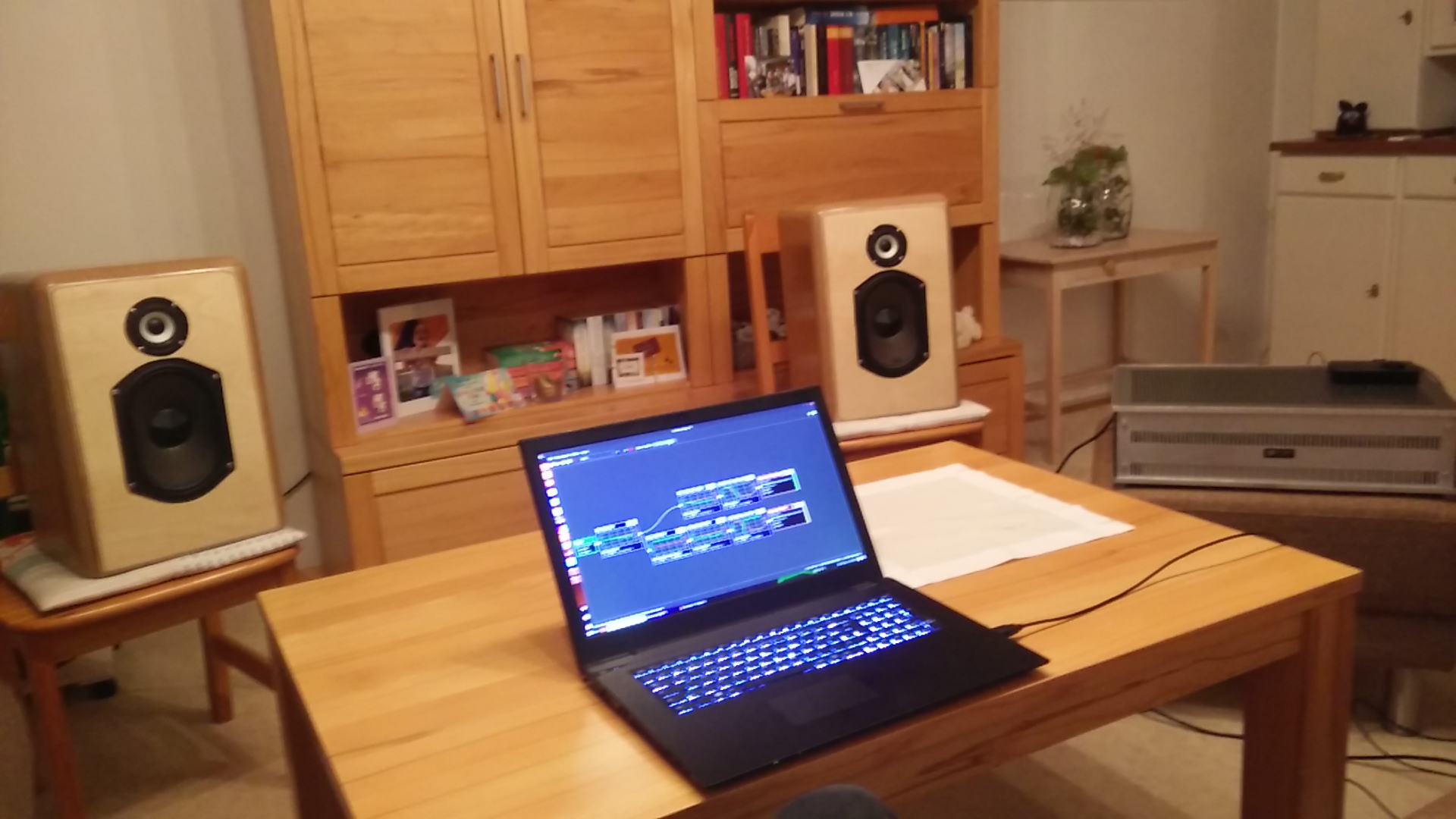

Editing sound in real time
Sorry, bit of a problem for me.
VLC will play a pink noise .flac file OK, but altering the parameters in in a crossover module does not affect the sound. What have I done wrong?
PaXoverRack doesn't appear to be writing the modules into /home/pi/.config/pulse/default.pa. I set up a "Speaker_Test.paxor" file with
Input >> LR-4 Highpass >> LR-4 Highpass >> LR-4 Lowpass >> LR-4 Lowpass >> Output modules - the idea being to set the first and last modules to protect the speaker(s), and play with the middle two. Right now, I have it hooked up to a TPA3116 amp and a small 2-way speaker, and was testing the outputs of the soundcard. It works. I have to say, up to this, it has been way less of a pain in the wahine than other forays into multichannel pi audio I've done - I guess Murphy will have his due.
When I try to change the F3 frequency in one of the modules, and click Load-Module, the following error appears in the console:
There are no entries in the default.pa file with string "PaXoverRack". There is a /home/pi/.config/pulse/default.pa.backup_by_paxoverrack file, so PaXoverRack is able to write to the folder.
The apt-get install worked without error. I altered/added the recommended lines to /etc/pulse/daemon.conf.
and, additionally:
If it helps, I have had to manually run, in LXTerminal:
a few times, after a reboot, to get pulse to see my usb soundcard. Not every time, though.
Pavucontrol sees the XS71U Analog Surround 7.1 on the Hardware tab, and has Analog Surround 7.1 Output + Analog Stereo Input under XS71U on the Configuration tab.

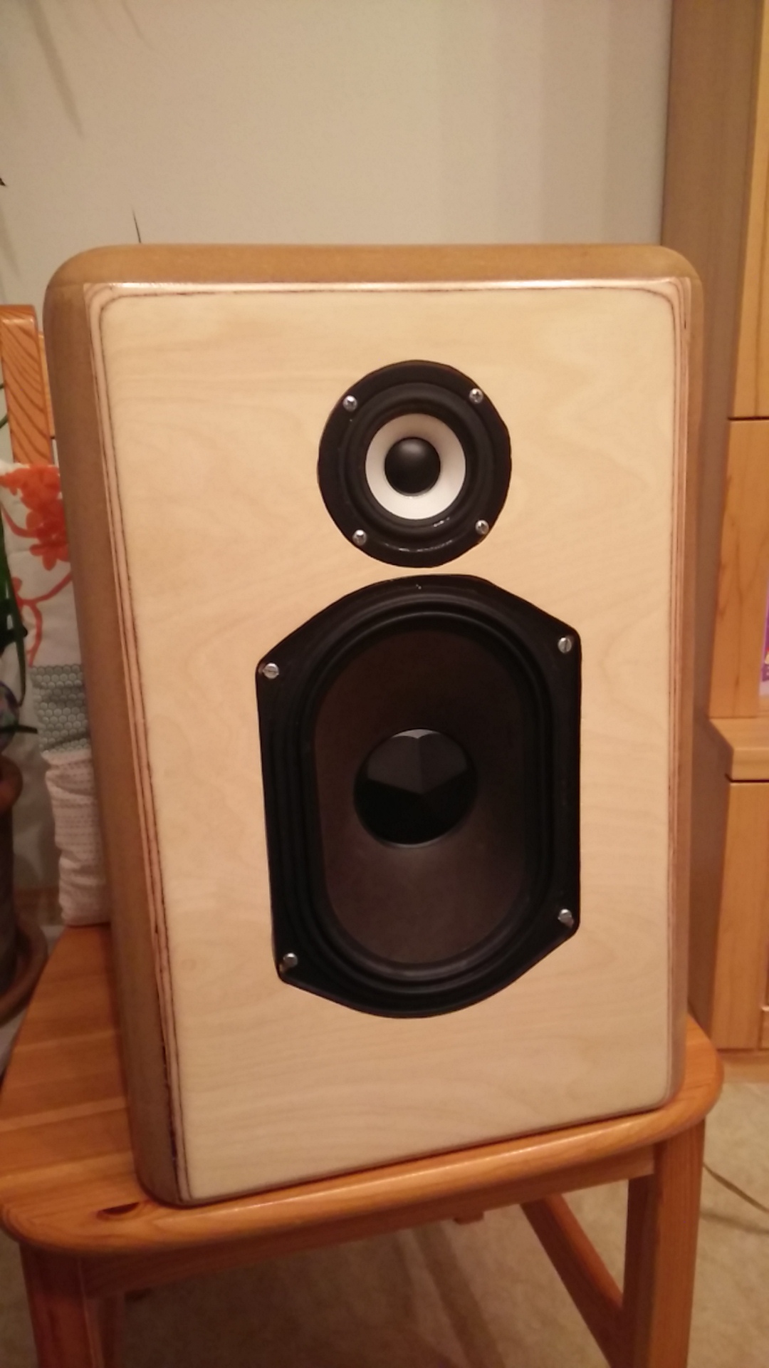

Just a quick update... The last few days I revived my old Fullrange+Subwoofer monitor speakers I built around 10 years ago. I did some major cosmetics to them, closed the bass port and gave them nice rounded edges. The speakers are Tangband W3-315 and W69-1042. Today evening I finally had the chance to set them up temporarily in the living room of my parents (where I do the woodworking because my dad has all the tools) and try my own software the way it is intended to be used - not just as a parametric eq but actually as a crossover 😀
I'm quite pleased how it worked out. Though I have no measurement microphone tweaking the setup by ear was done in about half an hour... Being able to immediately hear what I was tweaking was immensely helpful. So far I like it very much. 🙂
The measurement portion of the software is up next and once I buy a mic I will report back...
