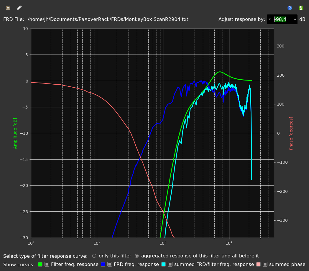

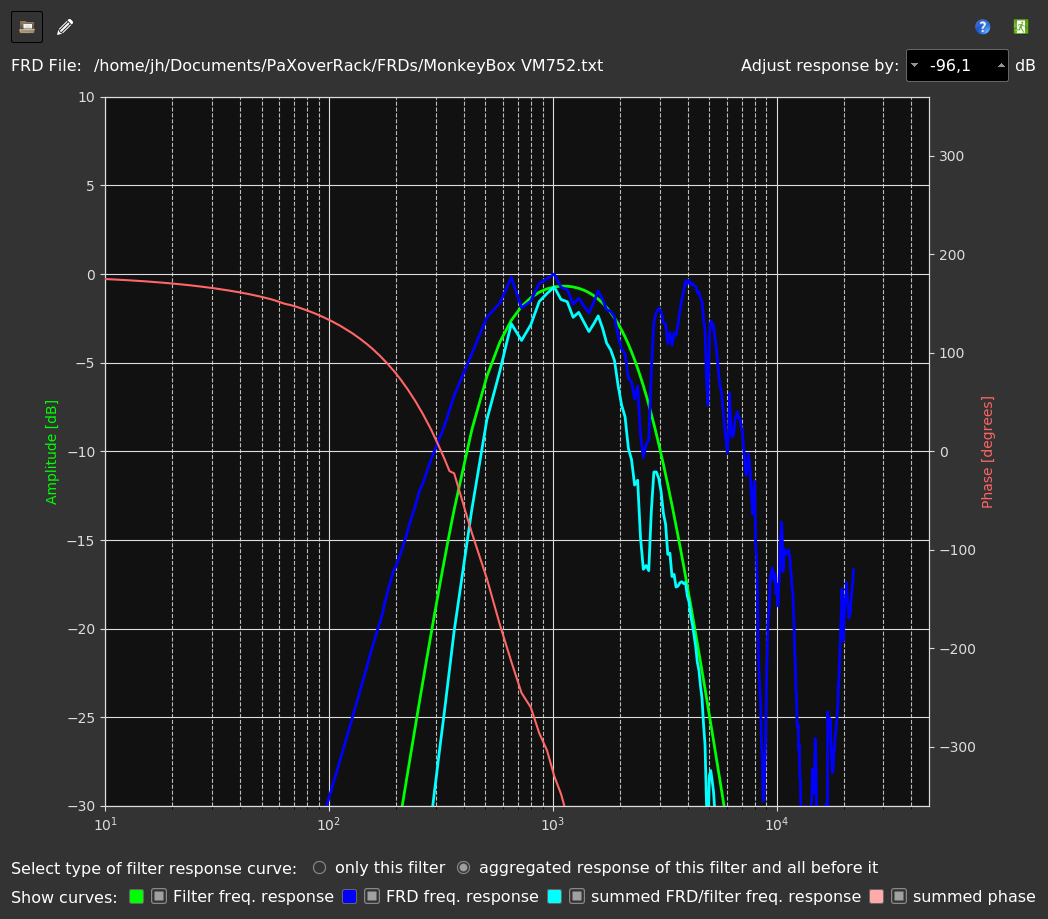

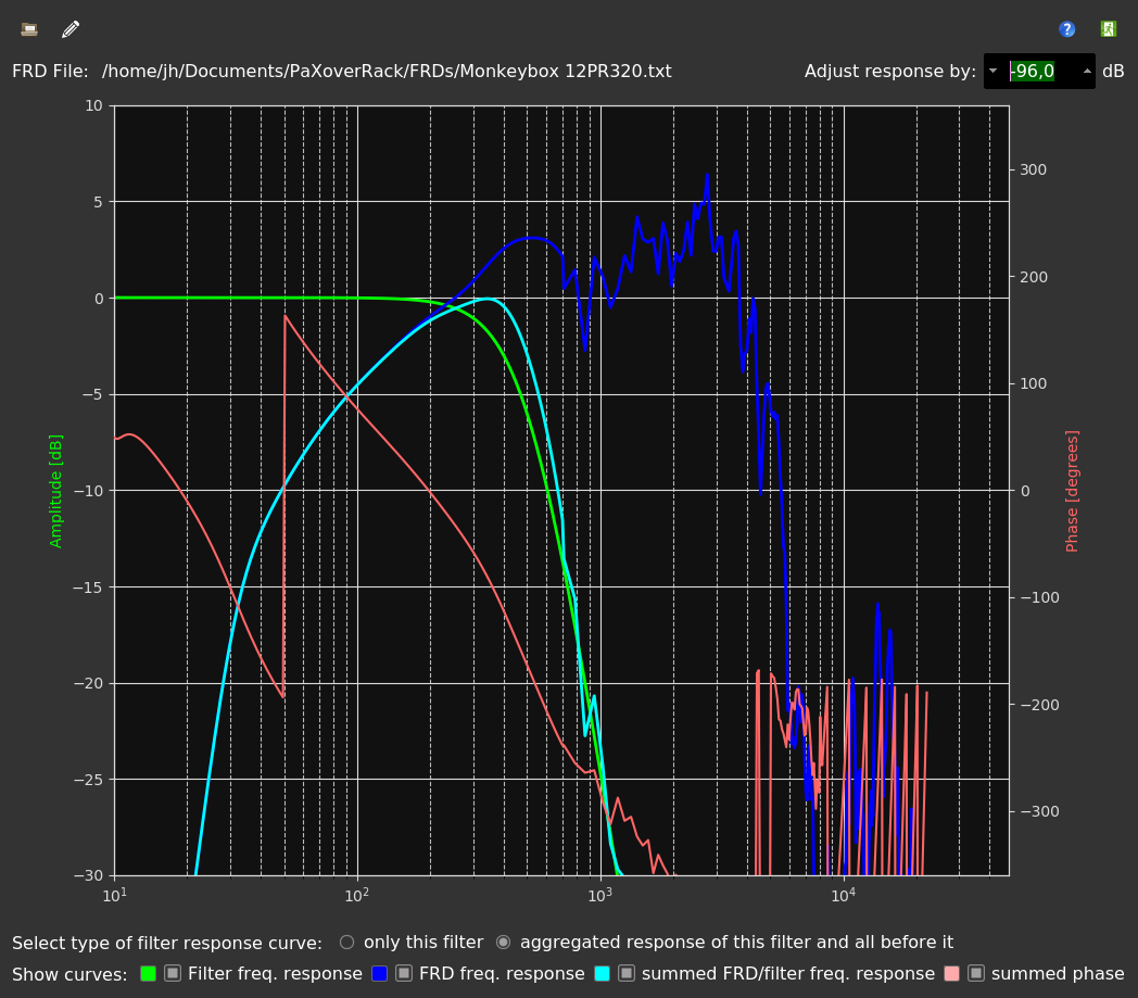

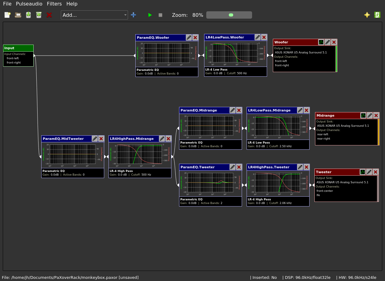

To whet everybody's appetite and maybe to get some comments on the design...
I still need to do some research how to sum up the phase responses before I can release these features...

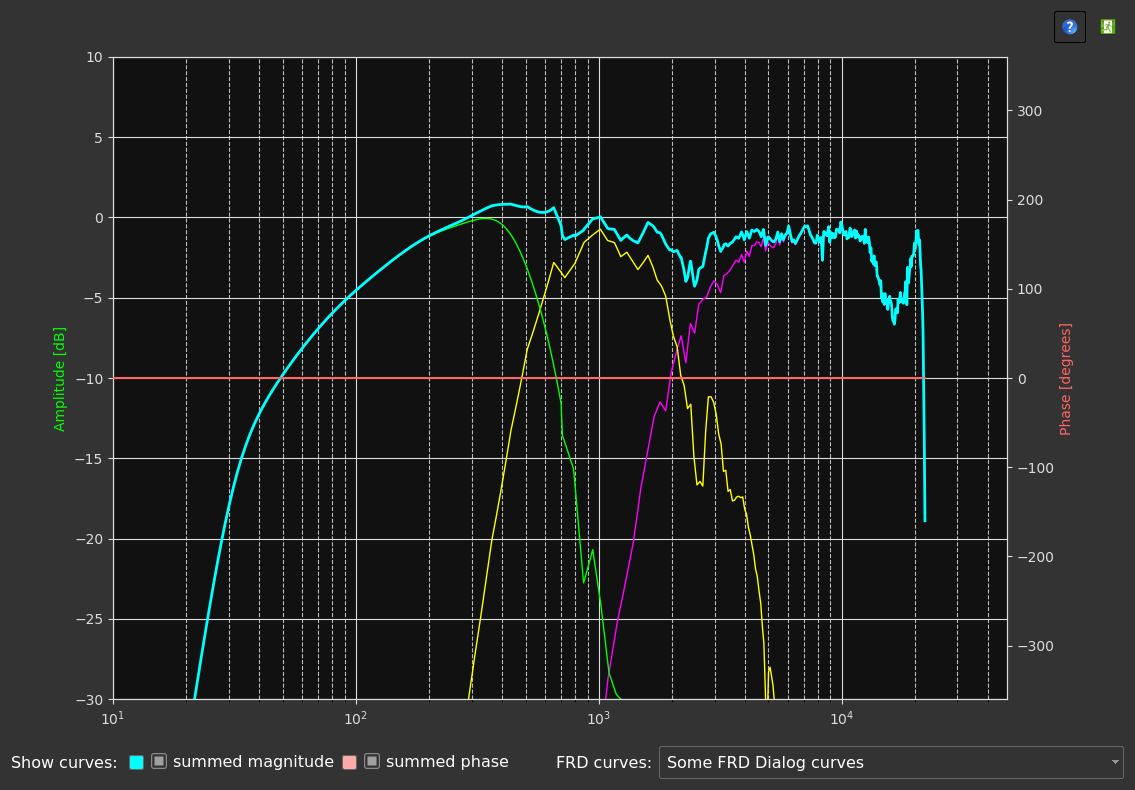

Question for the experts: won't you have to measure the summed response anyways as the single driver measurements don't have timing information embedded into them, i.e. don't know about the driver<->microphone distance? Will probably be a lot smarter once I have a microphone available and can do some hands on testing...

Regarding the missing calculation of phase shifts of delay filters I will have to first wrap my head around it...
Yes, the summed response will enable you to establish the relative distance, i.e. the distance between the acoustic centres of the drivers, a.k.a. the offset in the Z plane at the x/o frequency. That distance is not the same as the physical distance between the voicecoils of, say, a tweeter and a midwoofer.
In a conventional 25mm dome/16 cm midwoofer, the tweeter is located at Z=0 and the woofer some 30 mm behind that. I suppose for your software you have to convert the distance into milliseconds.
Good Luck and keep up the good work: I haven't tried it yet, but the GUI looks superb!
Eelco
Eelco
How would you go about this when doing the measurements? Do you change the delay until you don't have dips in the summed response?Yes, the summed response will enable you to establish the relative distance, i.e. the distance between the acoustic centres of the drivers, a.k.a. the offset in the Z plane at the x/o frequency. That distance is not the same as the physical distance between the voicecoils of, say, a tweeter and a midwoofer.

The delay is experimentally established in any x/o simulation program . First a measurement is made of the woofer separately without any crossover, then, without moving the microfone the tweeter is measured. Thirdly both drivers are simultaneusly measured without moving the mic. The non filtered summed curve will show a lot of valleys and peaks, but that is not problematic.
In the simulation program, LspCad 5.2 in my case, the summed curve of both drivers is overlaid with the combined measurement. This usually start with some discrepancies between both curves. After experimentally adding delay to the woofer in small steps, after some 30 mm or so both curves start to converge.
To be accurate also x and y placement of the drivers relative to each other must be defined.
