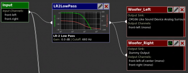

Hi folks, new user here.
I've got the SW up and running with a Vantec 7.1 USB card on a Raspi 4.
I want to eventually output discrete 6 channel audio for a stereo pair of 3 ways.
Selecting just one channel for the woofer filter, for example leads to a dialog:
"You have selected only one channel, do you want to downmix to mono?"
Selecting NO and hitting OK brings me back to the same dialog.
Any tips?
This behaviour is actually correct. pulseaudio can only output to as many channels on the sink as it has input channels. As PaXoverRack is made for stereo use (hardcoded), you MUST have either one output channel downmixed to mono (it appears as two then in the sink's channel list) or two separate channels. So if you don't click yes, the program cannot continue with one output channels selected.
May I ask, why you don't choose two output channels if you want to build a stereo 3-way - you will need two woofers anyway, right?
Thanks Tfive - I think I see what you mean.
Even though I selected "front-left" for the woofer, I need to tell PAX to make that a mono channel, even though it's already mono. No biggie.
Now I've got another problem -
Loaded pulseaudio, and Audacious can play fine with output to pulseaudio.
pacmd info shows the USB audio device and channels, but PAX is now only showing "Dummy" sink for the new outputs.
maybe you set that when the usb soundcard was not attached? open the edit dialog again and see if you can set the output device and channels...
yeah - at this time, the dialog for output sink is either blank and not selectable, or shows dummy. Pulseaudio on this Raspi with multichannel USB output is just flaky. Tried reinstalling pulseaudio and rebooting the Pi. Sometimes Audacious will output to Pulse, other times it refuses, so there is an underlying problem somewhere.

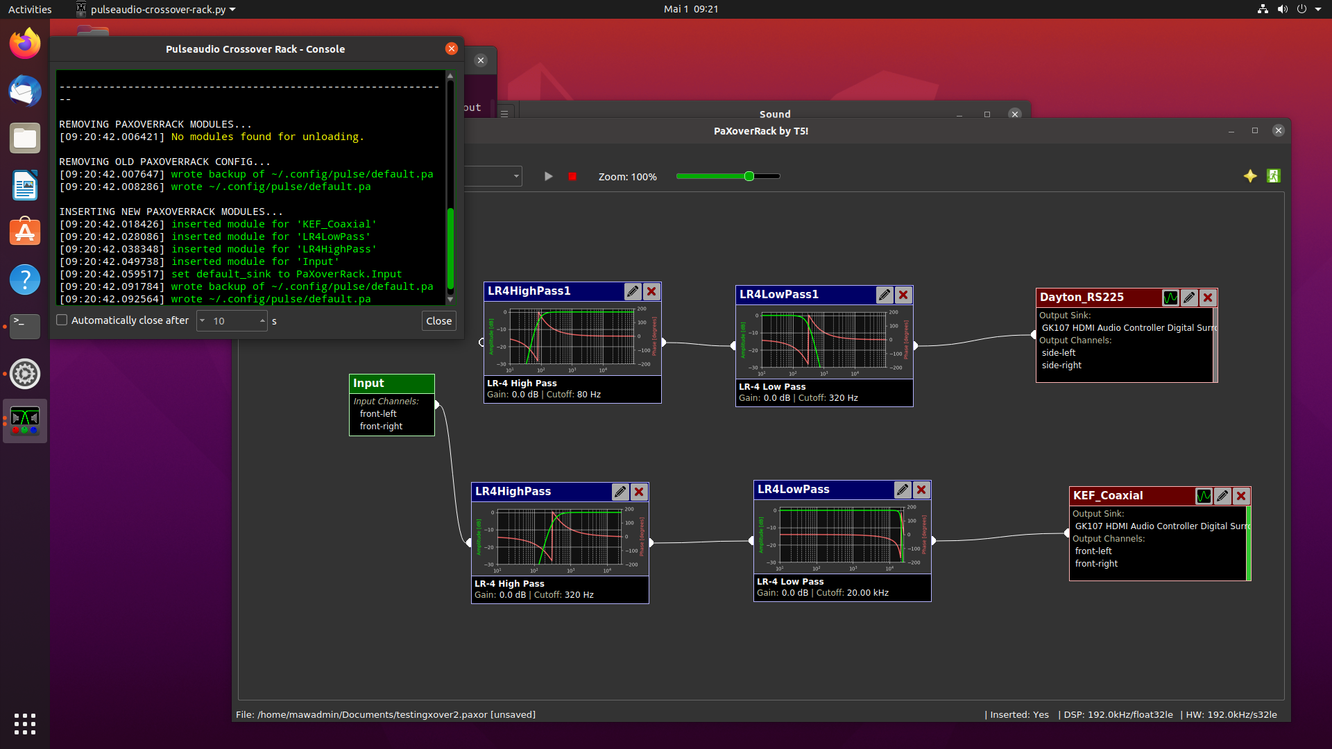

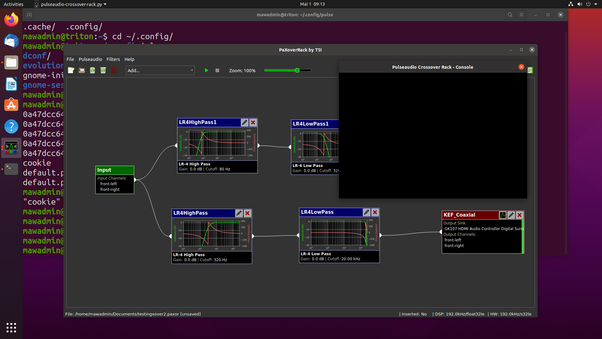

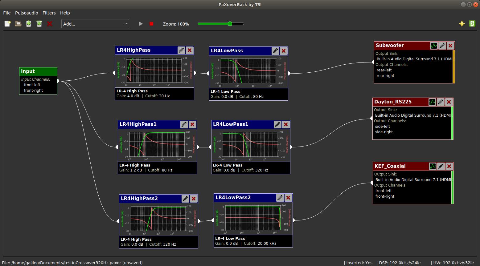

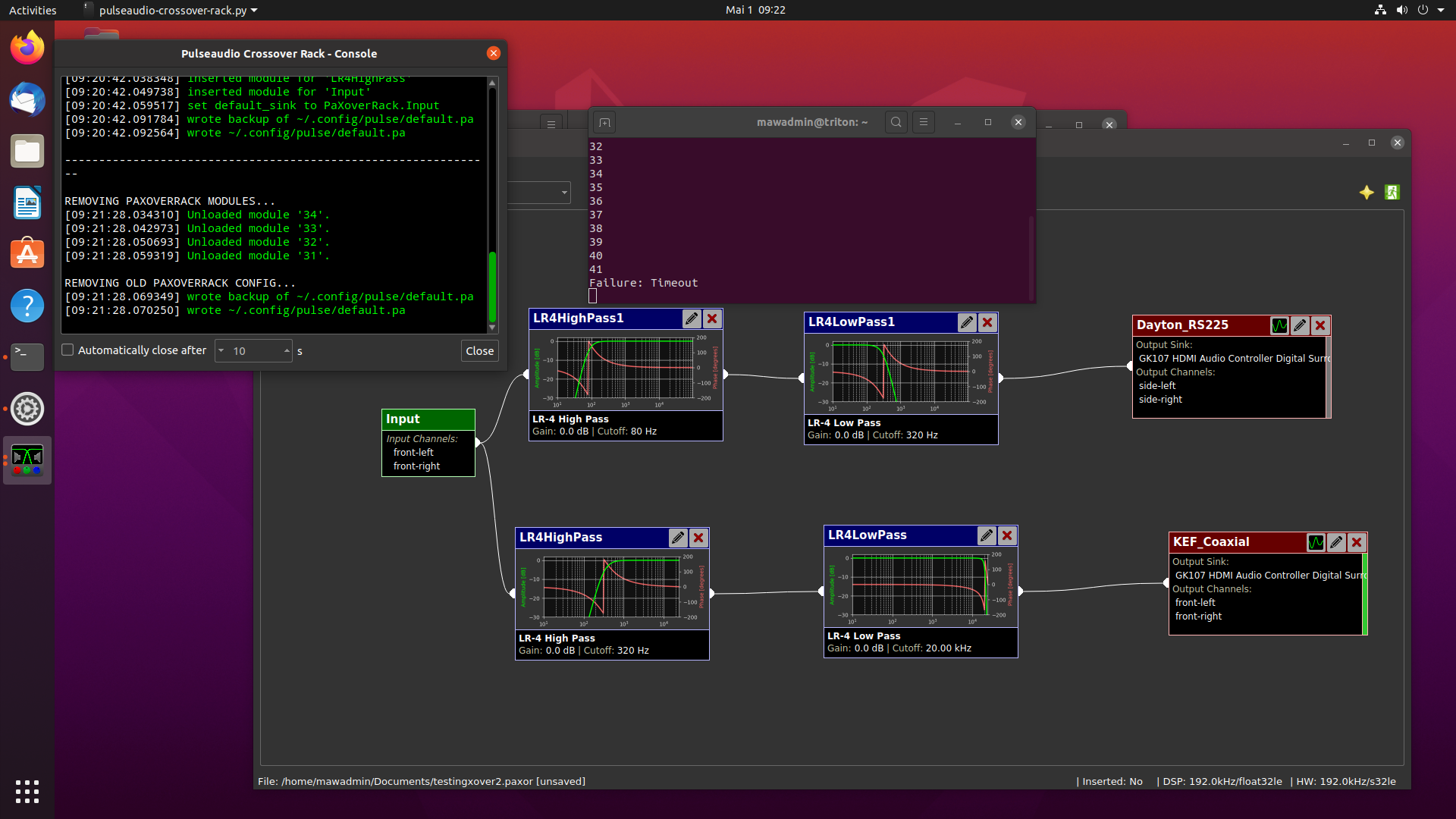

first of all thank you for creating and maintaining Pulseaudio crossover rack. I have been using it for about a year without any issues. Until yesterday, when I decided to switch to Ubuntu 20.04 (I had 16.04 before). I tried to reproduce the problem and I hope you can help me figure out a solution.
My Setup: Three way active crossover for four way speaker (mid and tweeter still have a passive crossover). I'm using the HDMI port of a Nvidia GTX650 to get a multichannel PCM audio signal to a Denon 4520. Here is a screen shot of Paxor that has been working on my old HTPC:
attachment.php
Now when I tried to use the same setup on Ubuntu 20.04 Pulseaudio crossover rack crashes and sometimes even the entire system freezes and I have to do a reboot. If I open up the sound settings the correct audio device is recognized and I can even test each individual driver. My Denon receiver says it is receiving a 7.1 PCM Signal with 192kHz sampling rate.
While trying investigate what exactly causes the problem I first created a minimal working example by using just one way of my loudspeaker to play music:
attachment.php
And this works! It is not depended on which loudspeaker drivers I use (Subs, lows, mid/tweeter) as long as there is only one way. But as soon as I add a second connection from Input to a second branch of crossovers the program and more often than not my entire computer freezes:
attachment.php
If I try to start Pulse audio crossover rack in a terminal I sometimes get a "Timeout error" on std😱ut:
attachment.php
Do you have any idea what the cause is? I would really appreciate some help and if you need aplay -L or lspci outputs just let me know.

But from what SomeDude82 found out i suspect the module-combine-sink is acting up - it does the job of splitting to two input sinks. The module has been acting up for me a lot of times. All the stuttering and desynchronization of audio is most likely to blame on this one as well. If somebody wants to speed up debugging, please start pulseaudio in verbose mode on the console. You will have to set autospawn to no in /etc/pulseaudio/client.conf to do this. Post your output via a pastebin please.
