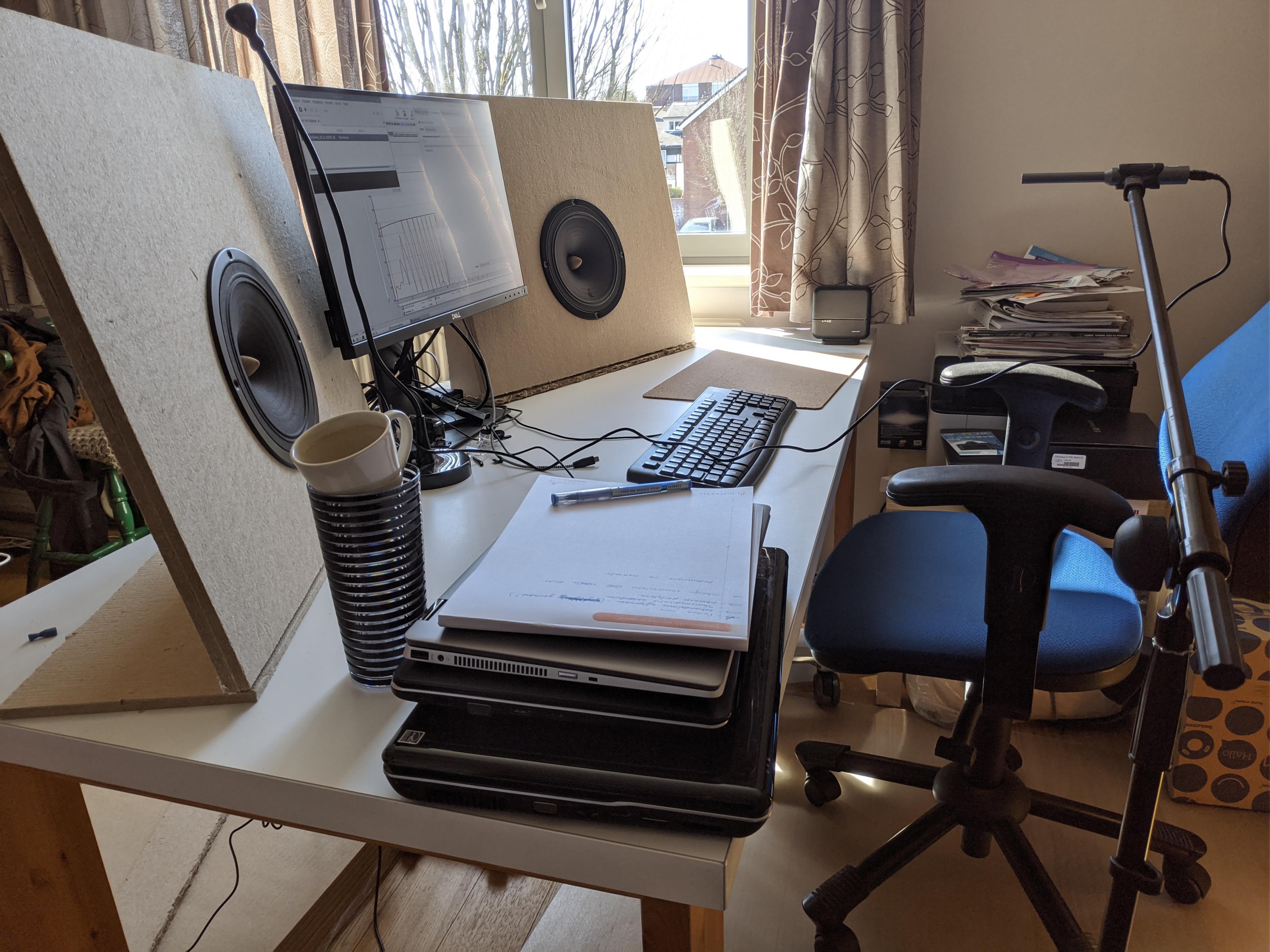

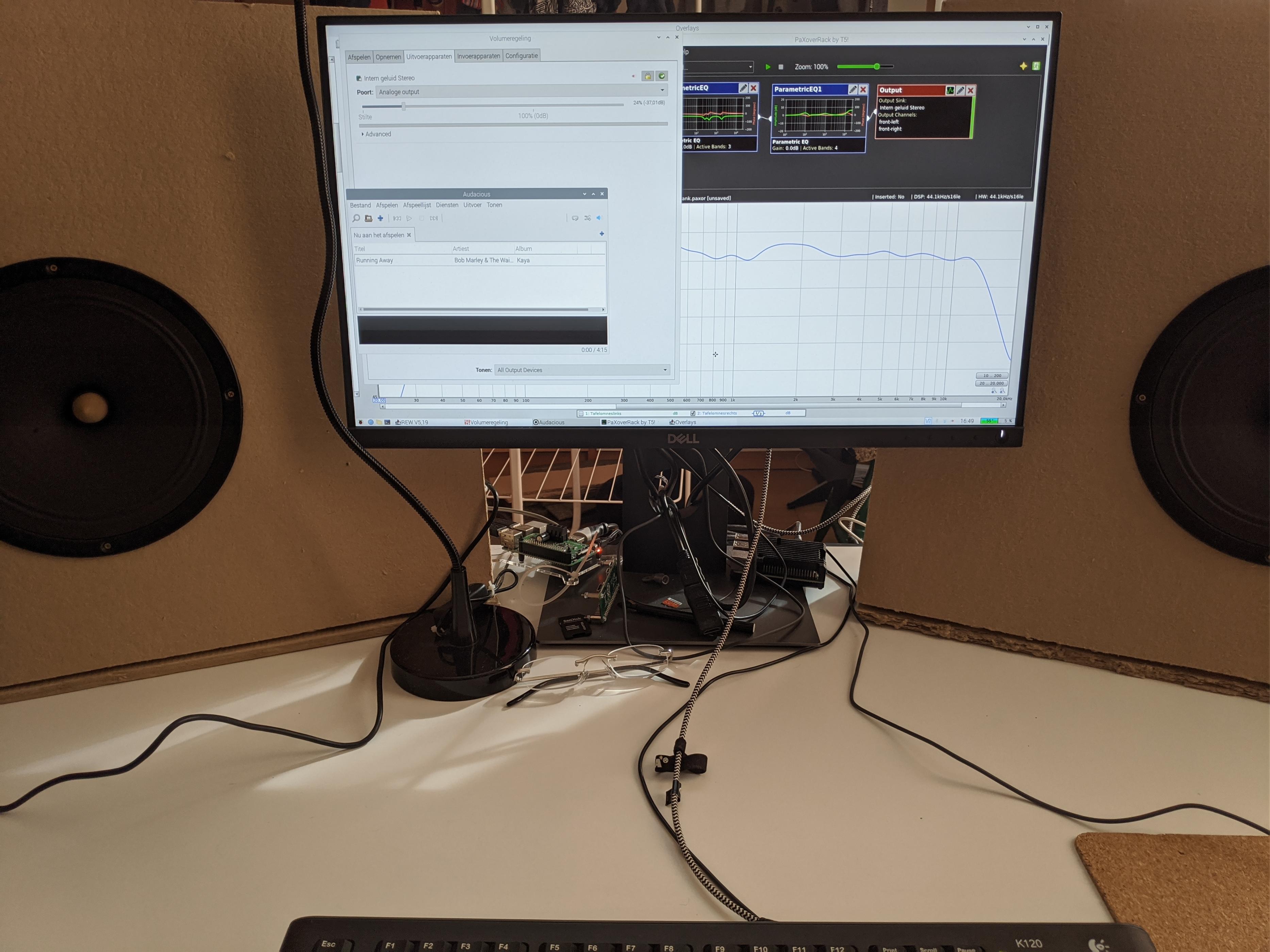

I promised to take photos of my working application of paxor. I built a rough desktop open baffle speaker system for my home office, because my 15" living room horns are in use for Betflix and children's TV.
The drivers are Omnes Audio L8 loudspeakers. More or less fullrange, or at least very wide range.
The open baffles are made of soft fiberboard (weichfaser) which has interesting acoustic properties. Sizes are basically what fits my desk and sort of matches my screen.
The RPI is a 3B (not 3B+), power comes from a normal Raspberry Pi microUSB powersupply. As mentioned, the amplifier HAT is a Hifiberry Miniamp. OS is the current Raspbian.

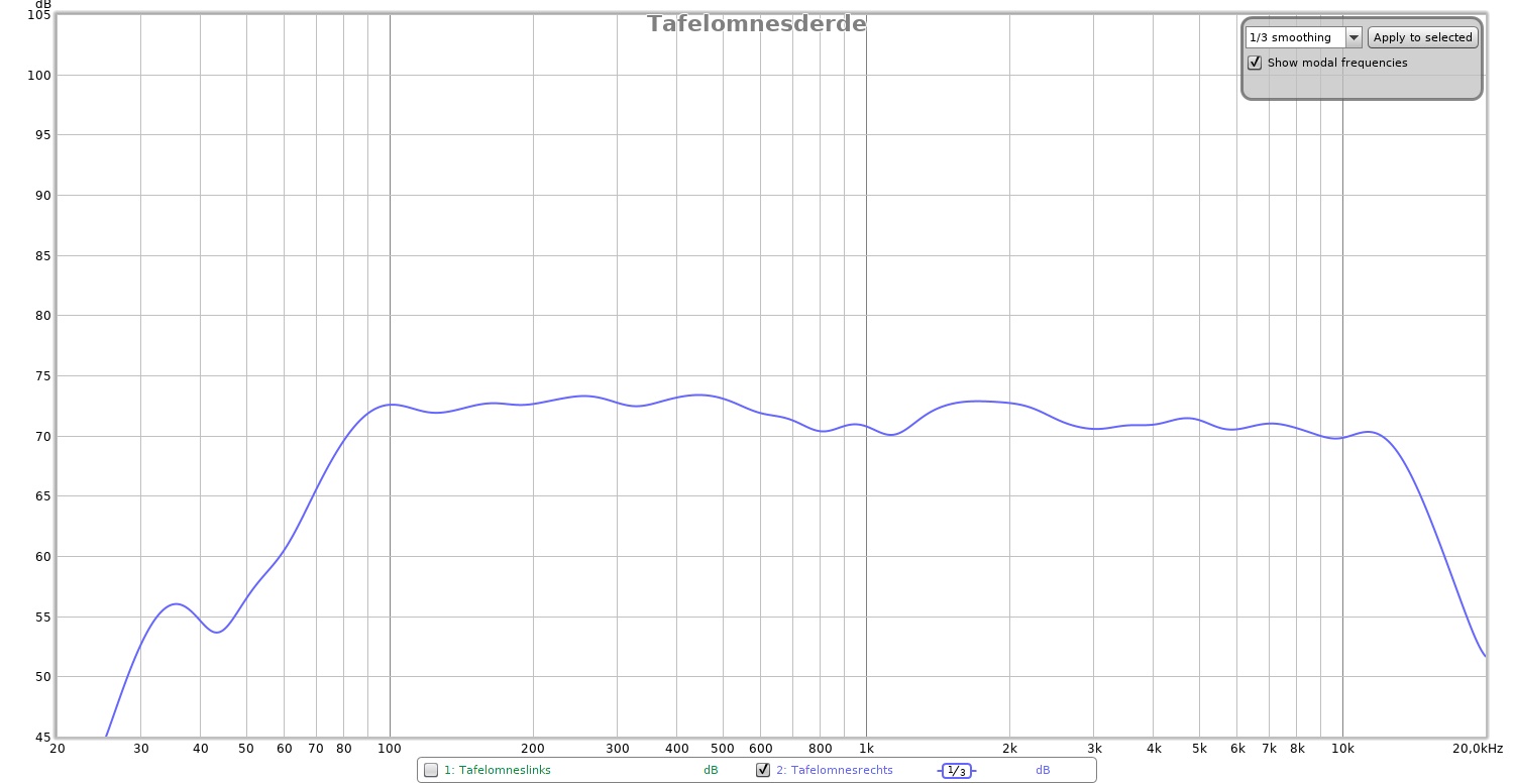

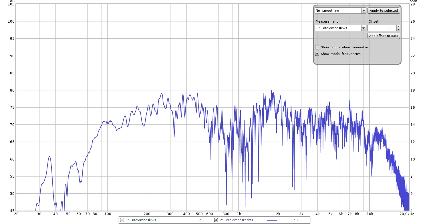

I did measurements with Roomeqwizard and a UMIK1 positioned roughly where my head would be. I did this with the Raspberry Pi itself.
I have been discovering different approaches to EQ design, particularly which level of smoothing to work with. Right now, I am happy with 1/3 octave. This allows focusing on the general trend. After "un-smoothing" the basic curve is always good and then it's easy to identify any remaining problems.
I use 6 parametric filters and one high shelve. For now, of course. This was maybe 15 minutes of work in REW. I should, and will, work in paxor after that. Inputting this is paxor was easy.

What can I say about paxor? After installing and setting up EQ, paxor is out of the way, in every way. The sound quality of the recording is not hindered, the Raspberry Pi is not over-stressed by doing EQ, the signal into the amp is good, the speakers sound as good as I know they can.
I can access the full desktop over VNC to change settings etc, or select music. I can also set up dlna/upnp for a more fancy remote operation.
I like it.
Images: the view from my desk chair, working out a measurement setup, raw response, result equalising in 1/3 octave smoothing, and the unsmoothed EQ-ed result.

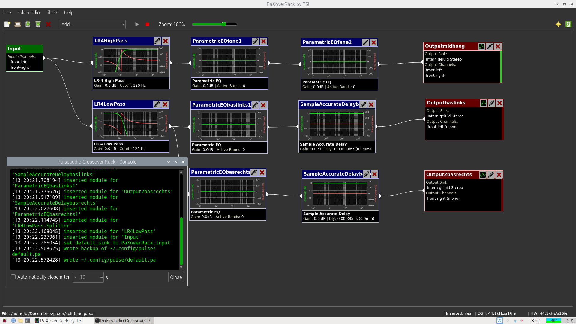

And on with a weird question... Can the signal be split and processed in different ways, in parallel, and then be fed into the same output again? I have had some positive experience with two subwoofers and some delay on one to fight an awful room mode. There is software that uses bruteforce calculations to give a set of EQ settings (individual for each subwoofer) to optimize resulting response in the room. It is usually done with separate subwoofers, but in principle could be done with the main loudspeaker as well.
So I would like to duplicate the signal, resulting in a high-passed stereo signal for the 100+Hz range, and a mono channel low-passed for the 100-Hz signal. And the mono bass channel would be duplicated again, because left and right would need different settings.
I did a quick test and paxor would not let me connect two parametricEQ filters to one output. Is there something I can do to make it work?

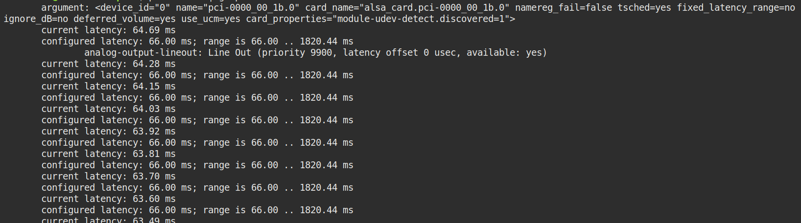

Hmmm, pops and crackle, and it persists a little bit after I stop the audiotrack being played. No more time right now, but needs some tweaking probably. I set all filters of every plugin, so may I have overloaded it. It is the old Raspberry Pi 3B after all. It runs more smoothly with the lastest Raspbian, probably because the foundation has spent more attention to hardware acceleration. It may have made me expext too much. Pulseaudio and LADSPA probably don't use any of that.
I am such a baby, but... The pops and crackle reduce when I take filters out (set gain to zero). It also gets less when playing a lower resolution track (I first tested with a 24/96 FLAC file, after that 16/44.1), and also when minimizing windows and removing the visualisation bar from the music player.
CPU is not too busy, and in Htop there is not one CPU core maxing out. RAM is also not fully in use.
So a buffer issue?
I have a "new old" intel-based laptop with an i3 processor and Intel HD graphics. It is now my main computer, so the Pi 4 is available now. Still, would be good to find the issue and get it working with the Pi 3, as they don't need a heatsink so bad and are a better combination with amplifier HATs.
