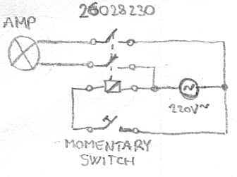

well I bought one of those relays from finder
pn 26028230
it works fine 😀 and costs at a local electrical shop €8.00

"well I bought one of those relays from finder
pn 26028230
it works fine "
What happens when the power cord is un-plugged and plugged back in? Does the relay remember where it was at... or does it default to NO (or NC)
pn 26028230
it works fine "

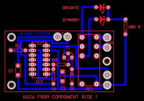

Fun with LED's
kristijan-k, do you know where I could tie in LED's into your circuit?
I was thinking one for standby and another for power indication. Would my relay need to be double pole in order to do this? I was thinking I could connect one of the poles between the standby and power led loops, while the other pole would be connected between the AC line voltage for the amp.
What do you think?

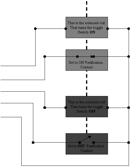

GE RRx relays
These things aren’t exactly what you guys have been talking about, but I thought they might be worth mentioning here. Its a solenoid operated toggle switch made in all kinds of sizes by GE. The ones I used had three connections for the coils; a common, on and off. a 24vac pulse between common and one of the states would set the toggle switch to that state.

Hello Wes,
If you would like to have LED indication for the ON/OFF
of the pulse switch, you can use the method attached below.
Also, instead two separate LEDs, you can use one of
those that have 3 pins (3 color), and this way have
just one LED but with different colors for the ON and OFF.

I dont know that this is the best device for the application, but I thought I would toss it out for discussion. Most notably I could not find any reference to a DPST version that could be used for switching hot and neutral together. I like the aproaches taken by Kristijan-K and PendroPO.
These things seem to exist mostly for use in lighting control systems for large buildings. I first ran across a box full of them about twenty years ago, and the ones I found were old then. They seem to be a relatively jurassic technology, but elegant none the less. I have a large home wiring project coming up and have been thinking about using some to enable low voltage controls.I have some recollection of a wiring sheet included in the box with the relay. I also remember cutting off the Molex looking connector and spending a little time noodleing over it with a transformer ohm-meter.
The GE site tells me that there are five low voltage wires. I will submit that it one of those wires will be a common or neutral connection. The remaining four wires would have two for operation and two for indication.
For operation applying a 24VAC pulse between the common and operating line would set the switch to appropriate position: Set the switch on, and set the switch off.
The indicating lines would be two SPST closures (or one SPDT depending on where your standing). One line would be closed between common and itself when the switch was set to the on position, and one would be closed when switch was set to the on position.
