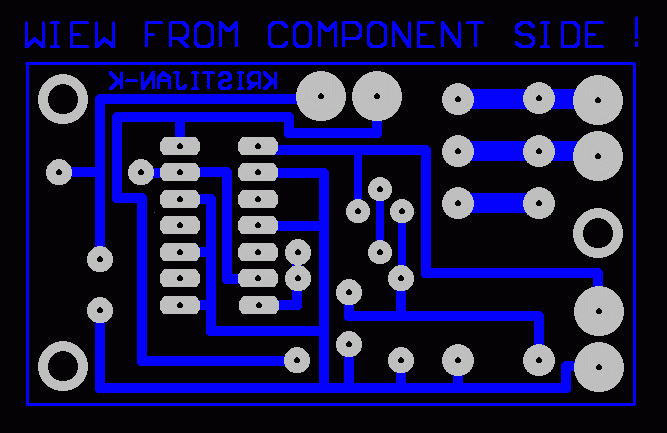

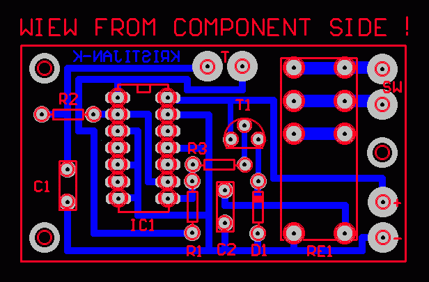

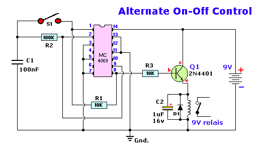

I was talking about this schematic :
http://www.diyaudio.com/forums/attachment.php?s=&postid=68693
Which acts randomly when psu is turned on.
My idea is to use this schematic for quick muting on speakers using pulse switch button.
If the relay is turned on with the psu, i can hear the transcient noise of the psu on the speakers. But if the relay stays off, I can de-mute the amp with the button (whenever I want) and that's what I'd like each time 😉
random state
Hello Johnix,
This circuit should allways be under power supply (in stand by)
to avoid random operation.
You can use any small transformer that you can get with the
reasonable seccondary voltage.
Also it is very important to use stabilided power supply (LM 7809).
Best regards,
Kristijan
